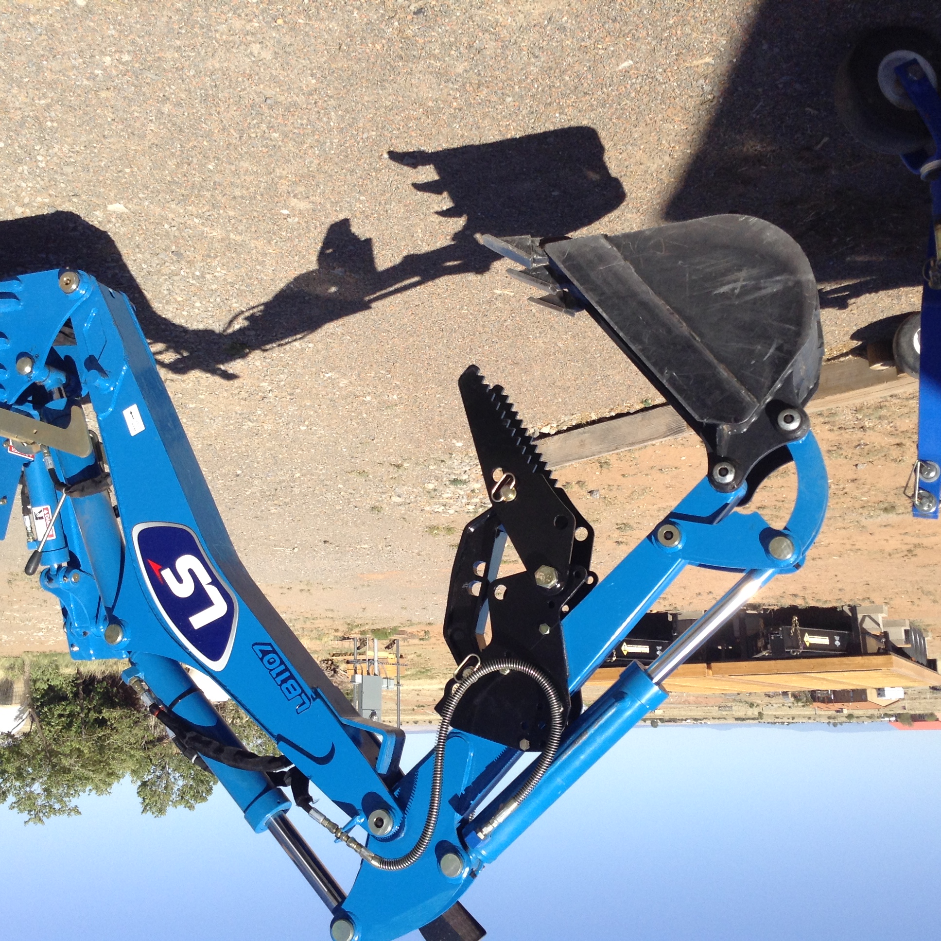

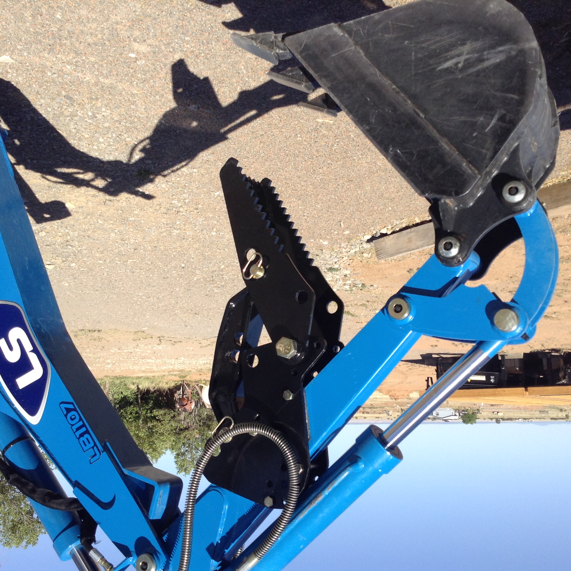

Just installed a Titan backhoe thumb. Had to cut two 1/4" thick shims to build out the dipper stick, but then it bolted right on. Can't wait to try it out this weekend.:cool2::D

Looks sharp! What do you plan to use it for? The limited swing angle seems like moving things with the backhoe would have limited use.

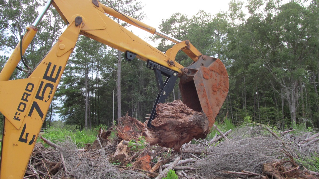

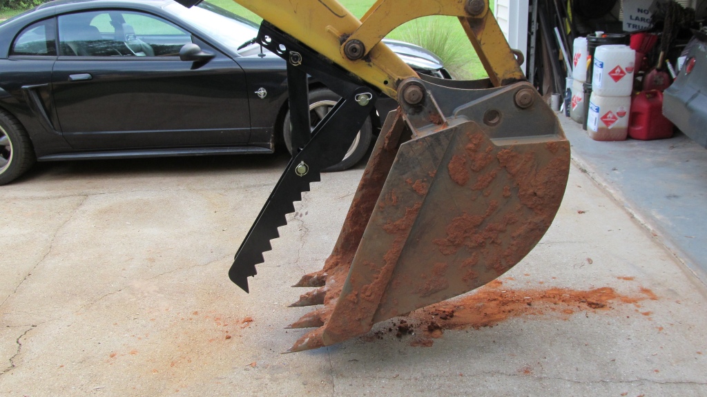

You might want to slide it closer to the bucket. I have a weld on and I set mine where the teeth intersect at 90 degrees. I have to pivot it back for stump digging.
My main purpose is to pick up brush piles and load onto a trailer. Basically reach into the pile, grab a bunch and move / put onto trailer. Some piles have been sitting for 4-5 years....rattlesnake havens...
Other use will be to pick up and move some railroad ties.
I originally had it lower, but that limited the space I had between the bucket and thumb. I set it higher up so that I could grab a 'fatter' bunch of brush. I can move the teeth forward (towards the bucket) so that just the tips meet in order to 'pinch' also. I may move it down after I play with it a bit. Do you have a pic of yours?

Careful picking up too much weight from the back end. Filling the front bucket full of dirt helps if your steering gets light.
A thumb on the front bucket would be more useful for moving piles but rigging the hydraulics seemed too much for me to do on my backhoe. I may still endeavor into that one day.
