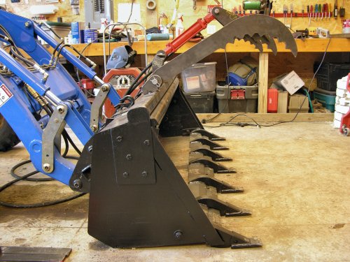

Here is a pic of a grapple I installed on my loader. I suppose it could be called a thumb. I think total cost including an ebay spool valve did not exceed $700. I can hook you up with the guy who makes these if you are interested. No financial gain is involved from this referal. I am very happy with the grapple after a year of use.

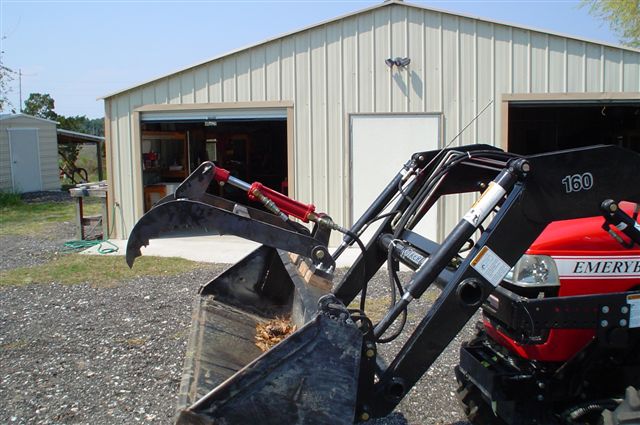

Here's another that Andy cut out.
