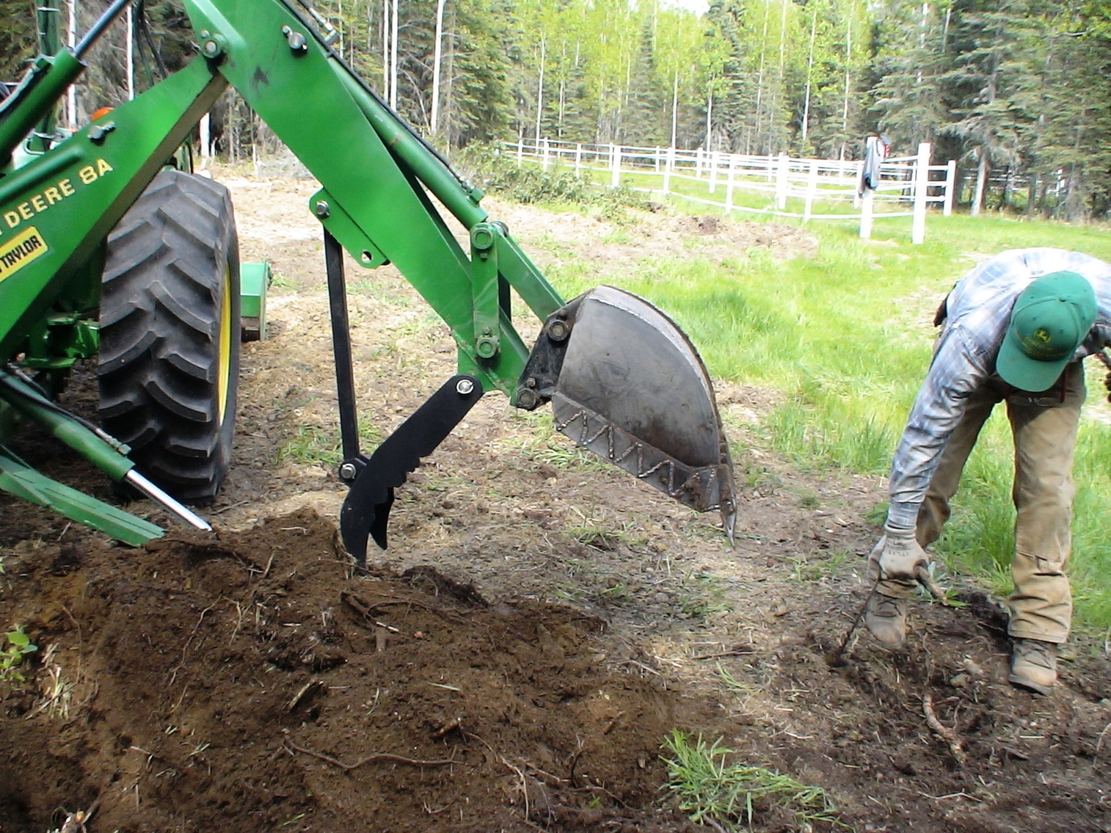

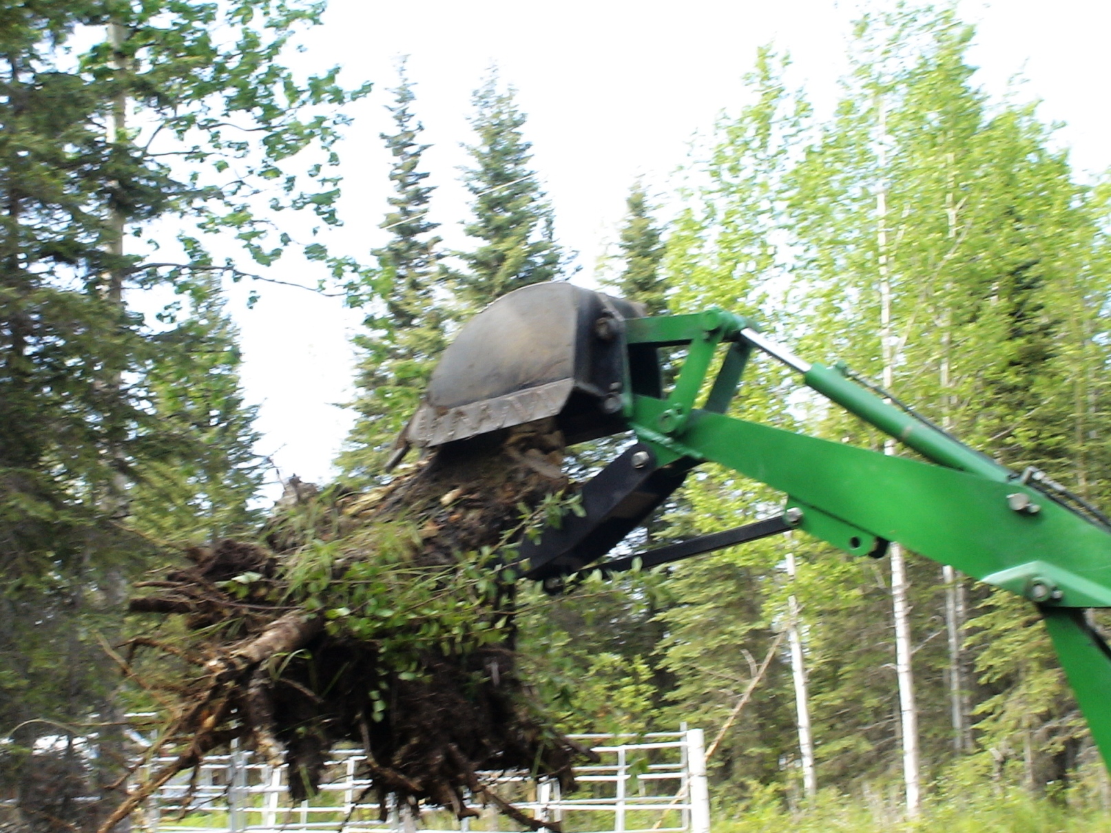

I had a self-made mechanical thumb on my JD 8A backhoe. It had two positions for the opening of the thumb - ~90 degrees and ~ 45 degrees - to the plane of the dipper. I used it for rocks and stumps. It worked very well.
Here's a couple of pictures.

You should be able to pick up rocks that are bigger than the bucket! I used to be able to do that with the 18" bucket on my old 8A. (Although, it didn't take a very big rock to make the hoe really struggle!)
If you do some research here on TBN - you'll see a number of different thumb designs with differing attachment locations. The more elaborate and sophisticted ones have a shared pivot point with the bucket. But, the more basic designs will work just fine... note - the "seat-of-the-pants" example of a thumb I built.

It doesn't sound like the materials used to build the thumb were very strong. The frame and teeth for my thumb were made using 5/8" steel plate (some 3/8" plate on the dipper) and 1/4" wall thickness square tubing.
However, the position of the thumb is always less than the arc of travel that the bucket makes when closing on the dipper stick. Therefore, you could bend or break the thumb if you're not paying close attention to the amount of force you're exerting on it while working.
The long square tube that extends from the upper mounting bracket on the dipper stick is only 1 1/2" square tubing. It's the weakest link in the thumb. It could bend or deflect if the force from the bucket is great enough (before the hydraulics stalled into relief).
In the year and a half that I used the thumb I never bent it... and I dug a whole lotta stumps with it! But... I always tried to keep the load centered between the thumb teeth to avoid twisting and attempted to keep the bucket from stalling to relief (max pressure) when closing down on whatever I was picking up.
AKfish
