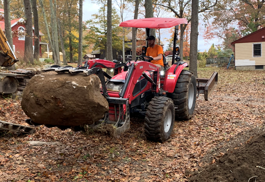

You want a grapple in my opinion. Backhoe isn't the greatest for transport even if you can hold the stone, and your bucket and jaws aren't large enough for anything irregularly shaped. Having the attachment on the loader also allows you to watch forward as you are working, which is more comfortable. Plus with a grapple you can drop the stone, roll it, pick it up again to get the profile you want when placing.
I have a mechanical thumb on my excavator, and it's a piece of cake. But, that's an excavator. I won't bother putting a thumb on my tractor backhoe, the machine isn't big enough for it to be useful in my opinion, especially since I have a grapple already. If you were to convert to hydraulic, that's even more weight that will be taken away from the already relatively modest lifting capacity.
I have an Everything Attachments compact grapple, with a single lid. For stone work, single lid will be better for you I think. I can pick up anything from the boulder in the photo, to something the size of a grapefruit, and anything in between, without getting off the seat. I think the lid opens to a little more then 3 feet.
Edit: I also have a set of log tongs I modified with angle iron to use for rocks. Those don't have the right geometry to pinch the rock tight enough, and rocks slip out all the time. They are nice at times in that they can hang off the tip of a fork, or the backhoe. If you construct a set or purchase some with longer upper arms so they pinch tighter that would be better than mine. But that said, with the grapple I have now, the tongs haven't seen use in years. But if money is an issue with getting a grapple, tongs will probably get you along good enough with minimal investment.
But if you can swing it, I would recommend you get the grapple and a third function WR Long or equivalent valve with the switch on the loader handle. Even beyond this project they are very useful.

I have a hard time imagining placing large rocks on a rock wall with a grapple. Placing an individual rock onto an open area yes, but if you're trying to place a 250# rock right next to another similar rock, it seems to me that the grapple would have to drop it at a certain point and that could be a problem.
My rocks are all almost where I want them now; I actually just need to drag them away from a work space, do more work, but then carefully place them.
So far, I think I may try some augmented tongs first (like $100-200) and then most likely rent a mini-ex ($350-400 for a day here) for careful placement.

My excavator is better, and has stronger bite, but I have built walls with my grapple. With stones much heavier than 250 pounds at times. You bite it with the corner, set it in place, then release. A wider double lid grapple would be worse than my narrow single lid for that particular purpose.
But if you don't have regular use for a grapple (would shock me for anyone that owns a tractor, but who knows), then rental of a mini x would make sense for you. Certainly if your only purpose is building walls a mini x is going to be a better tool.
