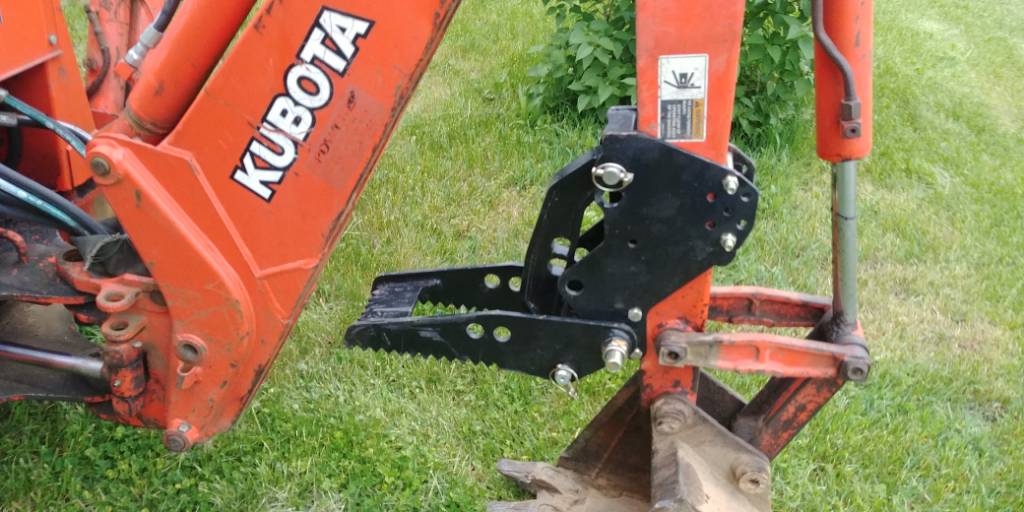

John, can you post a few pictures of it...?

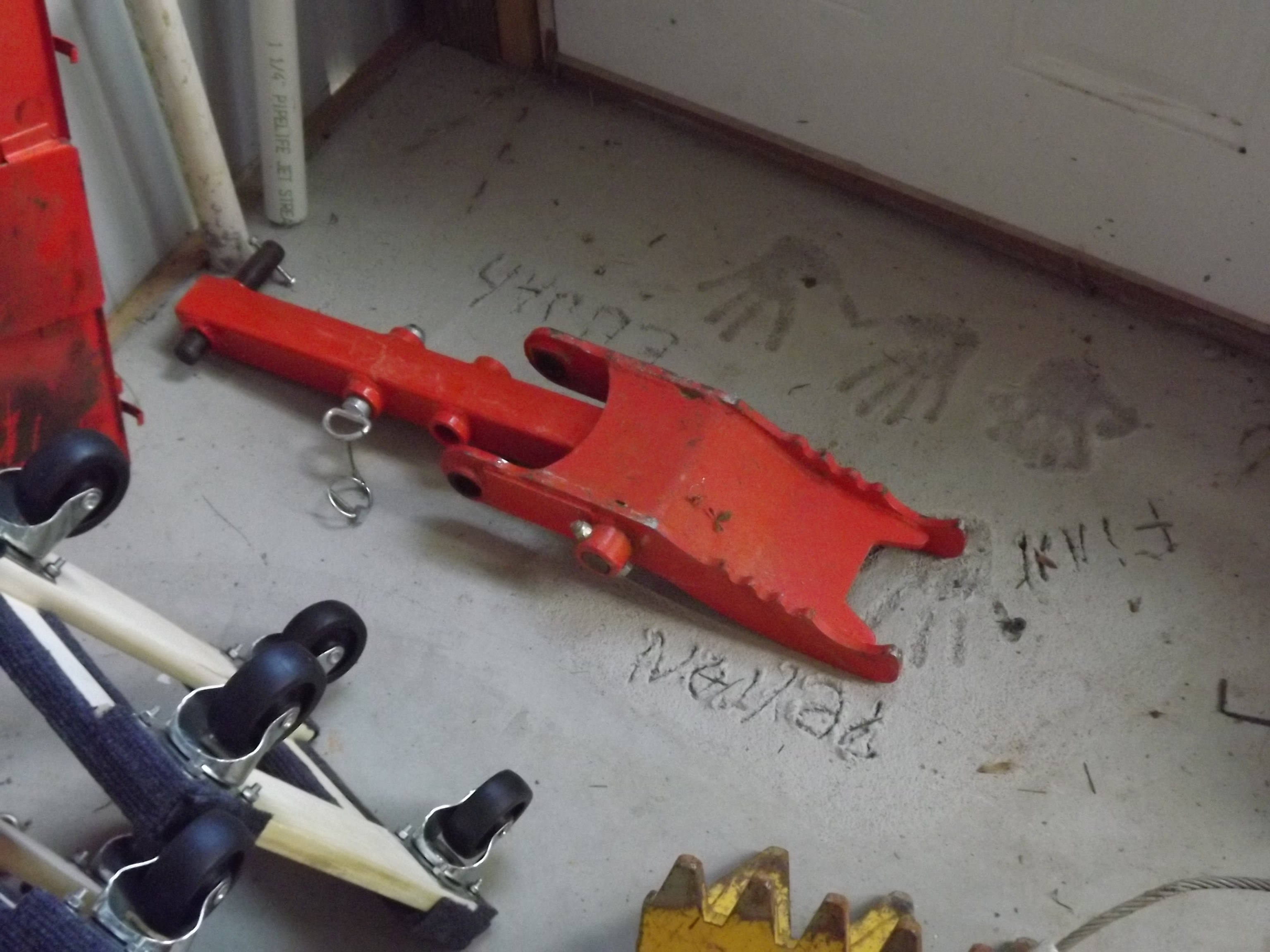

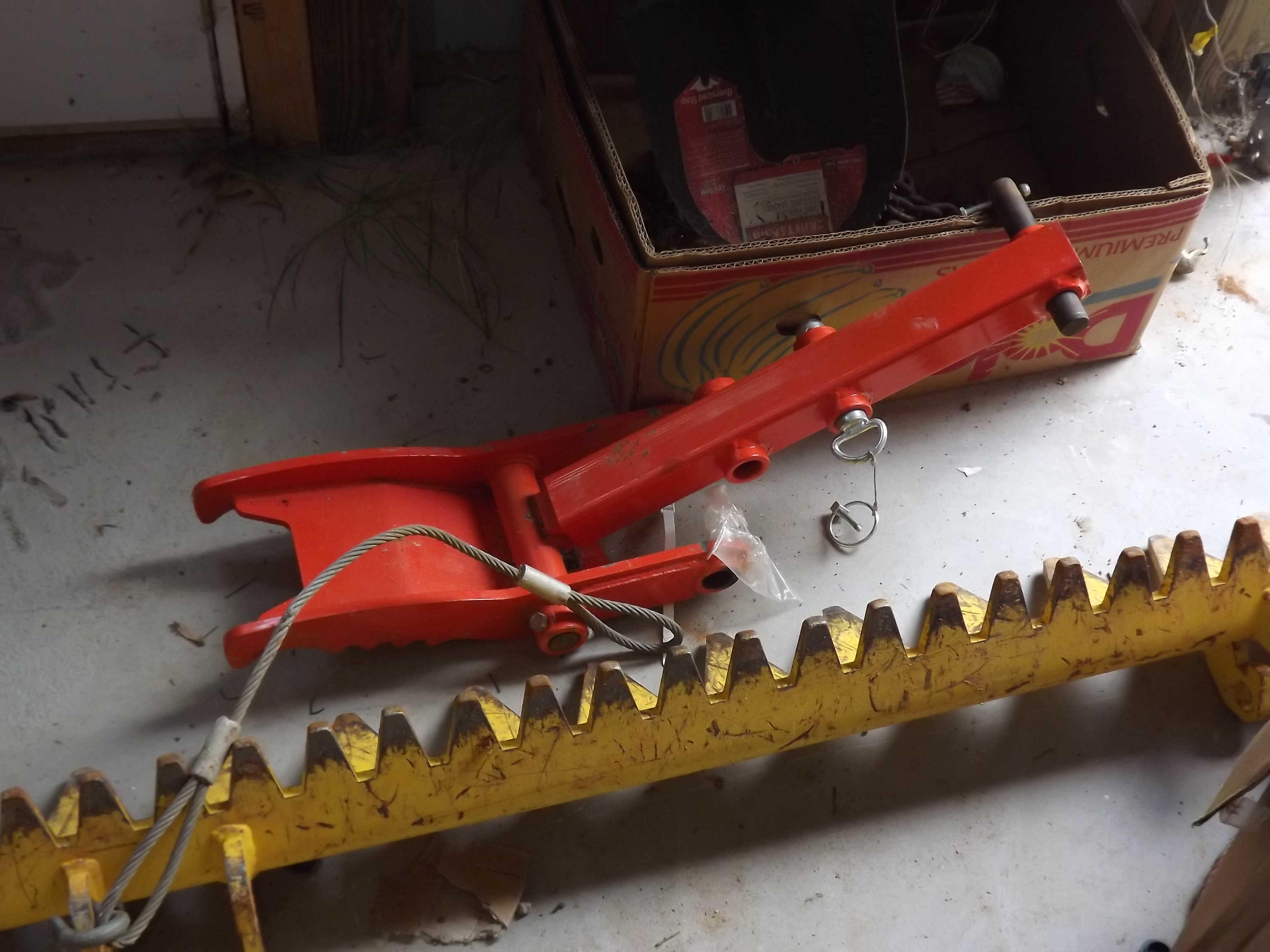

Here you go. It's a Kubota OEM thumb off a new BX25 and I never used it but one time to see how it worked. It has everything needed for easy owner install. Knock one pin out of bucket, install thumb with attached pin and the pin from the bucket, and it's installed and ready to use your back hoe to pick up rocks, limbs and people if you want. Lifts up against the BH arm out of the way when you want it out of the way. Only way it could be easier is with a hyd thumb for another $1000 or so. :D

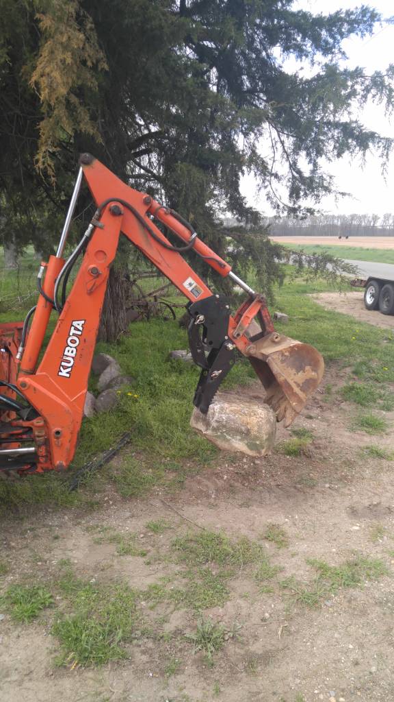

B21 backhoe thumb paid $185.25 including shipping20170521_201146.jpg20170426_143527.jpg
