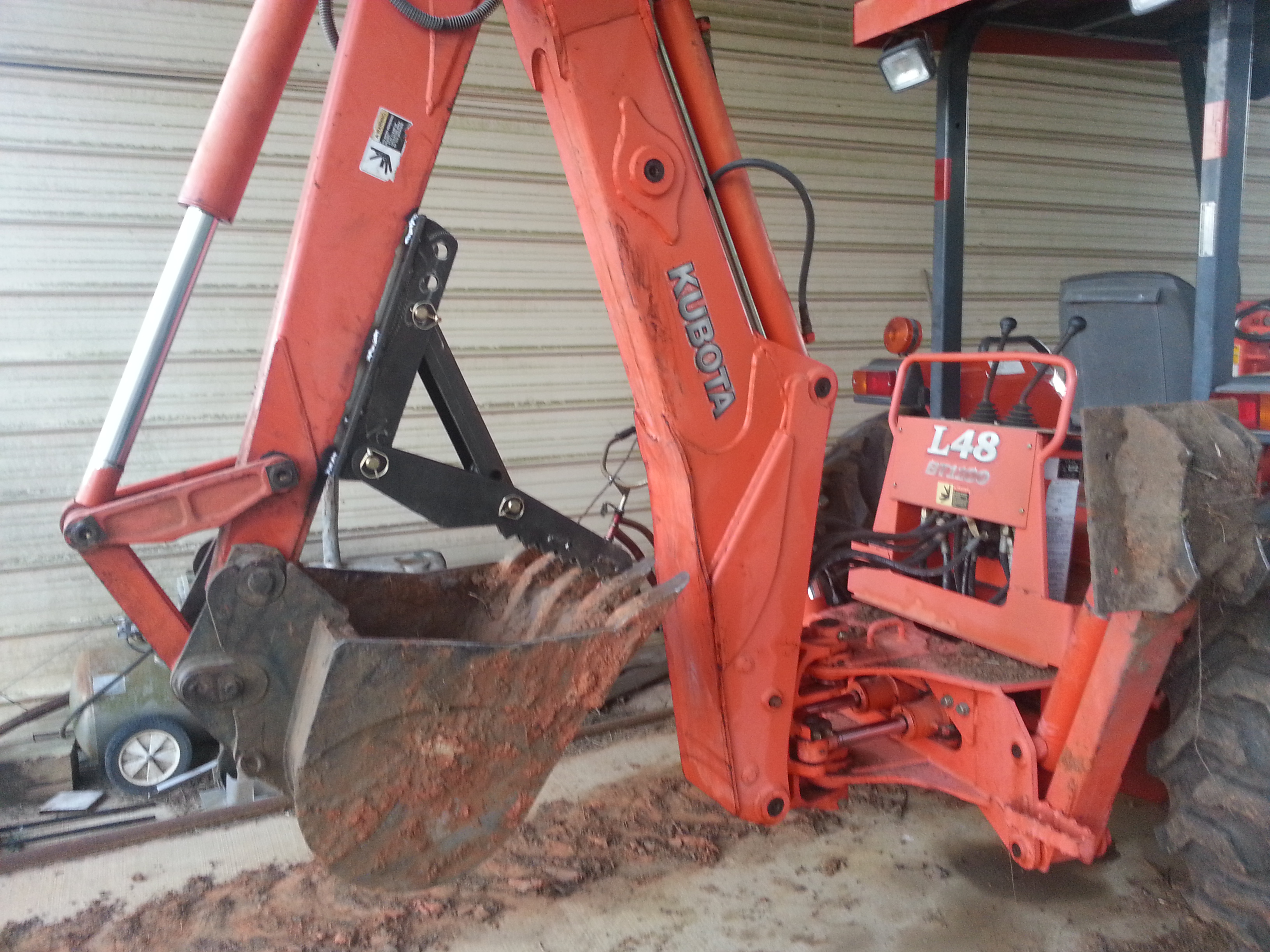

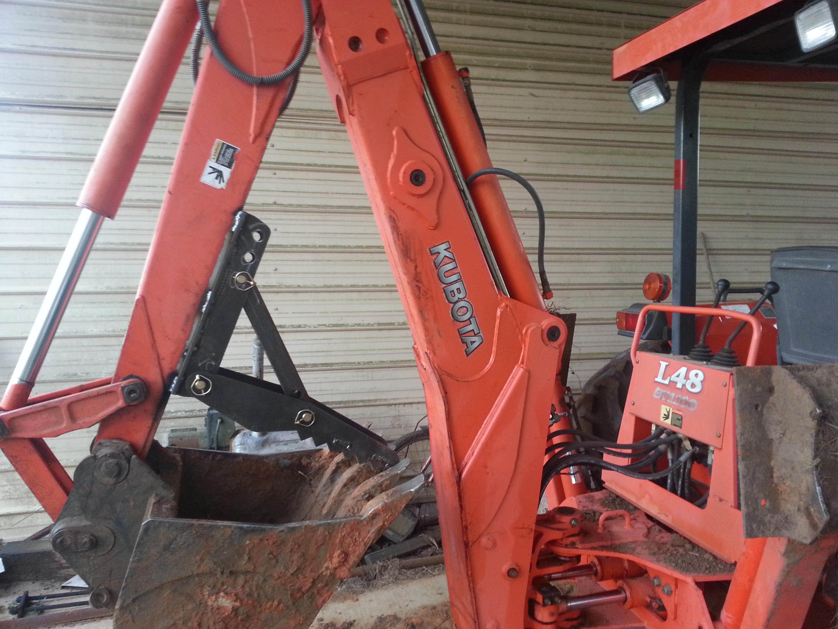

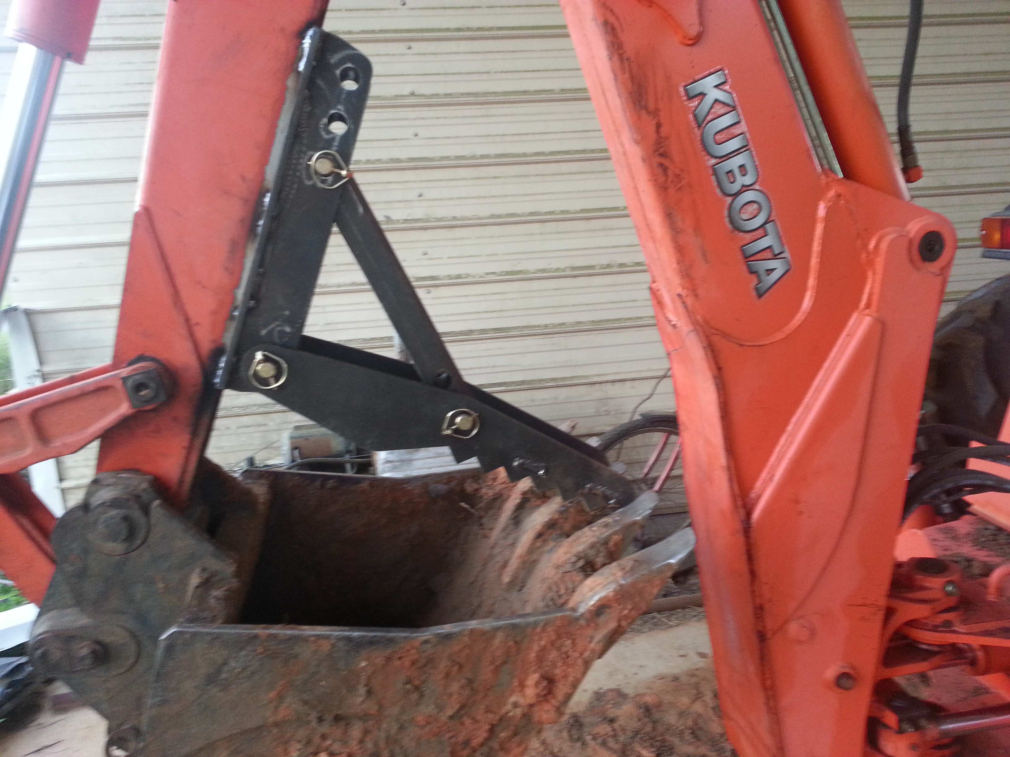

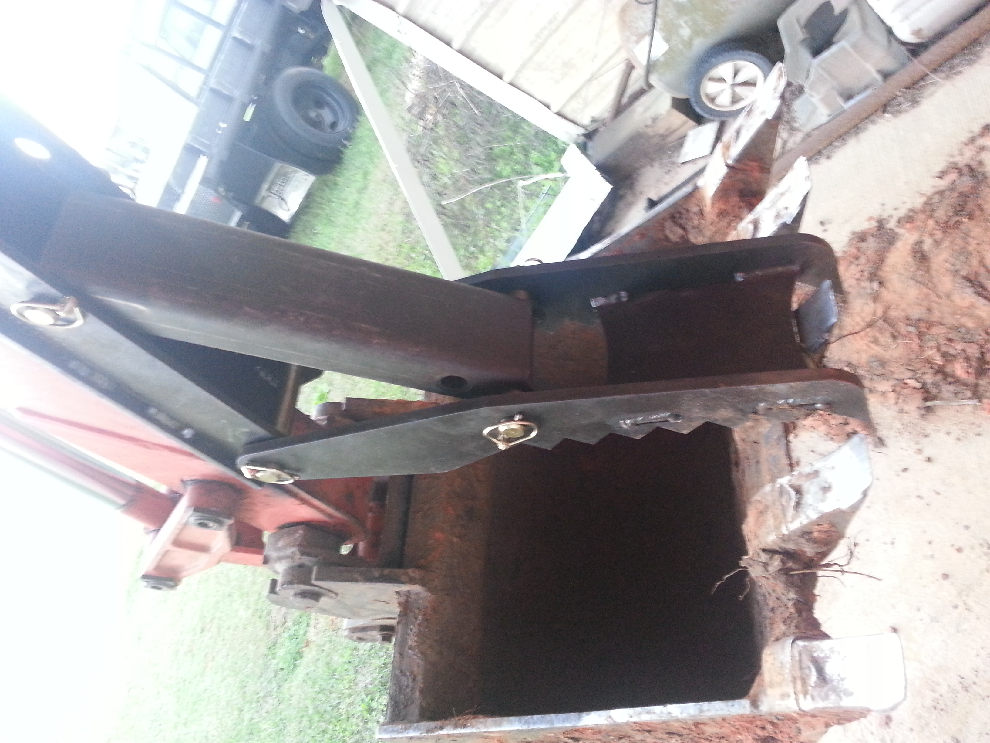

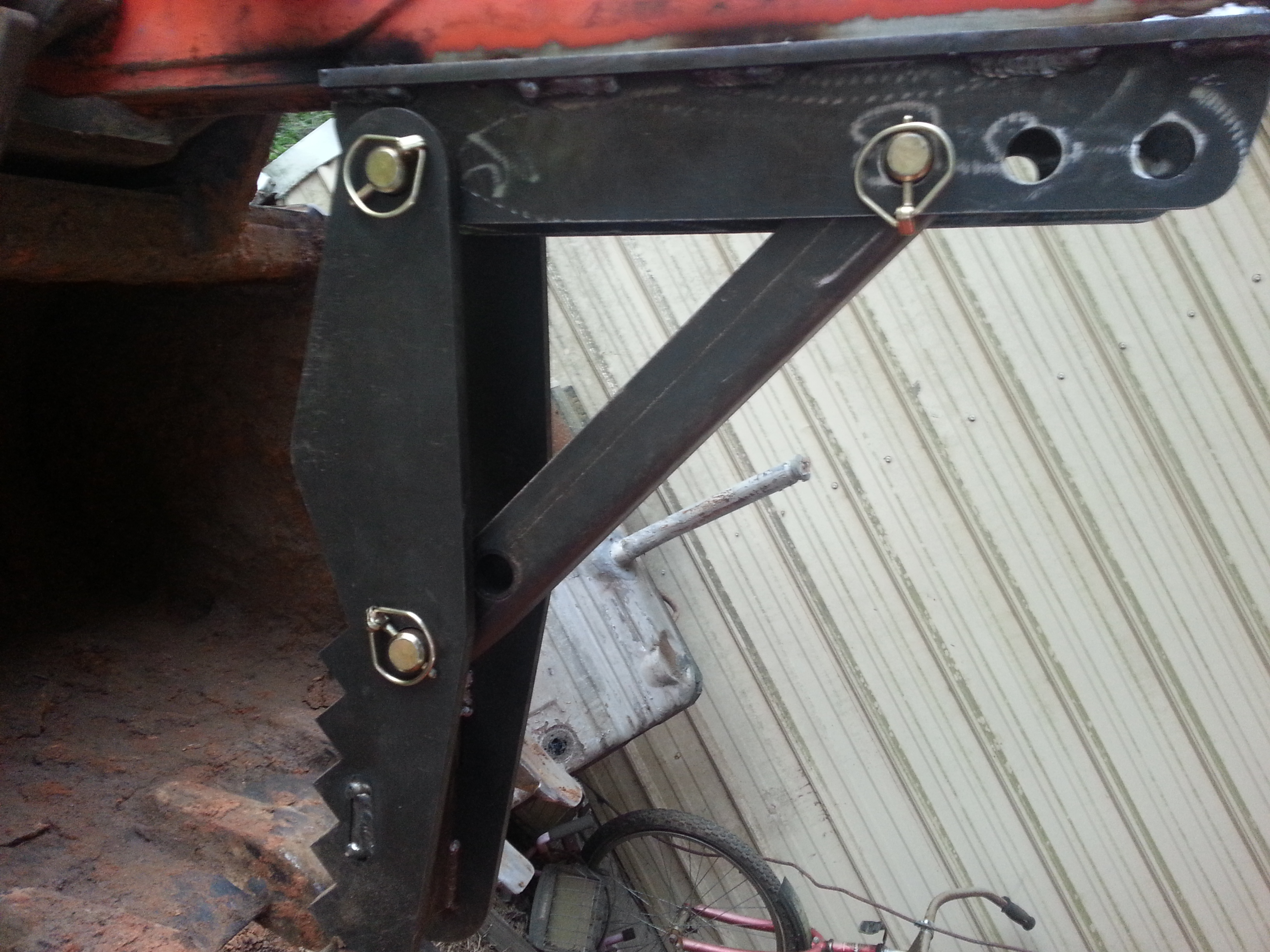

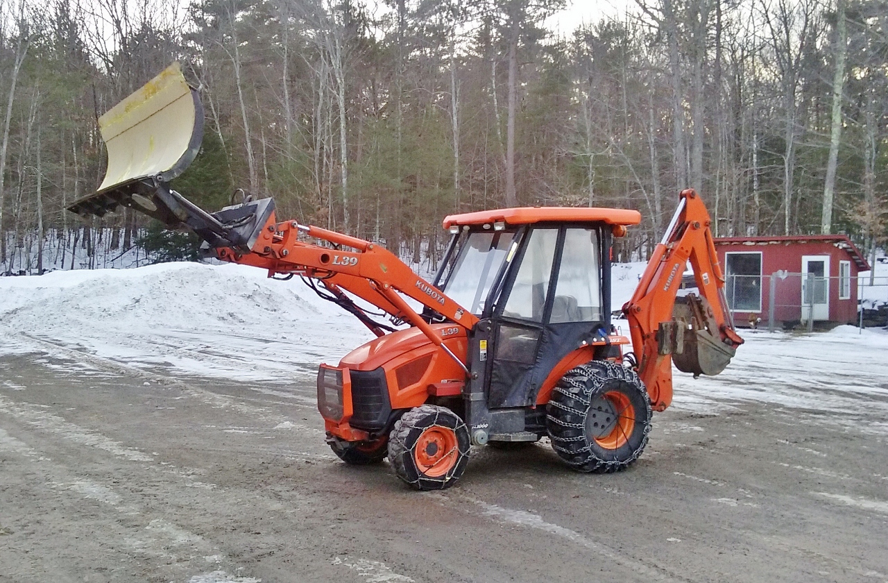

I have just installed it tonight, this is the 24 inch DIY thumb Kit from titan attachments. $135
Its heavy and pretty well made, one of the teeth arms had a twist in it. I assembled the pieces and straighten them up using 6 inch C clamps prior to welding. after welding there is a very minor twist, you will never notice it. I feel the twist came when they cut the pieces out, I did have to use a hammer to make every thing fit, but no grinding was required, after welding all pins slide in and out easily with no binding.
Over all nice product.
Now My L48 hoe bucket would curl about 10 inches from touching the dipper, so using a thumb means you loose 25% of the full curl, as you can see below i choose to move the thumb up the dipper, since there were no instructions, I guess it is up to me, as to were I mounted it. It may be too high, it may be to low, I really dont know. I choose this spot because it allows me to pinch logs and thing with out digging with the bucket (scoop from behind) or plow the thumb into the dirt to grasp things.
After I attached it, I had to test, I grabbed some debris and literally crushed it, then and picked up some 12 foot sections of pine tree I fell last week. The thumb is sharp and holds very well. Over all I am very pleased, it will require removing the thumb for any real digging jobs, part of it folds back and pins out of the way but not all of it.
In the photos this is about 75% of how far I could curl the bucket when the thumb is removed. It does NOT hit the boom when the dipper is completely retracted. If I where to raise it up any it would, and If I lowered any I would loose more of the bucket sweep.
Let me know if I have it to high or low, I really just guess at the placement.
MrC.
