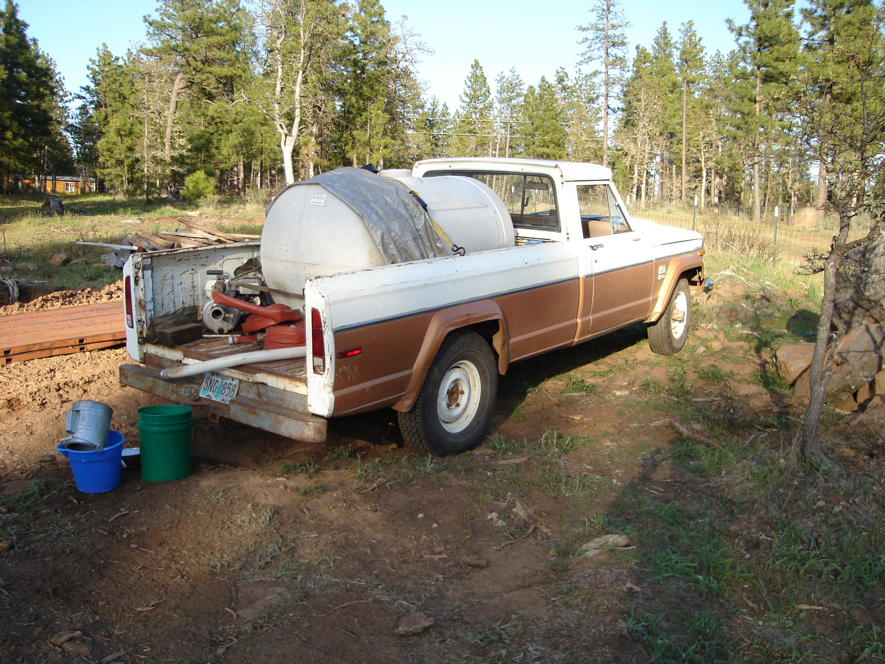

I would prefer a dedicated old pick-up to hold your tank, and pump set up. But with your options I would go with the tank on a trailer. and have your tractor hooked to it ready to move. At least 1 300 gal tote.
The problems I see is that I dont think trash pumps are designed to develop much pressure, unlike a 5hp Honda High Pressure "fire pump".
Also your 2" discharge line is going to be a bear to handle when full of water. The fire men on my land last summer were using 1" while I was killing myself dragging around 1-1/2" line.

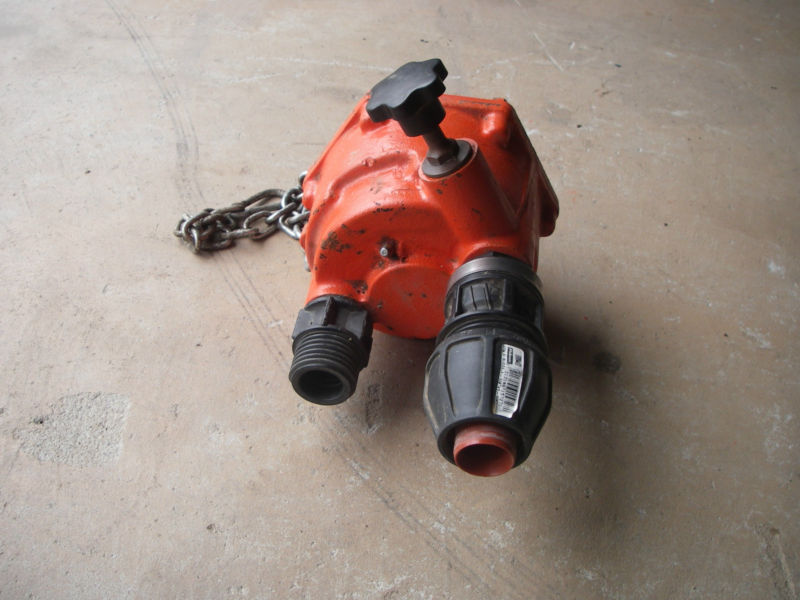

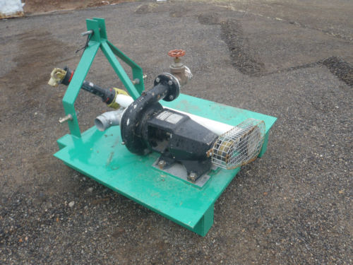

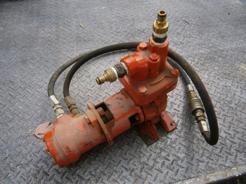

As volunteer Rural Fire Fighter for more years than I care to recall, controlling bush/grass fires is all about preparation/planning so everyone knows their task & risk, keeping a level head under pressure & fast mobility. Bush/Grass fires move extremely quickly so having high presure water on demand & multlple water sources located close by are more critical than any single bulk water source as any hoses can only reach so far & if you're forced to retreat to refill without any other effective defense remaining at the fireground it's game over because you've now going backwards.........you may be able to adequately defend a house from a bush fire front with timely well placed use of a c.200gals + foam additives static source, but chasing a bush/grass fire across open ground is a totally different ball game...
Attached are photo's which may be of interest, these are some of the smaller high pressure pump set ups we use on the farms (supplementary to the self powered fire pumps) shaft driven PTO , direct PTO mount & Hydraulic (these last two are small high pressure spray rig pumps which with foam injected at the nozzle make for excellent fire suppression) :--

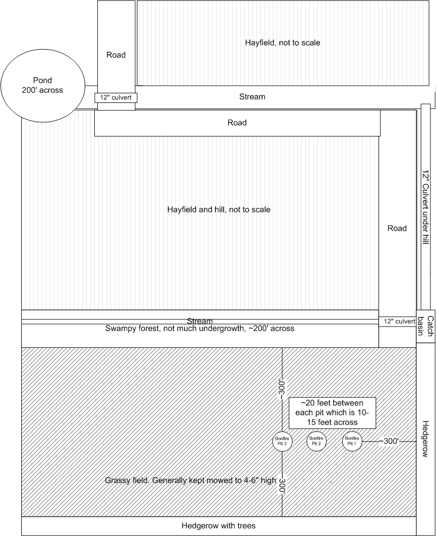

Thanks for the ideas all, attached is a layout of how the place is laid out, we already keep the field around the burn pits mowed to 4-6" tall. Will look at the various options on water rigs and report back.
Aaron Z
