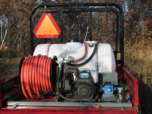

Up here, the US Fish & Wildlife Service fire program uses Polaris Ranger 6x6 UTV's with a tank, Honda WX15 pump and small hose on a reel.
Here is a similar unit that is used by a nature conservancy in Wisconsin for holding their fire breaks on prescribed burns.
If you cannot extinguish a spot fire with the Workman, 60 gallon plastic tank, pump and 100' of 3/4" Ag hose with garden hose nozzle, you need to have the Fire Department out there, anyway.

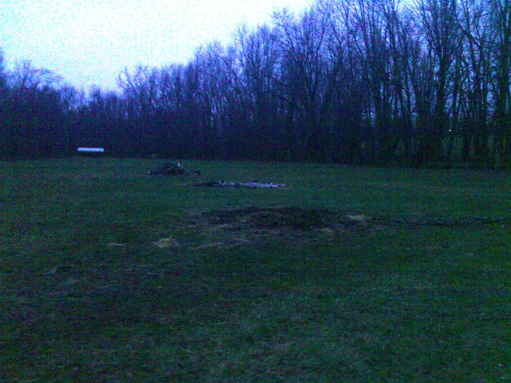

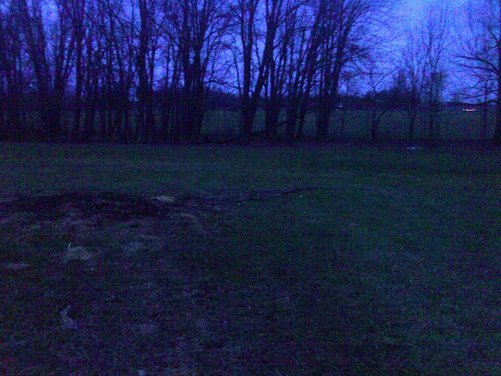

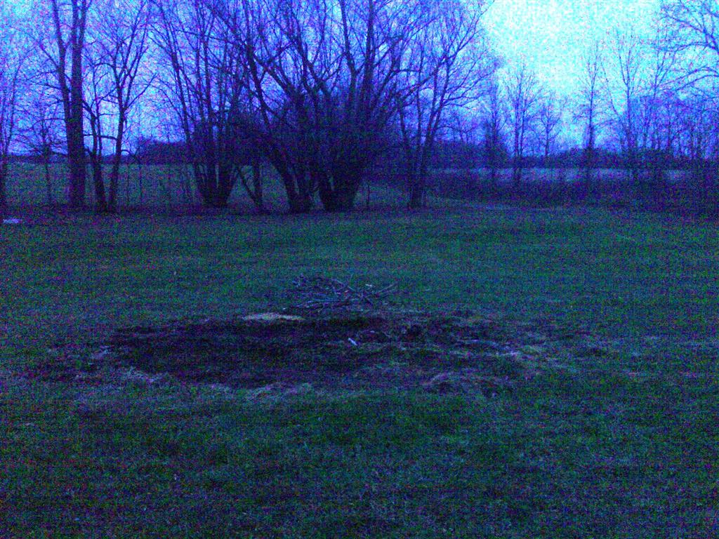

Got a couple of pictures at dusk tonight:
Current water machine:
Pictures of the firepits, the woods and the stream:
Sorry for the picture quality, my phone camera didnt like the lack of light.
