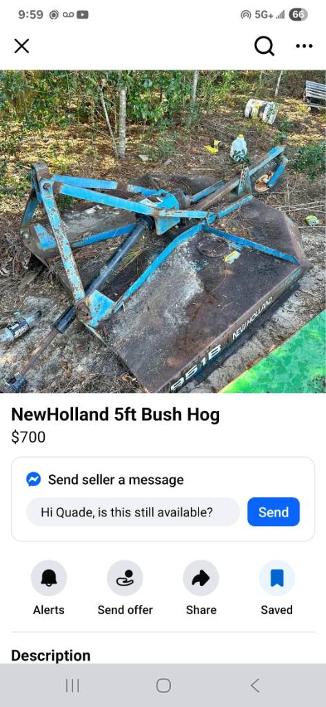

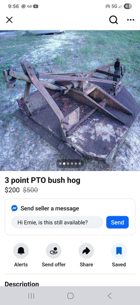

I did see this one; unknown brand, unknown model; unknown quality, for $200 about 10 miles away. As another thought, I could just beat the he'll out if a $200 cutter and throw it away when done. Or alternatively, use the 4ft NH one on the nasty crap, until it explodes and use a 5 ft cheap one afterwards. I think im going to try to go check this one out Saturday.

#34
There is also this one, which looks in whose shape, but heavier built, like 5 miles the opposite direction

#35
This one is about 1h30m away, and more money, but im considering it. because its a know brand, that is honestly, pretty good; or atleast used to be. Ford/New Holland did use to make pretty good stuff.
