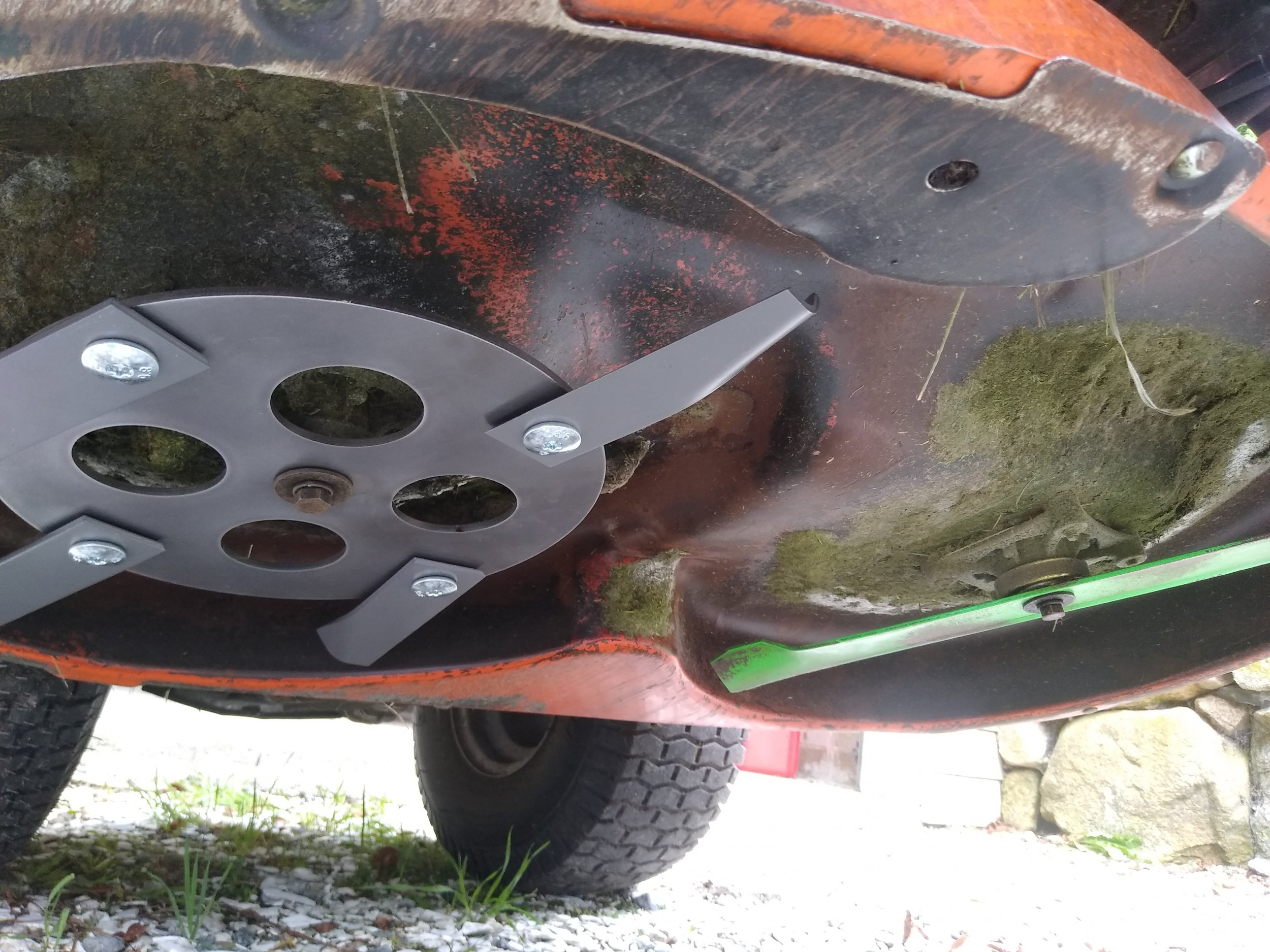

Installation was simple -- lift the mower, take off the old blade with an impact wrench, put on the Meg-Mo. Here's one old blade and one Meg-Mo:
My mower is basic, it's a Husqvarna 42" lawn tractor. It has star-shaped spindles. The Meg-Mo was custom made but does not have star-shaped openings, instead it's a circle that fits over it. Part of me worries that it won't stay attached, but part of me recognizes that the star is a weak point on the spindle, it's made of soft metal and when it deforms the whole spindle has to be replaced. Time will tell.
I put the new blade on with an impact wrench. The disc is about 1/4" steel and it's pretty hefty, about 50% thicker than the blade it replaced. With the thickness of the disc and the fact that the swing blades hang down the cutting edge sits about 3/8" lower than before. I always mow in the highest position and often wish I could mow higher so we'll see if that's an issue.
One thing that was a little disappointing is that the blades don't swing 360 degrees, because of the wings they can only swing about 60 degrees from their cutting position.

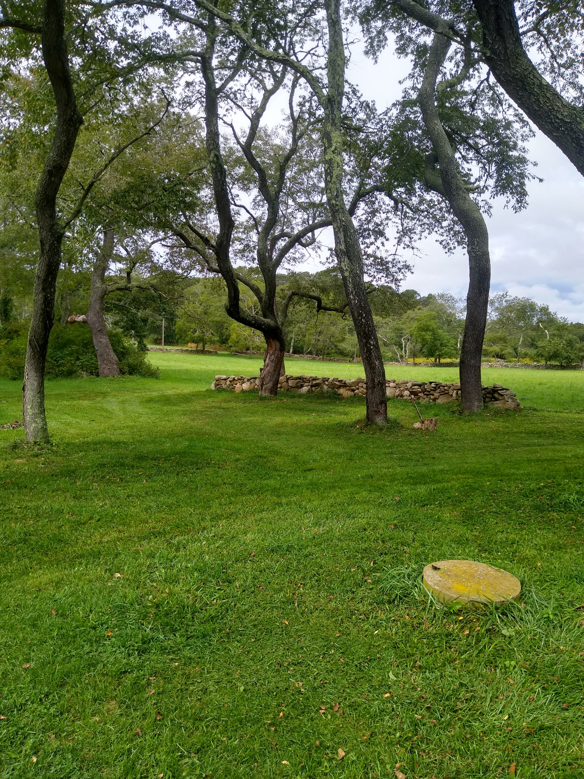

Test #2: This was easier, this is a patch of grass my son had been mowing all summer until he left for school three weeks ago. So about three weeks worth of growth, maybe 9" tall:

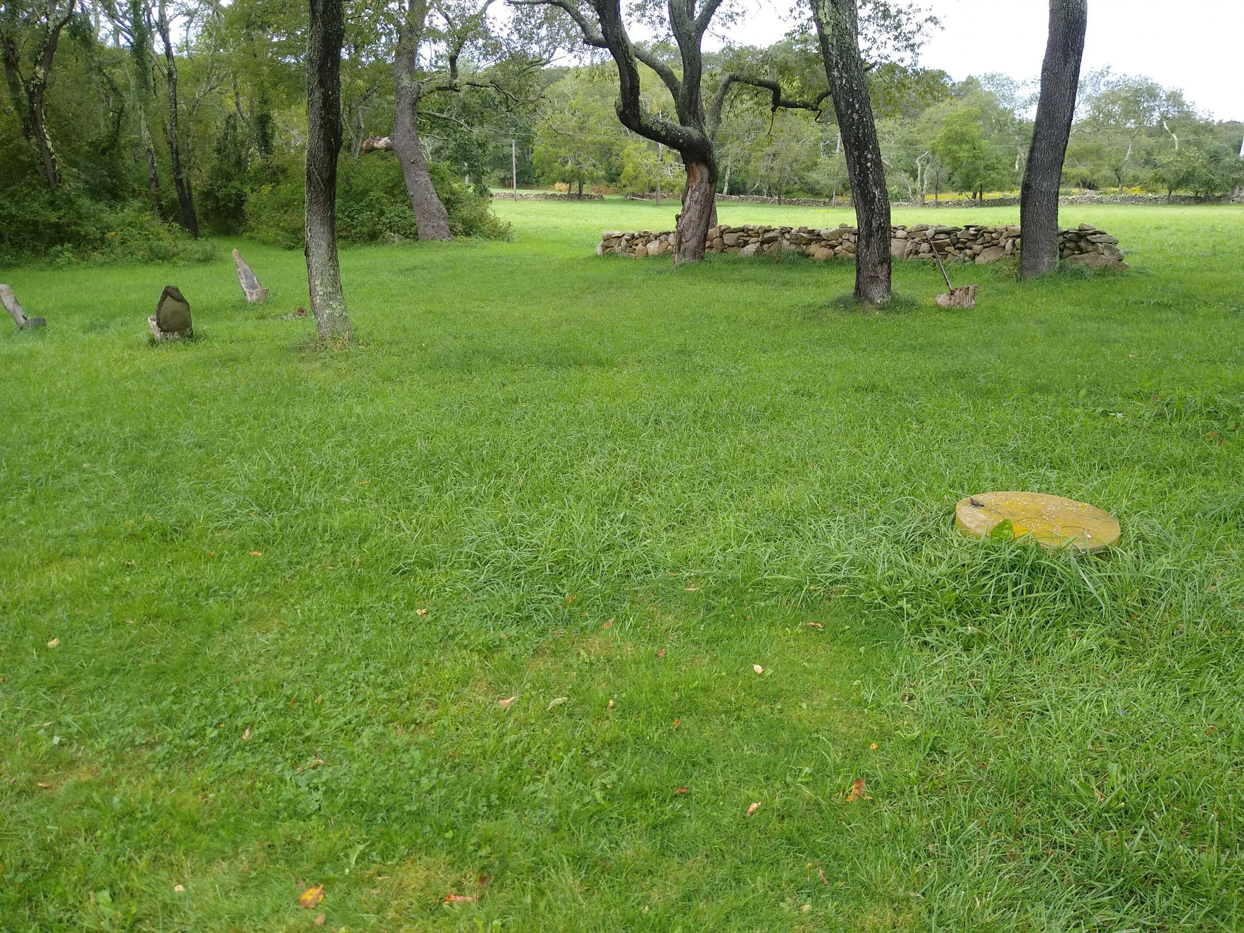

Here's the after picture:
Looks like a lawn. It gives a nice cut, clippings are mulched. If anything it's a little shorter than I like. The mower is noticeably quieter than the old blades. When you first engage the mower it takes a second to come up to speed but after that it doesn't feel like it's straining.

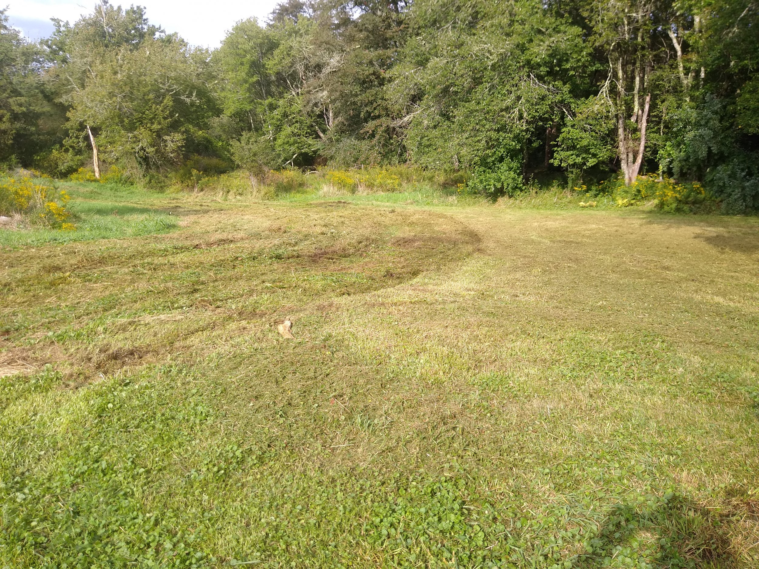

Test #3. This is the side of a hillside. This is the only spot that hasn't been mowed at least once this season, because I broke my rough mower on a hidden rock in here a few weeks ago. So it's tough grass plus some tall deciduous weeds:
Once again I did the rough mower and the Meg-Mo side by side. Rough mower is on the left in the after picture:
The Meg-Mo really kicked ass in this section. Note also the muddiness in the rough mower section. We had heavy rain last night, the ground was still wet, and the tractor and the rough mower really chewed things up, the lawn tractor was much gentler.
There was one point going up the hill where the lawn tractor didn't have enough traction to push through the tall grass and I had to back up, go around and get it from above. But there was also a spot where the tractor lost traction pulling the rough mower!

You may notice there was something on the ground in the last picture. I tried to upload a picture but TBN is getting cranky. Anyway, it's a stick, a big mower-breaking stick. I ran it over with the Meg-Mo and didn't even know it was there until I went back to take the picture.
