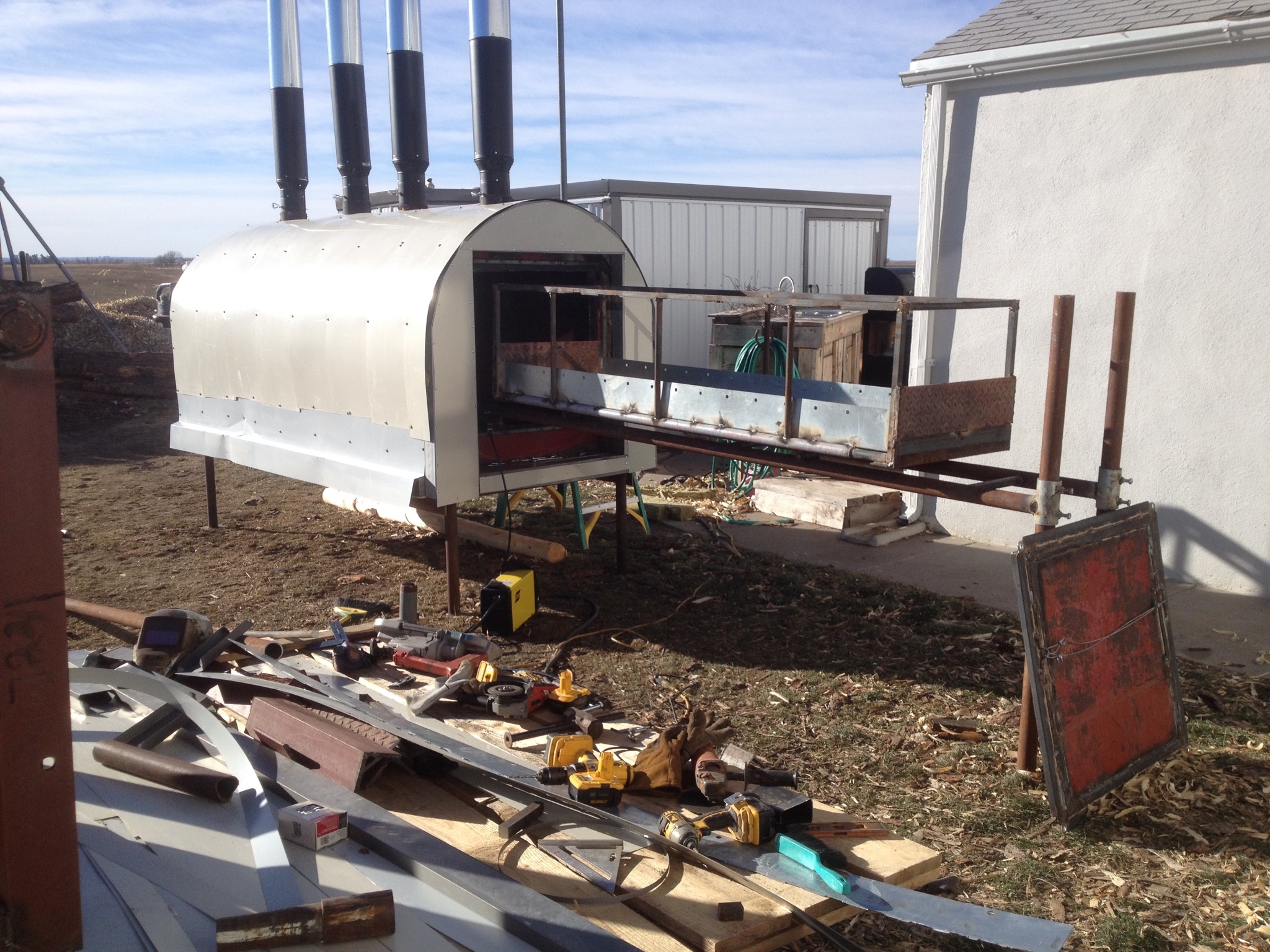

Fall is coming and there's no better time to build a mega PTO powered incinerator to save myself a lot of pain and suffering.
Here's the idea -
48" high pitch 700rpm fan attached to the PTO via shaft and chain drive.
Wide swath vacuum collector at 72"x4".
Snail shell collector with top exhaust to keep unburnt bits low in the can.
Possible propane injection.
Now for the problems -
At zero static pressure the CFM of the fan is 43,400. The fan has a face of 1080ish square inches which makes its exhaust 51mph. For the intake if the 72"x4" is used, the intake velocity would be 190mph assuming the 43,400cfm remains constant. However, since that opening is 360 sq.in. the static pressure would be greatly increased for the fan. The problem then is the actual intake speed bottoming out and if there would be enough left to vacuum leaves, twigs and possibly grass clumps and force them into the burn chamber. To note the pitch of the fan is 38 degrees and it requires 8.5hp to turn it at 700rpm.

I play around building stuff like this making biochar. Here is a kiln I built,Fed with a leaf blower. When it gets hot it only takes a small amount of air to keep hot, like less than 10% of the leaf blower flow.

KISS is the goal, but the problem with low air flow is that it won't vacuum up the debris from the lawn. A simple incinerator would be perfect, but I'm trying to combine it with the lawn vacuum. The other idea is that it will save thousands over just a massive leaf sucker.
