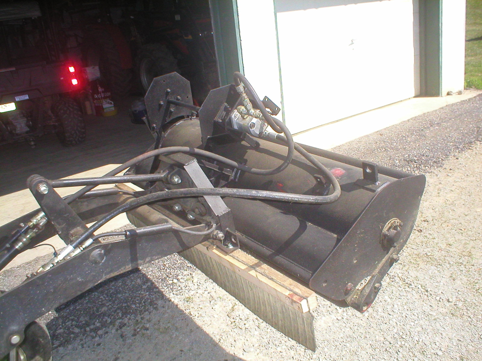

The 425 punches well above its weight on most fronts... But the fh-d160 is both to heavy 900#, and too demanding of power, 30+hp, .
I think the other posts get it right that 4' is about the max flail a 425 can wield. Track width would be better, if heavy grass is on the menu.

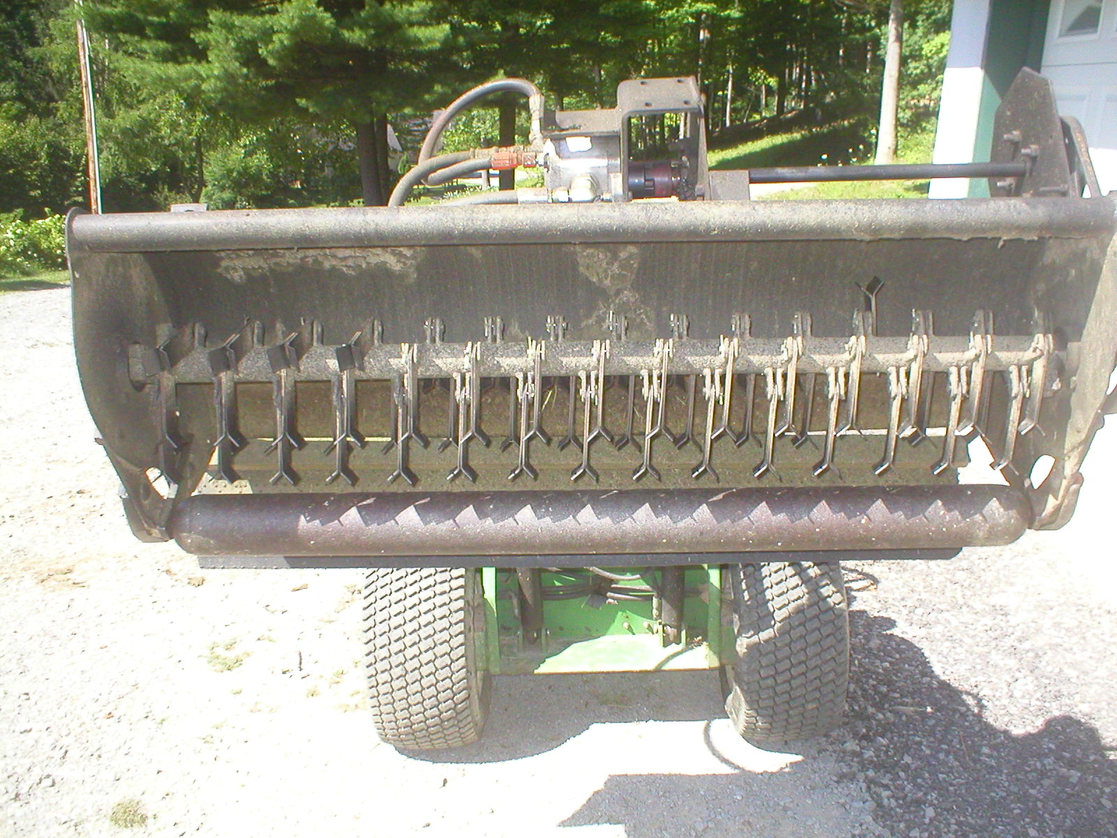

Here are some pictures of my flail mower. I have had it for 3 plus years and probably have not used it over 10 hours total. It cuts ok but I like the convential mower . The person I got it from , it was his fathers who passed away who had purchased it and adapted it to his power trac 425. P7300005.JPGP7300004.JPGP7300003.JPGP7300002.JPGP7300001.JPG
