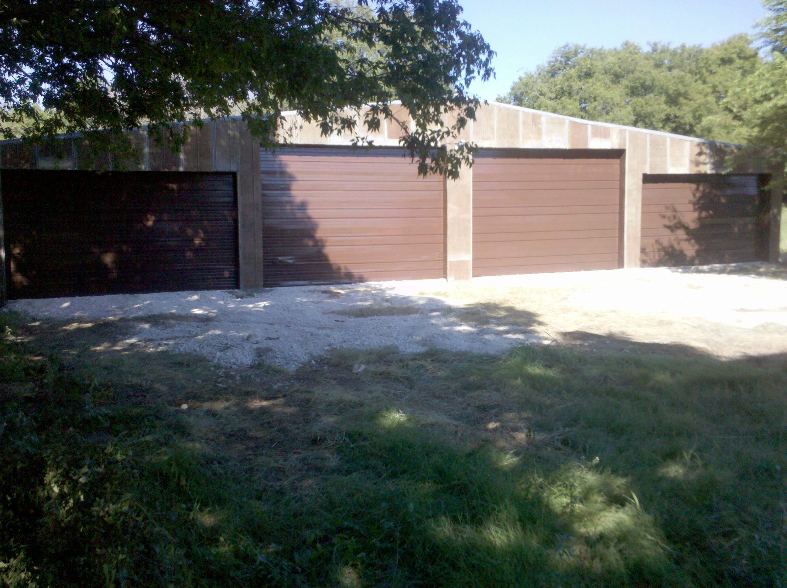

I significantly upgraded our 20 yr old pole barn last year. It had been open on all sides, but I wanted to store a lot of stuff in there and not have it get stolen, as its near a county road. But still wanted to keep the old rustic look common on the house and barns that are there (most circa 1930s). Framed the old walls and added old tin, along with four big roll up doors. Pretty good set up, and looks cool too.
