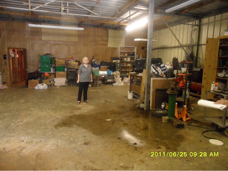

I've a similar situation in a shed I recently bought in NE Mississippi.
Building about 40x60, all metal, unheated (no need in Ms.) rains for a while on mornings when it was below freezing and whatever moisture which condensed on the roof comes down, as the sun warms the roof.
I've had recommendations of insulating the roof (coffee cup analogy).
My question is - what would be the best way? DIY kits run around $1/sq ft for an inch thick. Should I just cut up styrofoam cups from along the interstate and glue them to the ceiling? If professional install is $1/sq ft where should I go for bids?
Picture is prior to purchase, and yes the roof leaks slightly and I'm getting it fixed.

   / Metal building condensation (help please)! #88
EE_Bota said:
I did a Google search (without quotes) of "condensation in metal buildings."
This site
Controlling condensation in metal buildings
and
This site
Design & Build With Metal: Understanding Condensation In Metal Buildings
The first site is using comparison to pregnancy. He also used an example using a soda can in front of an air conditioned vent as an example of ventilation. I don't think a/c is an option for the OP. Blow unconditioned air over the same can and more condensation would occur. Again this is what my home dehumidifier does, blows air over cold metal. The goal here is to keep the warm air away from the cold metal. I consider that example not feasible.
The second site describes ventilation similar to what I mentioned. You need to ventilate the section between the insulation and metal. To do this you would need an attic space. Your goal in an attic is to keep the temp in the attic similar to the outside. I doubt an attic is an option for the OP. Ventilation I think is still not the best answer for this particular instance unless there is a source of moisture inside his building like livestock or he is making moonshine.
Basically he needs to separate the air from the metal. Simple but somewhat expensive. I have the fiberglass wrapped in plastic and it is only about an inch thick on my ceiling and I get no condensation. The plastic conforms to the contour of the metal and the seams are overlapped and sealed. A ridged insulation would have to be sealed at the seams very well to prevent any air to get through. Maybe the OP just needs to tape up the seams.
Jeff

   / Metal building condensation (help please)! #90
Yeah bota, i was just poking fun at the first weblink. As far as the moving air warming the metal faster, I agree on metal items within the barn like tractors and tools but not on the roof. I gave the example earlier that you are going to need a lot of heat on the roof to counter the cold air mother nature is continuously supplying on the outside of the metal. I mentioned having to heat the whole county. A thermal and vapor barrier is what is needed for condensation on the roof. Ventilate if there is an interior source of moisture.
Hopefully you understand I am with you on trying to help with this problem.
Jeff
