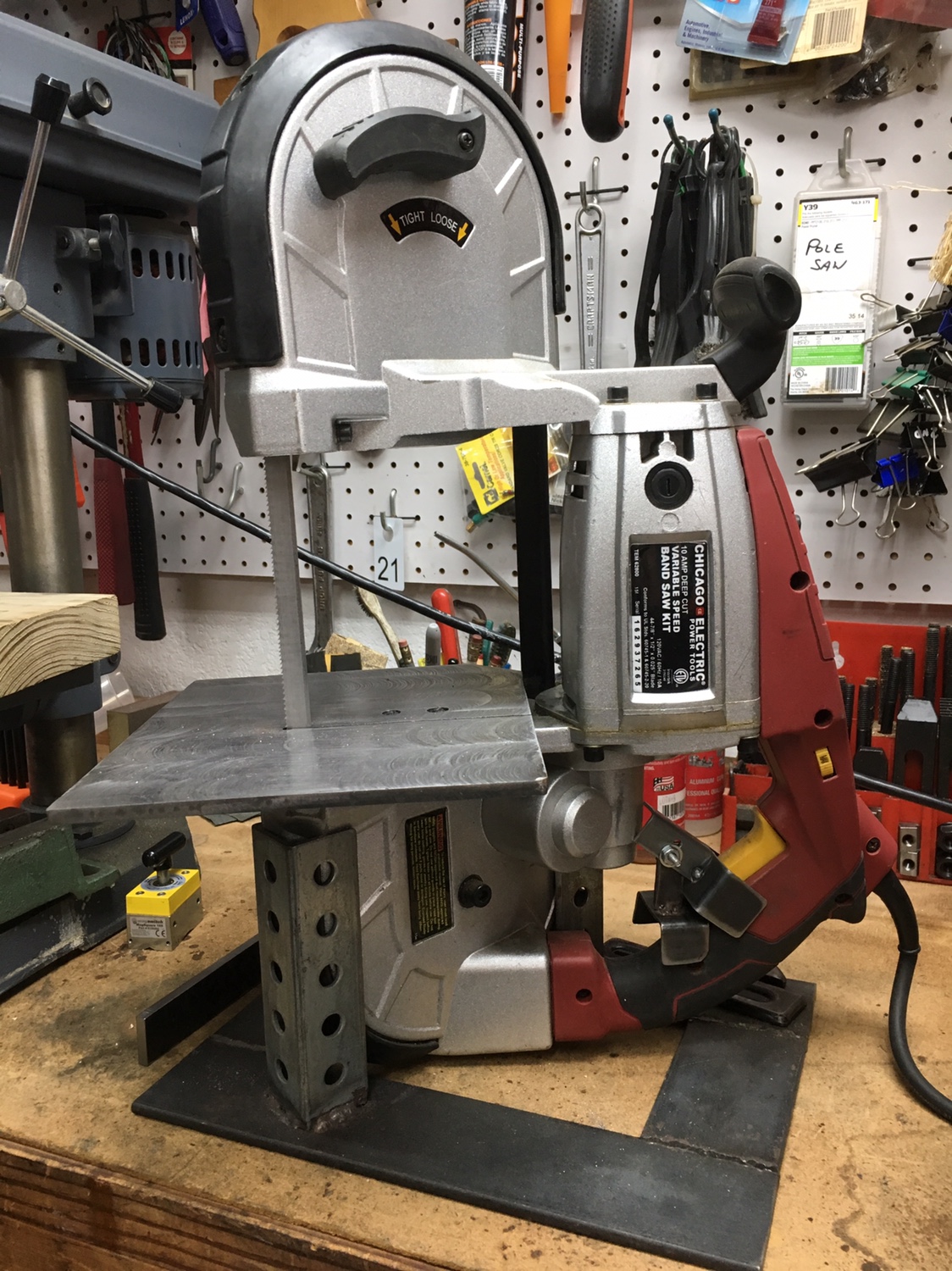

+1 on the deep cut porta-band. Have most of the required metal cutting tools. Stationary band, abrasive chop, 12 inch shear, electric and air shears, angle grinders, plasma and the deep cut porta-band. Next to the plasma, the porta-band is among the most versatile. Had the Chicago electric version, worked well untill some heavy cutting, then it let out a bunch of the magic Chinese smoke, upgraded to a Milwaukee model. Still made offshore, but with better QC.

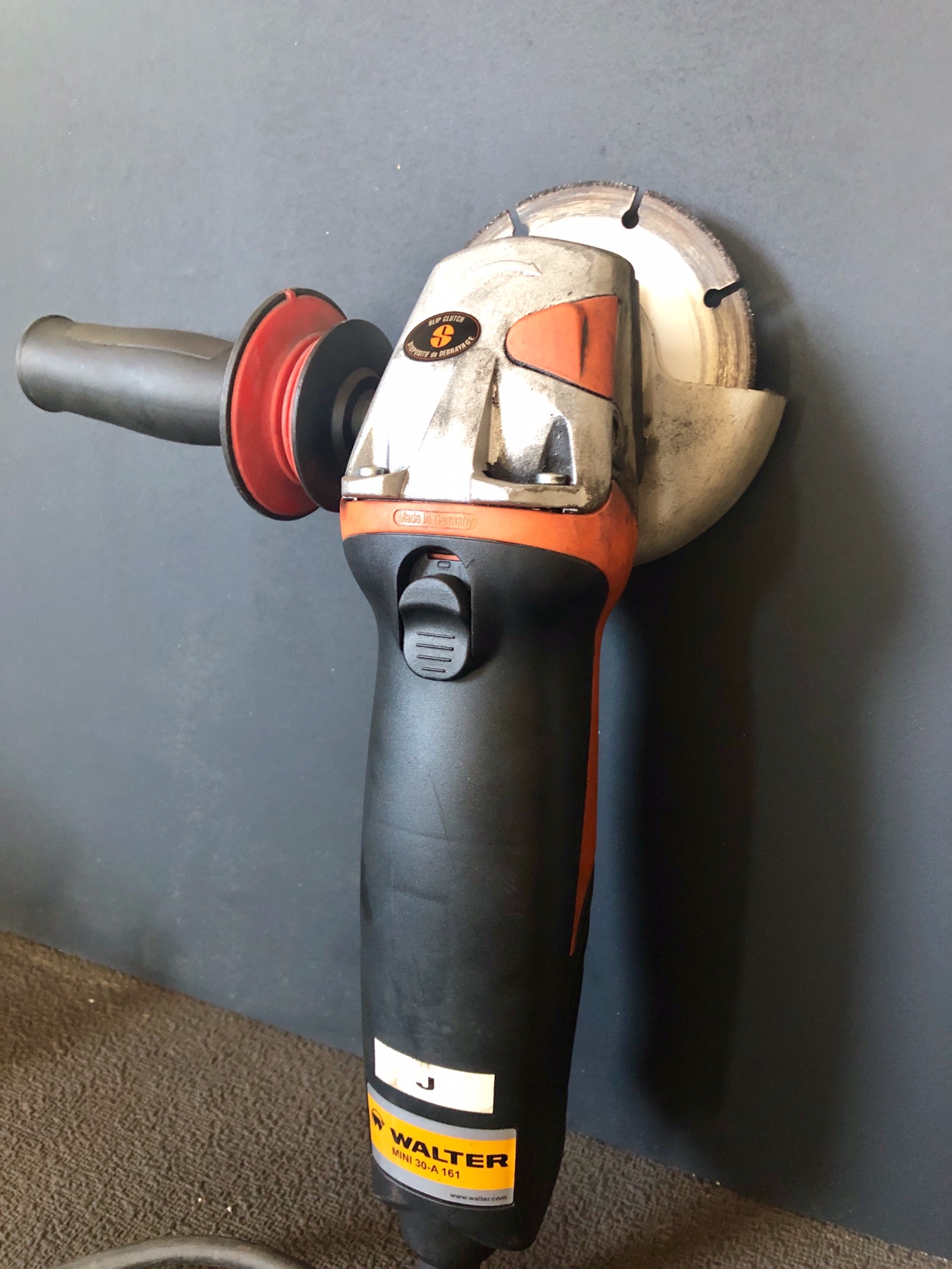

You are already familiar with using a cut off wheel in your angle grinder. If you are using a traditional thin bonded abrasive wheel I would recommend getting one of these instead:
Lenox 1972921 4-1/2" Diamond Cut-Off Wheel - KMS Tools
I’ve been using this one for almost a year. I’m certain I would have gone through at least twenty abrasive discs by now. I find it is way easier to control with greater precision. And no wasted time with blade changes or loss of cutting diameter.
Also safer as they are less likely to explode than questionable quality abrasives.

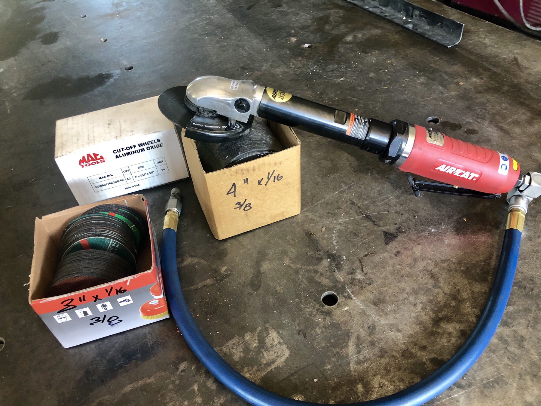

I really should order a 4” one for my extended reach cut off tool but I still have three boxes of 3 and 4 inch abrasive discs.
To the OP. Another great tool is the extended reach cutoff tool. I wouldn’t put it on your priority list as what others have mentioned well do you well. But it is an awesome tool.
