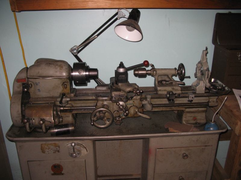

Back about 20 years ago I paid $1000 for my South Bend 9A and it came fully tooled with 3-jaw, 4-jaw, 6-jaw, face plate, several different QC tool posts, complete set of 3C collets and much more. Every now and then you see them for sale for about what I paid less tooling. This one is about 40 years old and is still going strong.

That is a great looking SB. I love see old machines that have been maintained.
