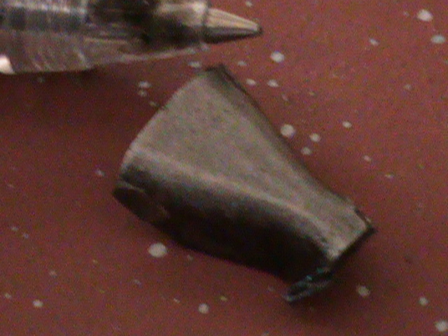

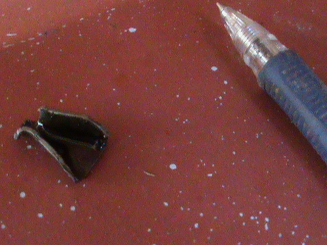

Well , here is a picture of that piece.
   / metal piece came out of oil pan when changing oil #18
   / metal piece came out of oil pan when changing oil #19
Being a mechanic, I wouldn't even start it until some preliminary investigations have been carried out. eg. rocker cover off, maybe sump off too. There may be more metal in there that did not drain out. Change the oil filter and oil again after you have it sorted
   / metal piece came out of oil pan when changing oil #20
i agree.. that calls for valve train inspection...
