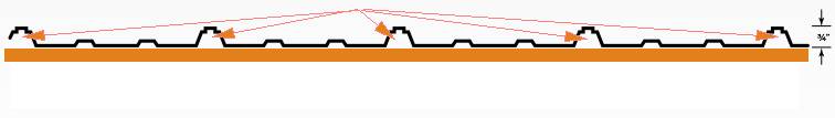

As for cutting the ridge. I understand why and how air moves etc. But if I do perlins horizontal from left side of roof to the right of the roof unless you leave gaps where the bits of the boards meet you will get no air flow from the bottom of the roof to the top of the roof since there would be blocks from the 2x4 every four foot. Do you leave say a six inch gap at each but of perlins to allow this air flow?
   / Metal roof over shingles roof. #10
Air passes between the 5 major ribs and the 1x4s as well as the 8 minor ribs.
