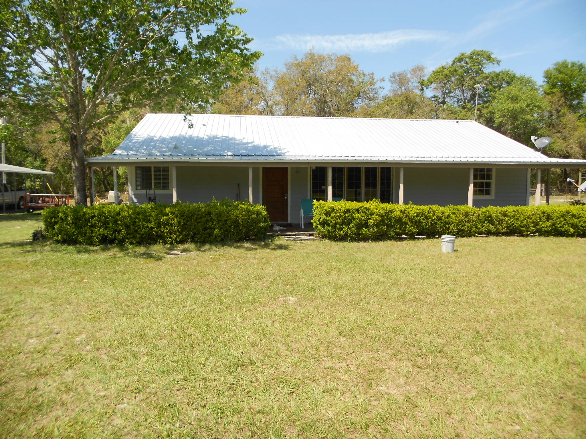

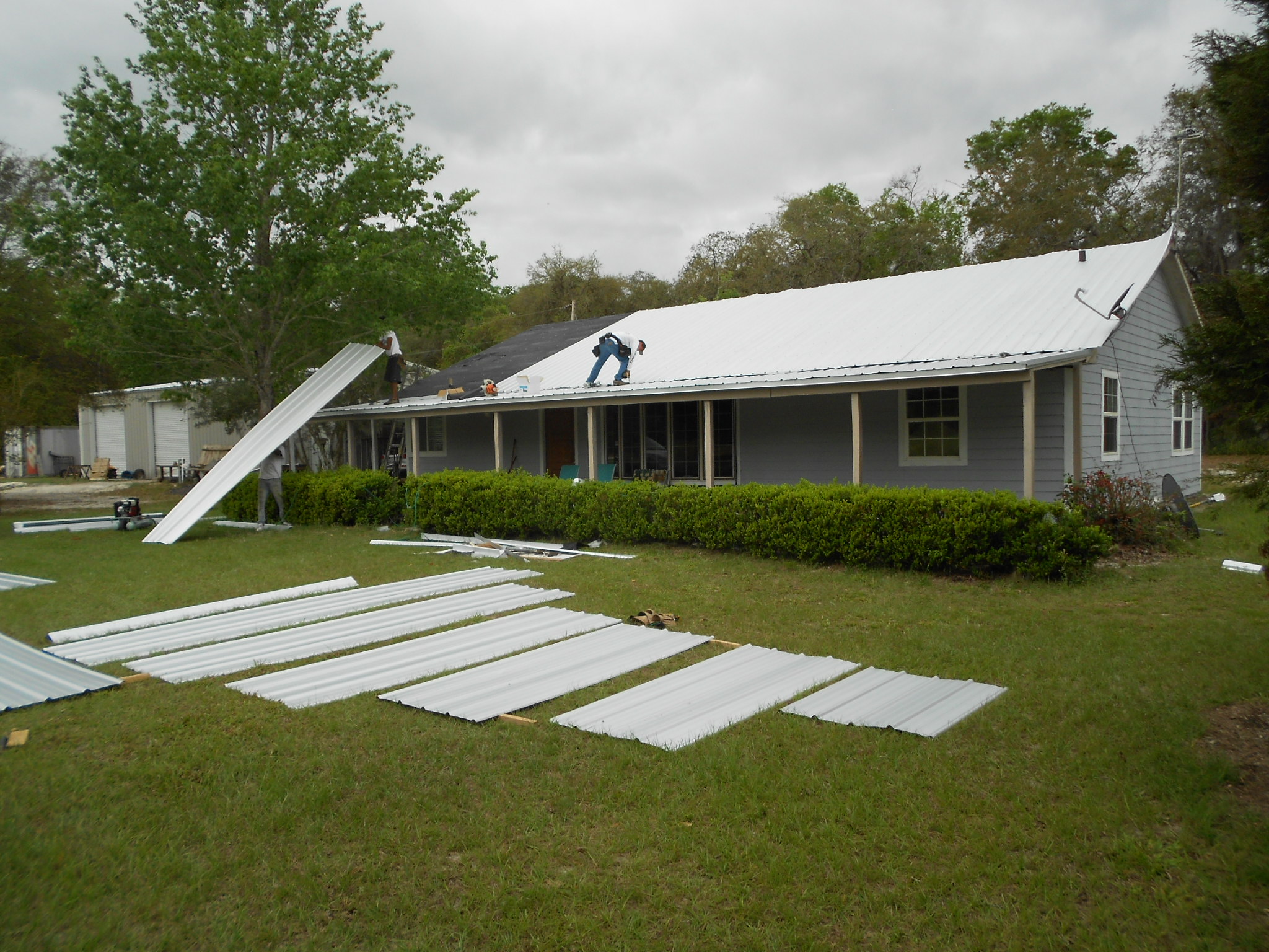

I had a new metal roof put on last year/spring by a licenced roofer, permitted and inspected.
He put synthetic felt down over shingles and screwed roof down with no furring strips.
He also screwed it down on the ribs and said it was engineer approved fastening.
