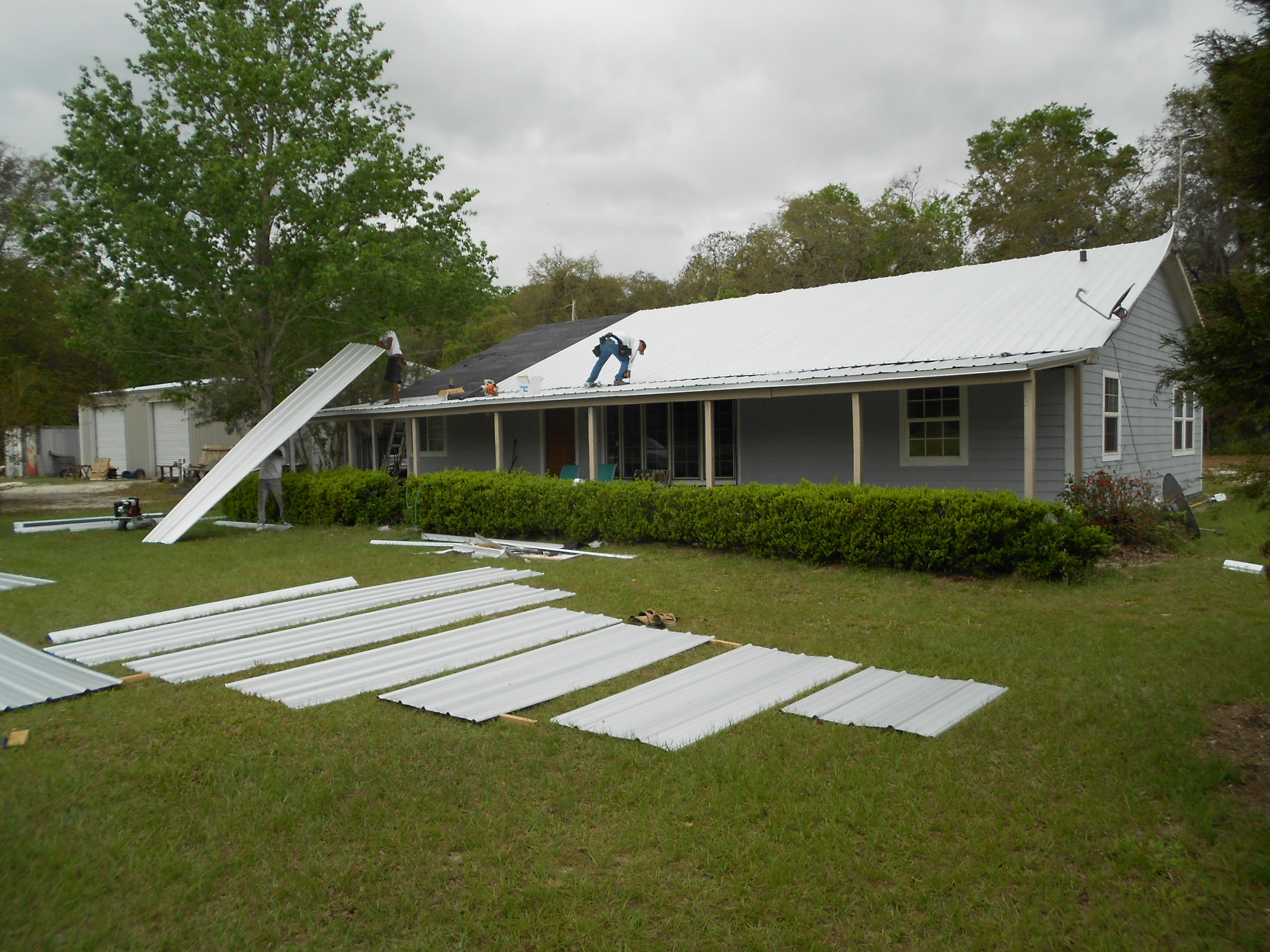

Just had my roof installed last April, 38 squares.
It took 3 men 2 days to do it.
They pre-drilled on the ground AND screwed it through the rib per engineers and inspectors approval.
Roofer explained that on flat rubber washer can leak, on rib water has to hit screw to leak.
They covered old roof with Rino-Roof synthetic covering.
Inspector commented on how neat the appearance was with the pre-drilling!
One man?? Depends on your age and experience.
There was a time I might have tried it.
ALSO!! Do not leave the panels uncovered where moisture/rain can get to them.
If wet galvanic action will ruin the finish in hours/few days.
