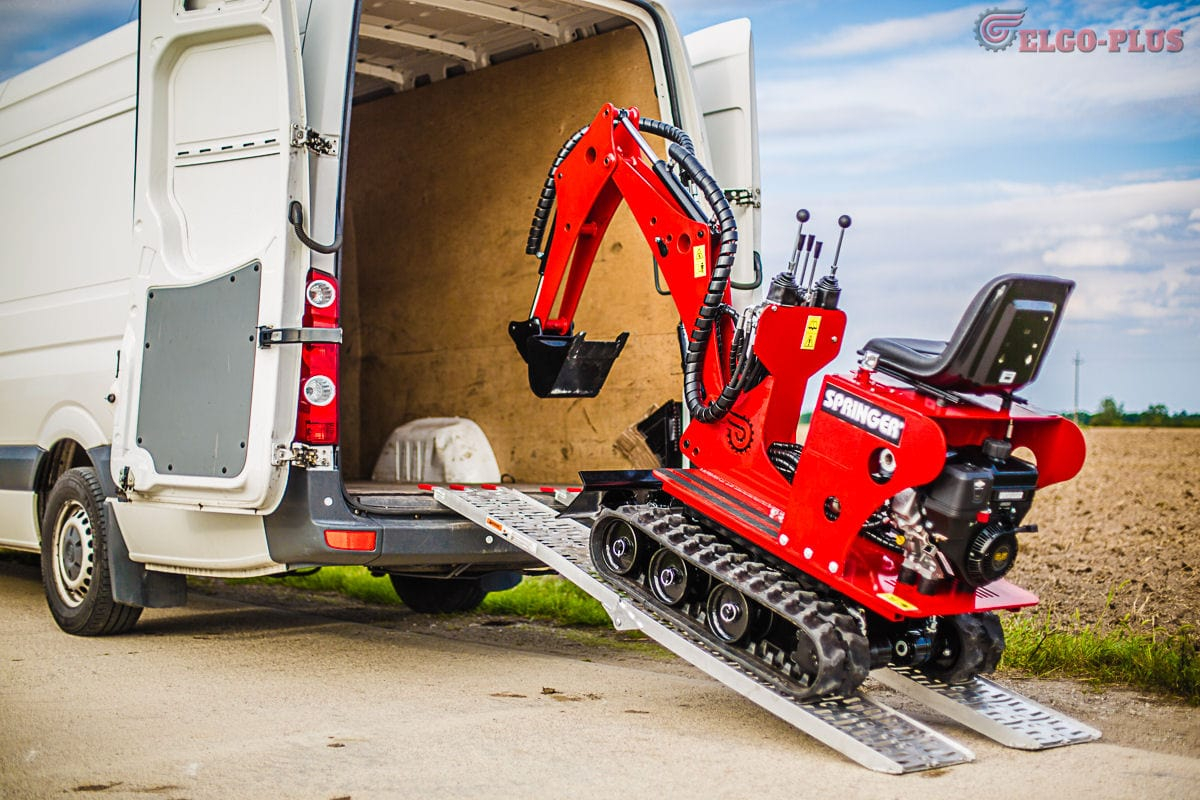

Im going to try and build myself a mini digger, similar to the one pictured.
Its a small machine with just under a 2x4 base, powered by a Honda GX160.
Without the tracks - given the cost of the tracks, motors, roller wheels, sprockets, rotary union, and a turret bearing large enough for the union, it'll have 2 roller wheels and 2 legs.
Anywho, I was going to use 1/4" steel plate, but the pictures look like it might be a 5/16 or 3/8 (or, given the country of origin, 8 or 10mm)
Think 1/4" would work?
I have a Weld-Pack 180, which technically can weld up to 1/2", however as I'm not a pro-welder, I'm more comfortable with 1/4"; but I don't know if it'll be strong enough.
Also, cylinder bore size, should I do 2", or smaller?

I was thinking about using the same material on the whole thing (or, "body)
I have about 2 sqft of 5/8th plate, anything else I would need to buy.
Local metal shop doesn't have scrap, and only sell 4x8 sheets. One sheet should do it, and given the cost, I only want to buy one.
It looks like they did the same thing here, as the boom and base are all the same thickness.
Ill be using it in the Arizona sand to dig trenches for sprinkler pipe, and a future block wall footing. Past that, just random digging projects.
I have a ditch witch now, but its absolutely miserable in the sand. Its like Atreyu trying to pull the horse out of the mud in The Neverending Story.
I've thought about mounting a winch to it, so it can pull itself along. If I can successfully build this, selling that clunker should mostly pay for it.
A mini excavator would 100% serve me better, but they are $20,000 on the cheap side; but most listing I see are $28k+
Even used Bobcates are over $30k locally.
Give the cost, storage, upkeep, this tiny machine would serve me better.
(also, this new is about $14,000 + shipping and import)

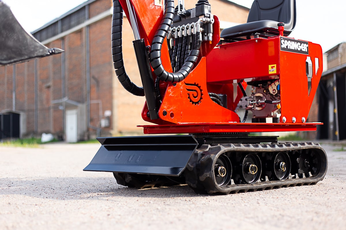

Pic here, looks a bit thicker than 1/4"
I like that the hydraulic tank is the seat, but I don't see a filter....

Letting alone material thickness for a minute, boom elements must be tubular, rather than parallel plate for torsional stiffness. Where parallel plate is the only way (at the joints), it's got to be thick to be stiff.
The machine pictured is certainly "cute", but I doubt very practical compared to renting a "real" mini excavator. My first observation is that it has only one hydraulic pump. That means that if more than one function can be run at once, it'll steal hydraulic from another function, so it slows down. There is little "fluid motion" with this type of system. Digging with one function at a time is painfully slow. Three pumps are the common arrangement, with that, you can dig smoothly. Another observation is that there is a minimum practical weight for mini excavators. Too light is handy for getting it into the back of a van, but it won't have the oomph to dig into hard ground, or resist pulling against the bucket (you'll pull it along the ground, rather than digging a trench). And, when it breaks, your jobsite work just topped, while you [try to] load it up, to take it home to tinker more. The rental machine gets returned, and they replace it with a working one.
Sure, tinker and build to your heart's content, but if you value your time, and have a job to do on time, use a proven tool....

Calling this thing an excavator is a huge stretch. More like a power assisted shovel.
Now, Aside from the drive train, which I said I was ditching anyway - I could buy all the material, hydraulics, plasma cutter, a better welder, and a predator engine to power the thing, and still be well under the price of a new one.
Not only that, I think if I did use 1/4" material, and it bent, I would still have money left over to build version 2 out of thicker stuff.
Very experienced equipment manufacturers spend immense amounts designing and constructing competitive, desirable equipment.
Maybe the scale of the thing isn't coming across. The operator platform (or cab?) is less than 2'x4'
I put the images into Fusion 360, and calibrated using the known base dimensions to get the dimensions of the boom and arm, I don't remember what they are, but the boom is just under 3' long. Where its pictured driving into the van, at that stance its probably 7' long.
I agree on the money spent on every aspect of equipment, but this is not a John Deer or a Caterpillar, or even a Kubota. This is a cheaply made Chinese machine, being exported and rebranded all over the world. (except the US it seems)
Those aren't the cast iron track rollers you would find on a bobcat, those are stamped and formed steel rollers. It does have a steel cog wheel, but not the same quality you would find on a US machine - but it doesn't need to be. Each one is only responsible for moving a couple hundred pounds, unlike a Bobcat, where its closer to 7000 pounds.
Those are 180x72x31 tracks - dirt cheap ... in China.
31 being a less common size, but if you go with a 180x72x39, they are less than $80 each, unless you buy 25+ then you get the 50% off bulk price. But, shipping one set isn't cost effective compared to just buying them from someone in the US who imported hundreds of them to sell at a massive markup.
If you go with a 180x64, you get into modern snow mobile size, and more track wheel options (the more there are, the cheaper they are)
Well yeah, but that's common on most machines.
Simple fact of a 'real' machine is the quality, and mostly built to last. The manufacturing and markup on quality equipment is a whole subject by itself.
This is neither. Its a cheaply made machine with a huge markup. Most common complaint with cheap machinery is the lack of replacement parts - and there are many reasons for that which is a whole discussion by itself.
Of course. You aren't using this to break up concrete and load a dump truck.
You are using this to dig trenches for sprinkler pipe, holes for trees, and footings.
Its a small, light weight machine made for small uses.
You shouldn't compare this to anything that has more than one cylinder.
Correct. But again, you need to remember is use - light duty use. In my case its sand.
Not all rental places are created equal, at my local rental yard if it breaks, you pay for it.
They require a couple thousand dollar retainer to cover any equipment damage and mechanical failure.
This bother me, because if you are renting a machine with a few thousand hours on it, can you really be held responsible if the pump dies while you're using it?
So you think I should use 2"x3"x1/4" box for the boom & arm then?
1/4 inch steel would probably work for the boom skin but the ends of the boom where the pins go is heavier than 1/4. The boom hinge is a lot more than 1/4. Almost the whole undercarriage is more than 1/4. I own a larger excavator but I had to rent this little one. There’s a lot of steel in that heavier than 1/4. I got my job done in 2 hours and they changed me the lowest rate of $130. I think the daily rate is $200. I expect you can buy that machine in decent used condition for $10k. I stick with the opinion that you would be a lot better off buying one. I’d buy a bigger one too. The only useful reason to go that small is it can drive through doors. Otherwise I’d go 5000 pounds minimum.

1/4 inch steel would probably work for the boom skin but the ends of the boom where the pins go is heavier than 1/4. The boom hinge is a lot more than 1/4. Almost the whole undercarriage is more than 1/4. .... I expect you can buy that machine in decent used condition for $10k. I stick with the opinion that you would be a lot better off buying one. I’d buy a bigger one too. The only useful reason to go that small is it can drive through doors. Otherwise I’d go 5000 pounds minimum.
Only thing about $10k near me is an imported mini, which run 10k-13k. Which, the metal on them might be okay, but repair part and longevity is not going to happen with those.
I'm no expert, but it seems any low priced used equipment on the west coast gets trailered into Mexico. Decent low priced functioning equipment is few and far between out here.
There was a Skid-Steer from the late 70's for sale, repowered by a Honda twin cylinder. Guy was asking $12k for it yesterday, and now the listing is gone.
If I wanted one, a trip to a new equipment dealer would be the best option.
I have a mini dozer from the 40's that I use to fill the trenches left from my ditch witch, I was offered $2,500 for it - which is just insane. I would have taken it, but I needed it to build my driveways and fill trenches. Ditch Witch I will sell in a heart beat once I have a replacement trencher.
Its good because it works, but every part on that thing costs a fortune should it ever break.
Thanks for your input on the metal.
Perhaps I can make the boom with 1/4, then add a second backing plate of 1/4 to give it more rigidity at the pin mounts, and do the same thing on the boom mount.
