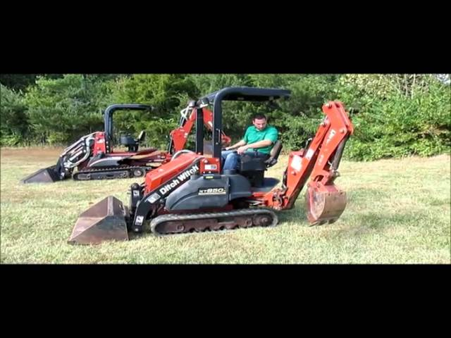

Below, is plan B if I cant get this thing proper.
/ Metal Thickness? #130

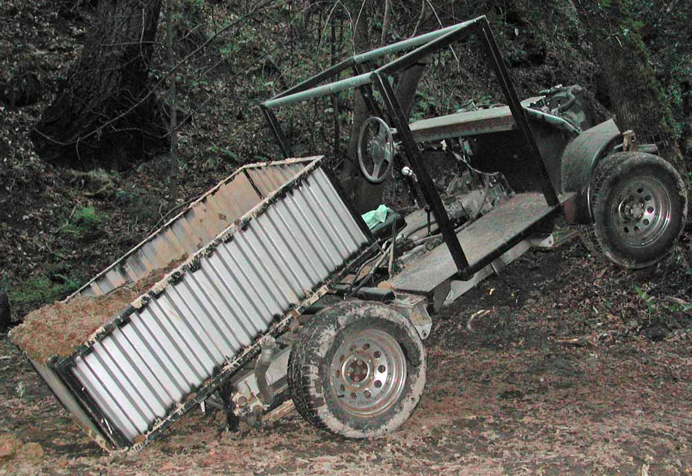

That looks like a former.. concrete buggy?! I love it!!
So glad to hear you’re sticking to the slew base. Even having to rotate with tracks between every scoop would SUCK. You wanna see a crazy swing boom idea, look at a Ditch Witch XT850! Crazy, not easy..

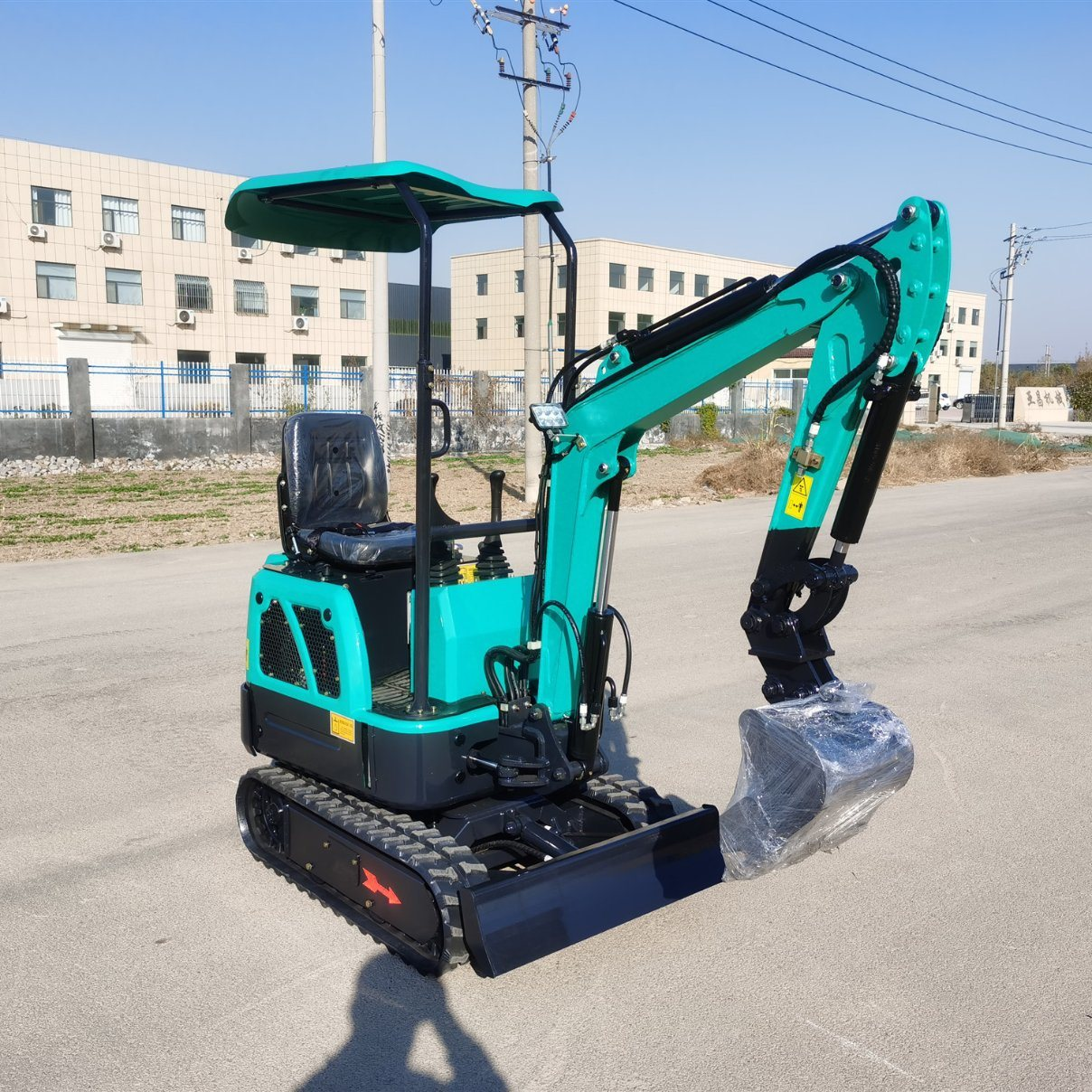

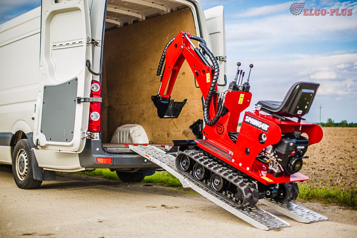

Im going to try and build myself a mini digger, similar to the one pictured.
Its a small machine with just under a 2x4 base, powered by a Honda GX160.
Without the tracks - given the cost of the tracks, motors, roller wheels, sprockets, rotary union, and a turret bearing large enough for the union, it'll have 2 roller wheels and 2 legs.
Anywho, I was going to use 1/4" steel plate, but the pictures look like it might be a 5/16 or 3/8 (or, given the country of origin, 8 or 10mm)
Think 1/4" would work?
I have a Weld-Pack 180, which technically can weld up to 1/2", however as I'm not a pro-welder, I'm more comfortable with 1/4"; but I don't know if it'll be strong enough.
Also, cylinder bore size, should I do 2", or smaller?
A couple of comments….After building stuff like this for years, I think you will be shocked at how much the parts will cost to build that thing. The odds and ends you will need add up in a big hurry. Don’t forget that the company that builds those excavators, buy the parts in bulk, probably in China.
Stating the thickness of metal a welder can weld is not very reliable. It usually refers to using a single pass on square edge material and it’s usually very optimistic. You can actually weld any thickness of metal, with a very small welder, with edge preparation and using multi-passes.
Have you thought of looking for a used mini excavator in poor shape and rebuilding it….may be cheaper in the long run.
