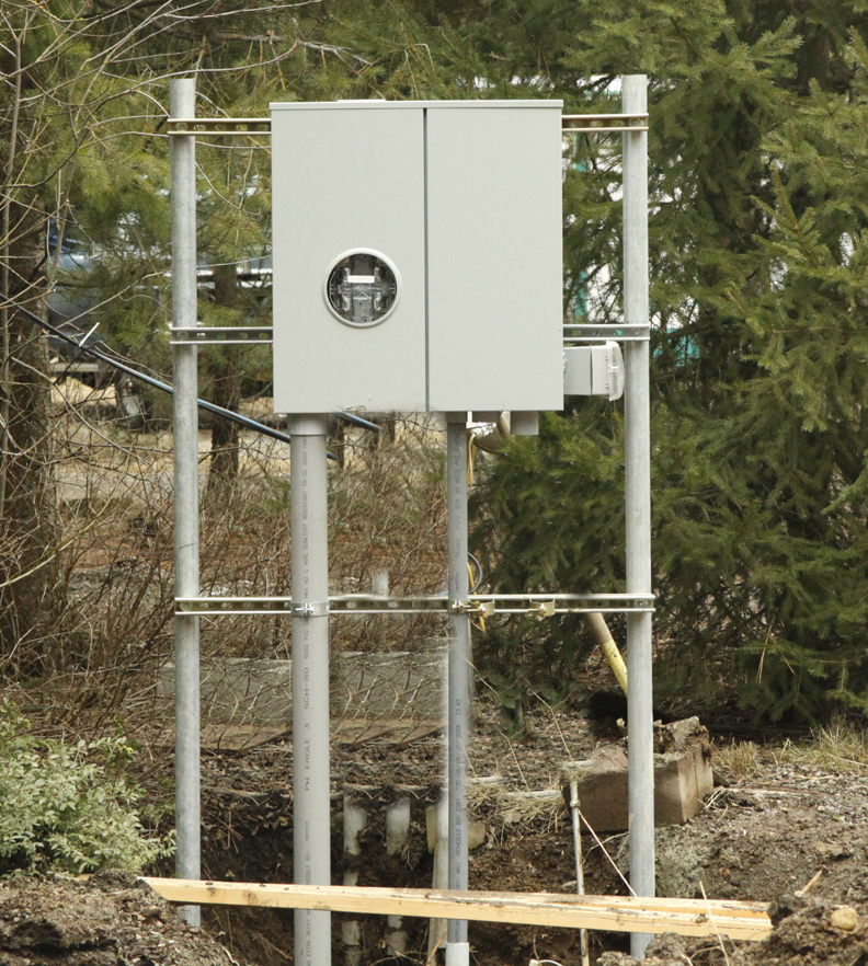

Personally i always suggest a 400 amp service to be installed on farms (minimum). This allows for 200 amps to the house, and 200 additional for wells, area lighting and shop/barns.
They sell a nice 400 amp combination panels that have (2) 200 amp breakers and an 8/16 space panel for other services.
this is a pic of the Siemens 400 amp system.
I agree 100 percent. Last fall I had to replace a new 200 amp service with a 400 because the customer decided he wanted to go with geothermal heat and a sauna. I tried to convince him when we started the project but he would have nothing to do with it. He was apologizing to me as I dug up his landscaped yard to replace what he had already paid for once. You are better off paying the extra and never needing it than the alternative.
