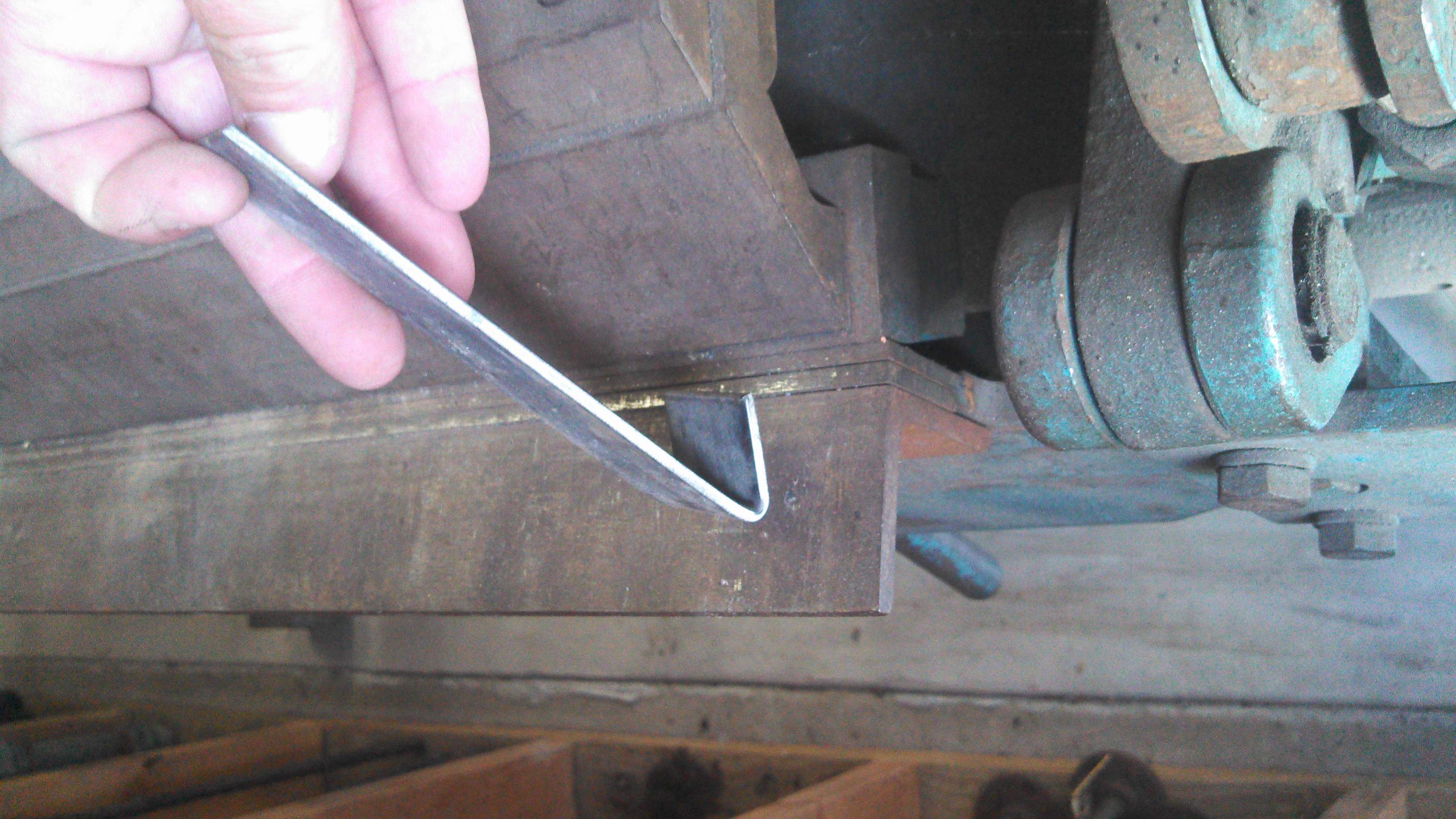

The shop I work at just uses different dies to bend past 90 degrees.
   / Method for bending past 90 deg? #16
I read the OP's post as he was making triangles or needed to bend completely around something to make the part.
If all he's needs is a "V" any finger brake will work. As they can bend metal to 180.
   / Method for bending past 90 deg? #17
They say a photo is worth 1000 words, so I found a drop of 1/8" plate and made the first bend on my finger brake. Came out at 135 deg on the first bend, remove lower the fingers back down and drop the arm again and your at 180.
