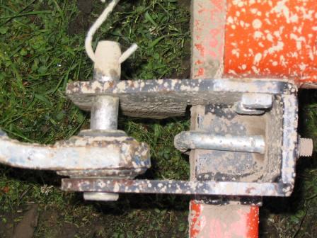

I use a 6' crowbar and this helps to move the disc or (what ever) forward and backward and side to side to line up the pins. The tiller does not have pins but rather two verticle plates that you lower your arms into and then you just slide in the pins. I have thought about makeing all my 3pth like the tiller, I will go get a pic so you know what I am talking about.

Here is the pic of the tiller hitch.

I would think the Pats would still work, looks like you have more room than I do. I have to tilt my tiller to get the hooks on, but have learned to do it off the tractor, one hand on tiller, one on lever to lift the bottom links.
I saw some attachments at my local dealer the other day that had that type of arrangement on them. Now if they could put a plate under the tabs, to rest the links in, then you could shim it up to be perfect each time.......back up, lay them in, put in pins and go!

I have both the Quick Hitch (now for sale) and Pat's system. The quick hitch is a little easier to use but totally lacks in "width" vesatility. Pat's is more vesatile, and since it connects from the bottom, not the side, it would solve your problem.
