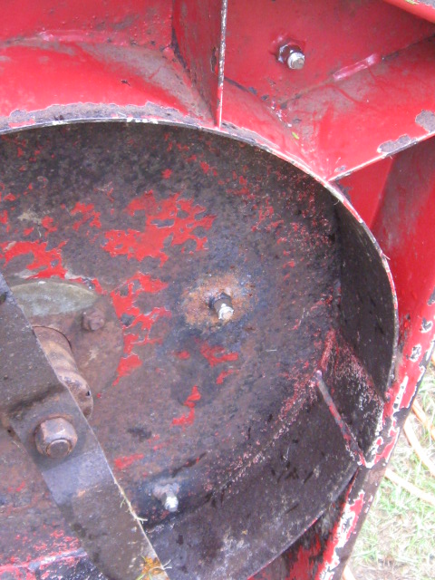

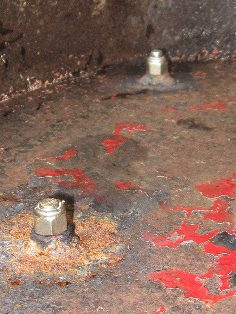

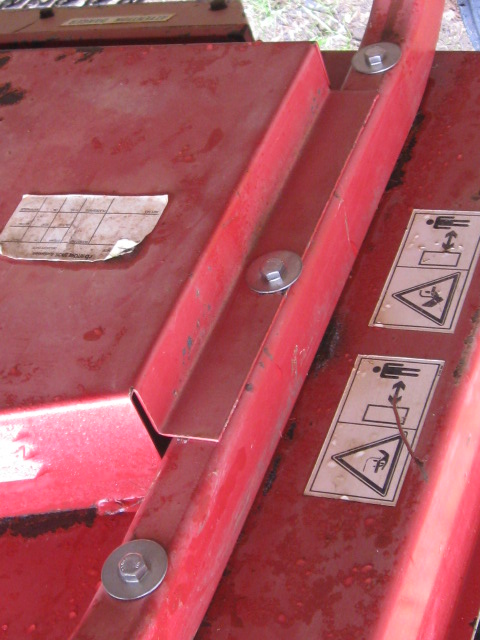

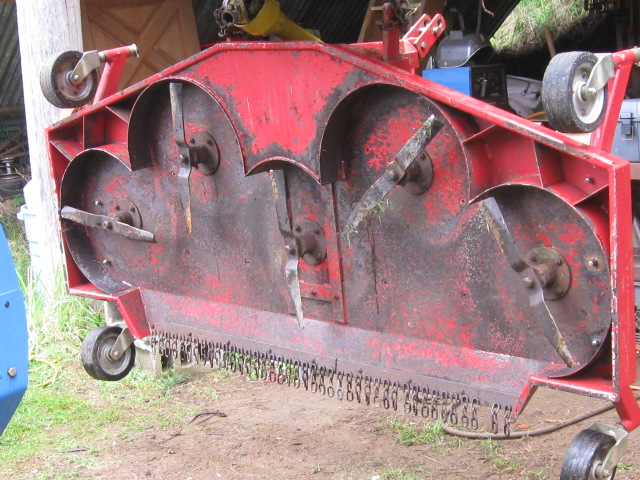

Here's the fix I did for the rusty 'wheel axle' bolts. Though they were metric, I discovered that a 3/8 NC bolt threads freely though the metric captive nuts, if only just slightly loosely. I replaced the bolts with stainless 3 1/2" X 3/8" bolts with stainless fender washers and lock nuts, double nutting the captive nuts after the bolts were well tightened in from the top. I think this will be an okay fix, except it will make opening the belt case a bit of a pain, as I will have to remove the lock nuts each time I open the cases. I will be working on a workaround for that soon.
