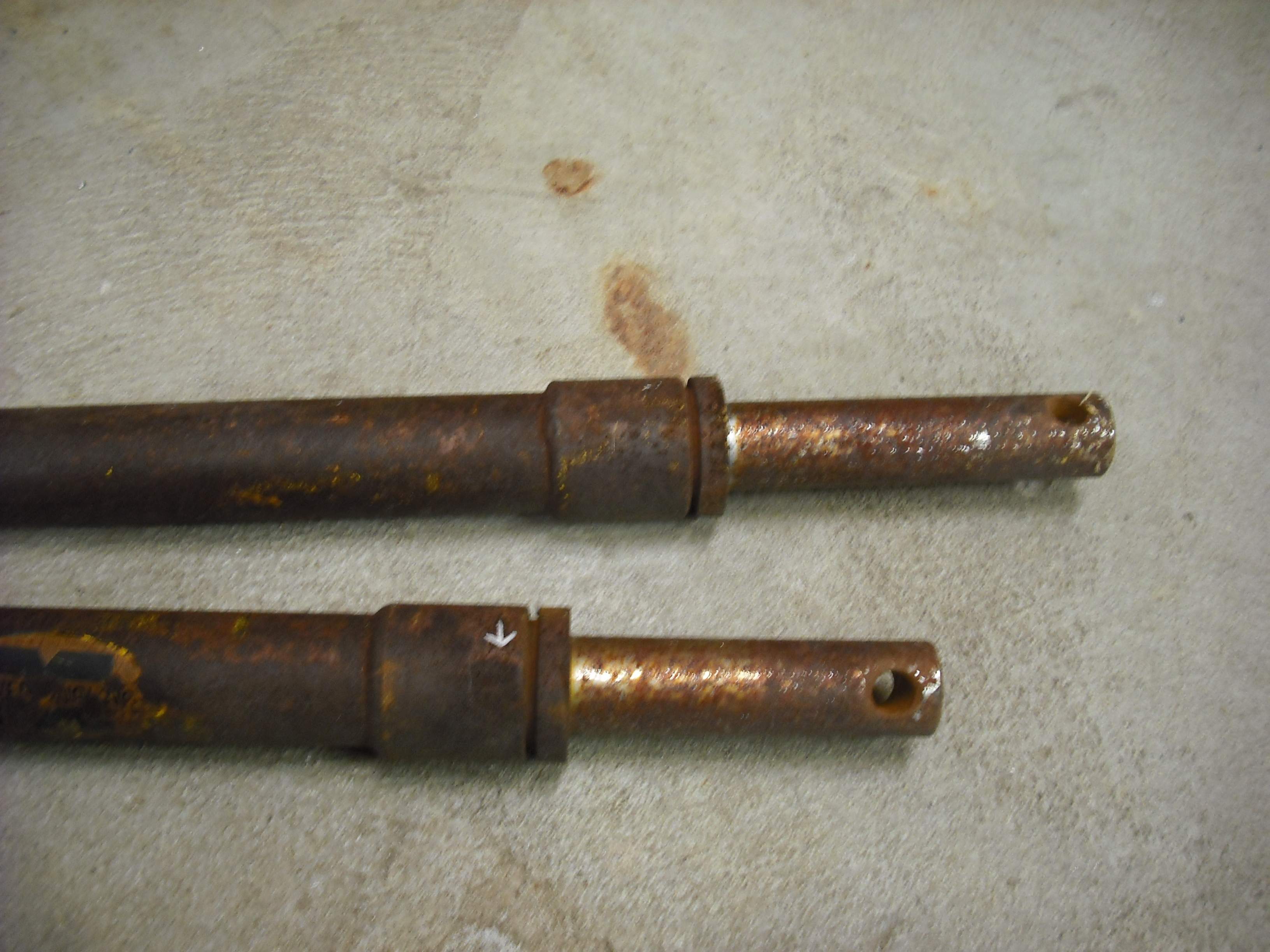

I never said the cross over relief was built into the cylinders. I said it was built into the plow hydraulics or the tractor . That could mean the lift pump on the plow or the hydraulic system on the tractor.
At least get the inside joke right. :rolleyes:
:) j/k.
   / Meyer Snowplow adapted to QA? #10
:) j/k.
:rolleyes:
, but the cylinders do have relief in them when
