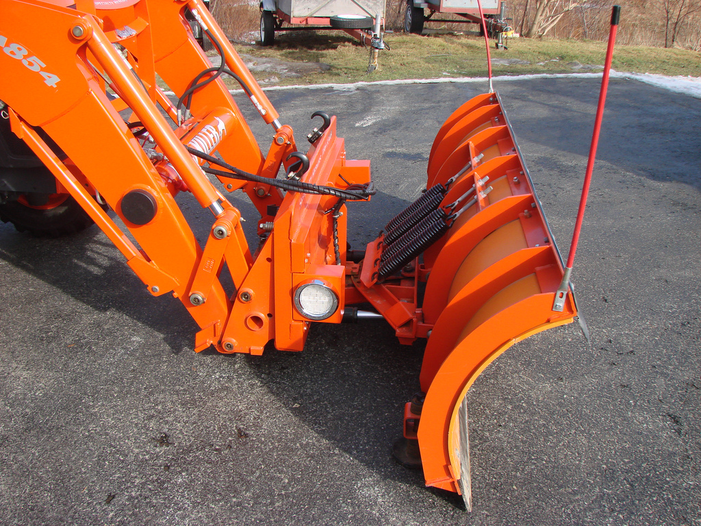

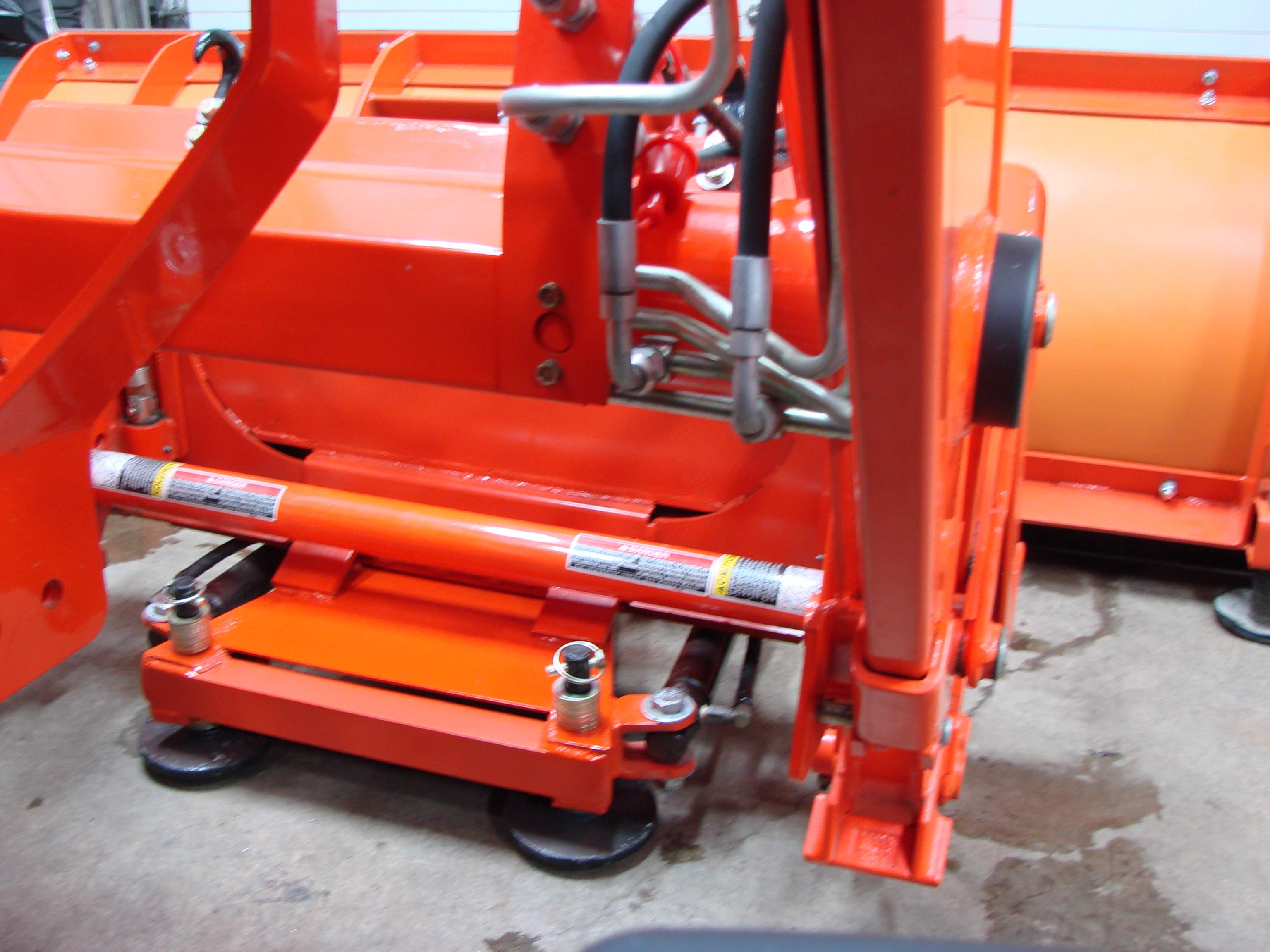

I really like 4 shorts set-up too. I like the shortening of the plow frame and I don't want to take anything away from his work except one little thing: I don't like the rams under the mounting plate. They look really close to the ground and succeptable to damage.
I know I'm going to get whupped-up on for suggesting that, and his is a better set up than mine, but I wouldn't feel secure about the rams being that close to the hardtop and I like having my QA plate free for other uses.
Might be able to cure this with skid shoes on the back.
Flame suit zipped, Kevlar vest on and high top steel toe boots with metataursal protectors tied. :D
Builder my friend you made a good point on the rams but there better off under the frame than on top of it. I've had lumps of hard snow come over the top of the blade that would have taken those rams out if they were on the top of the blade frame. Have a look at the first picture. Yep, rear skids ;) Last winter I also added side Super Nova LED strobe lights to the system so when I'm backed into a driveway and my blade is out in the road vehicles can see the blade much easier. It's nice to see some of you like my design :D It might not be the design that fits everyones needs but it sure works for me.
Oh and as for the relif valve. I've got 13 years with that plow on the front of a 1993 GMC truck and one year with it on the front of the Kubota and when I've hit something side on it worked the exact same way which makes me that the hyd's on the tractor has something there to make the pressure by-pass if It needs to. I can only report on how it worked for me last winter and I'm more than pleased with the set up.
