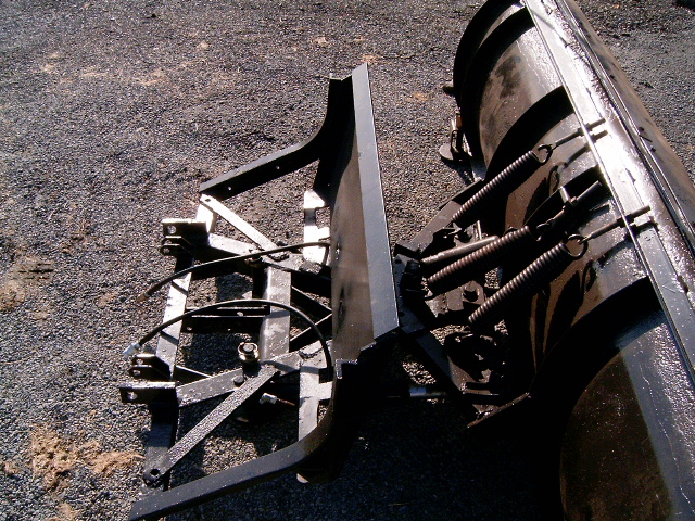

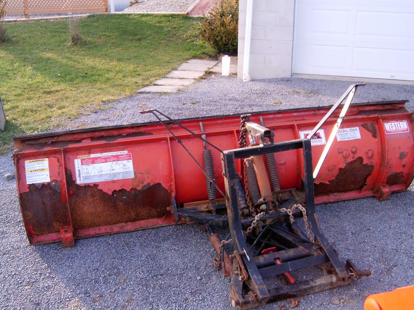

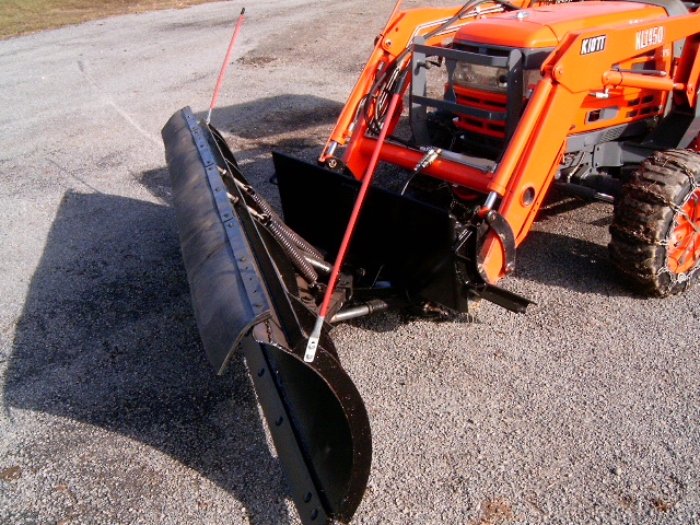

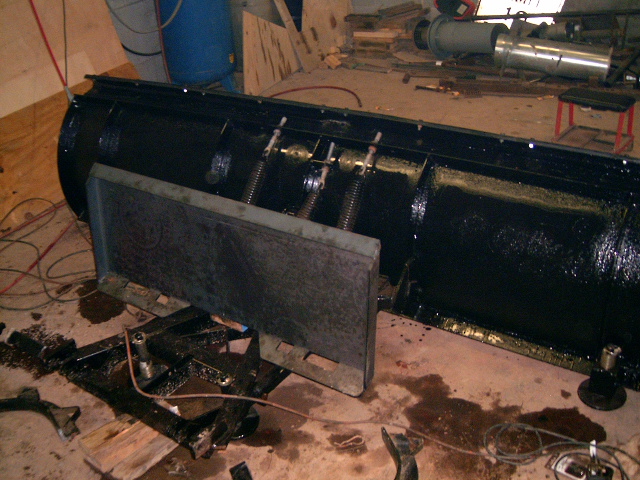

I added a QA plate to a Western plow for snow removal
