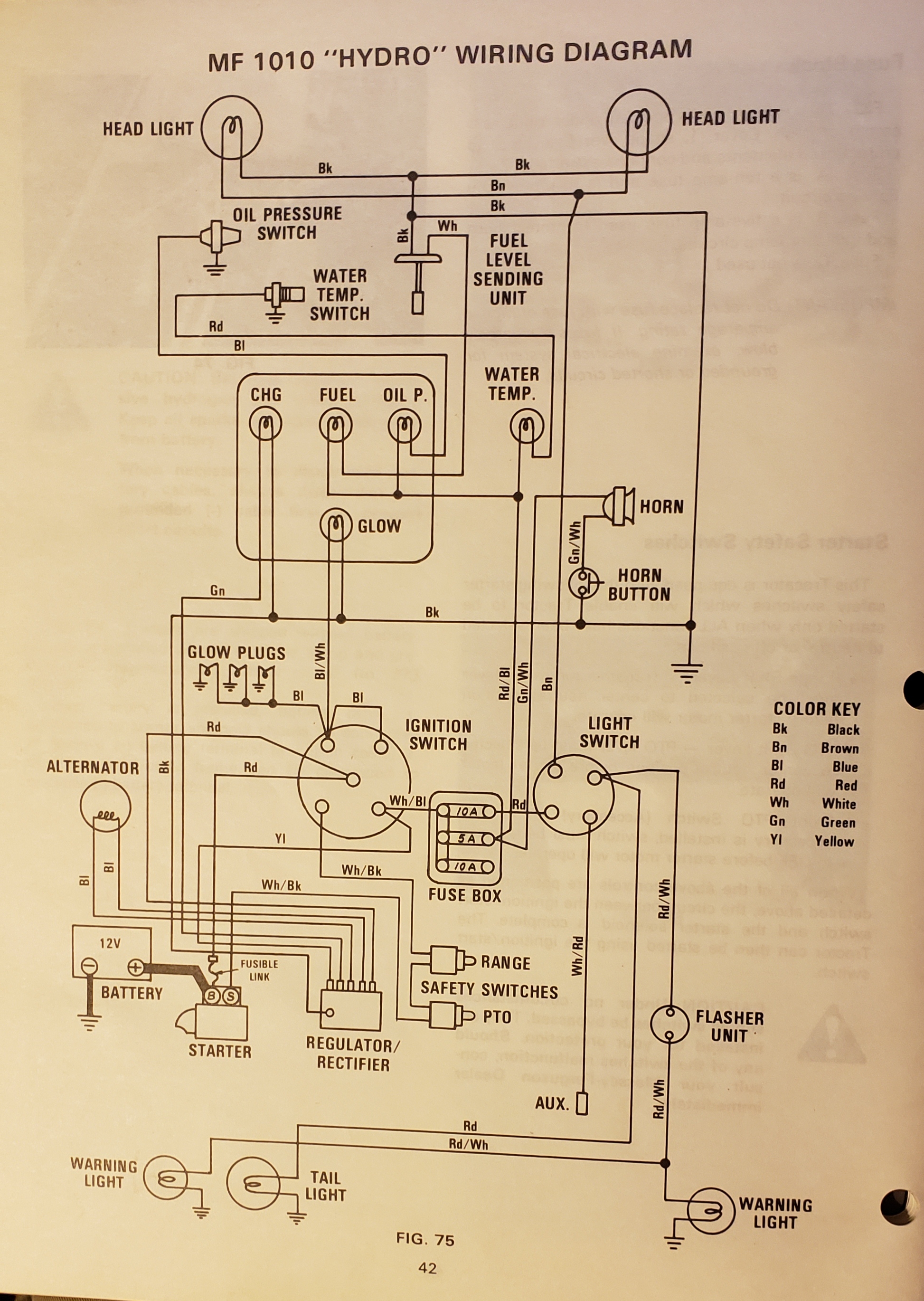

I did some research and found some discussions on needing to "reset" a voltage regulator after a battery disconnect. This is done by "sparking" a "fld" lead. In checking my wiring on the tractor, it has a voltage "rectifier" with 5 wire coming out of it. In checking a wiring diagram in an operator's manual I have, it shows:
2 wires go to generator
2 wires go to ignition switch
1 wire goes to a charging light in a display.
Does the rectifier need to be "reset" like a regualtor? If so, I'm not sure how to accomplish that on this rectifier.

In researching my issue and tractor more, I found out that I do need to do the above procedure. In fact, I do not have a generator. It's an alternator on my MF1010 "Hydro" with hydrostatic drive. However, it still makes use of a voltage rectifier.
I found a wiring diagram for it and information on the charging system. It shows that the uncontrolled voltage (before it hits the rectifier) should be 25 volts on a MF1010 and 30 volts on a MF1020.
After the voltage regulator, the voltage should be 14.5 plus/minus .5 volts. Amps should read 11-12 for the MF1010 and 16-18 for the MF1020.
The alternator is listed as a GP 8122 for the MF1010 and GP 9153 for the MF1020.

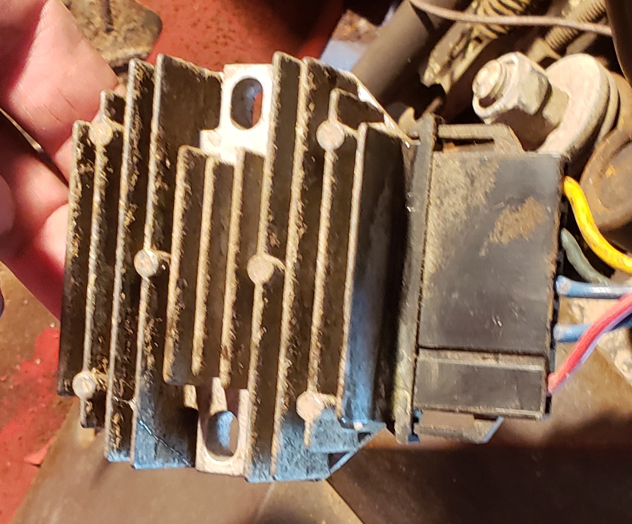

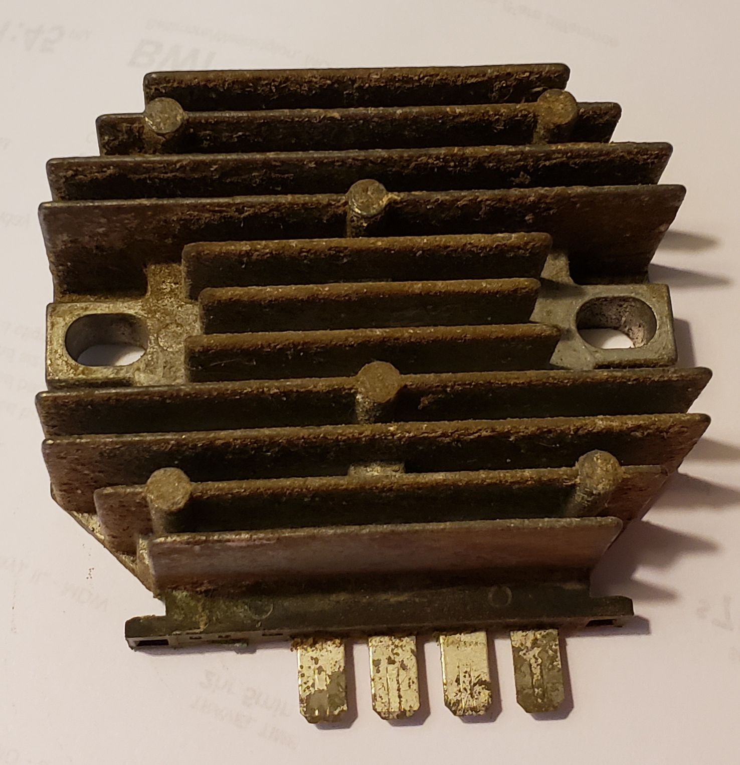

I checked the AC voltage coming out of the alternator and it was right at 25 volts, so that seems fine.
I turned my attention to the rectifier and when I pulled the plug off it, one of the tabs was hanging on by a smidge and then broke off. It is the tab that the red wire conencts to which ties back to the battery by way of the ignition switch. I suspect my problem has been with this piece, slowly loosing connectivity over time.
I'm posting pics of the damaged rectifier and the wiring diagram for the MF1010 Hydrostatic for future reference.
Now, where can I get a replacement rectifier?

Well, I replaced the regulator/rectifier with a model AM101406 rectifier. From the research I did, it is supposed to convert/put out 14.5 DC volts. It was an exact hook up for the existing plug on my MF1010. When I started the tractor, it registered 12.8 when reving the engine.
