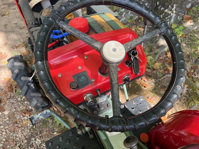

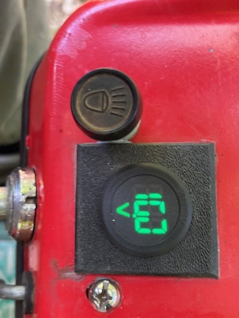

Thanks to the two responders to my issue; much appreciated. We had some ugly weather over the weekend from the noreaster in NC, so it wasn't until today that I could get more voltage readings and supply a few photos.
I'm pretty sure that I'm getting high VDC. In my recent rework of electrics, I installed a digital volt meter on the dash. For the sake of photos, the captures are flickery. The one that I do show kind of close up is displaying 16.3 VDC at roughly 1/2 throttle position; I don't have a tach. This volt meter is from ground to one of my "out" wires from the new fuse box installed. I think it's my headlight circuit, but it really should not matter. At the same time I was seeing this, I opened the hood and took a reading directly from the battery posts using my multimeter set to read 20 VDC. What I got there was within .2 volt of what I got on the dash-mount meter. If I throttle up, the volts go up to about 17.5. If I go to the lowest idle, I get around 13.7. Of course if I turn on lights, my new light bar (with two LED forward mounted lights and three rear-facing red and amber LED lights) or press the thermostart button, then the volts go down.

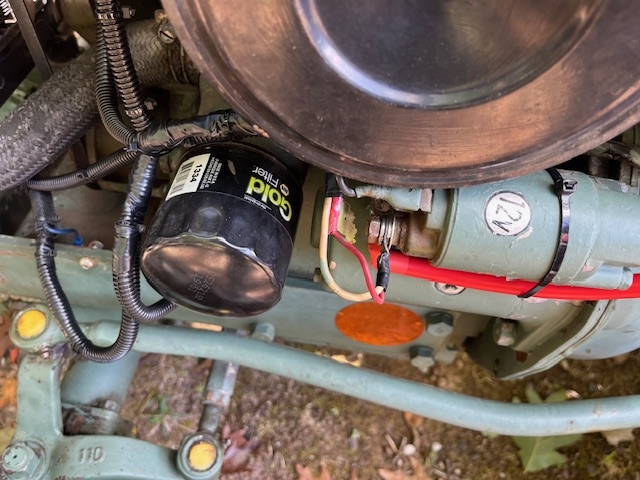

I'm thinking about the only possible issue must be the voltage regulator/limiter. As pointed out in my original post, there are two wires coming from the generator: one is red and one is yellow. The regulator has three wires: red, yellow and black. The regulator is new, but it might not be good or it could the wrong one although the supplier said it "should" be the right one.
As for the gen wires, the yellow is supposed to go directly to the yellow regulator wire...and it does. The red gen wire goes to the post on the starter solenoid (shown on one of the other pics) where the + main cable from battery also goes. The red wire on the voltage regulator goes to the IGN terminal on the key switch. This wire gets voltage when the key is in the ON position. And lastly the black wire on the regulator goes to ground.
Compared to many set-ups, this one is pretty simple. Two wires from GEN and three wires from regulator. But in the end, I'm getting upwards of 17 volts (and pretty sure it's DC and not AC) instead of what I'd expect...something less than 14 VDC).
So with this additional info, anybody have any other suggestions about what the problem might be or any other tests I might run?

/ YM1100D electrical issue #9
Do you have a digital voltmeter besides what is in the dash? If so, can you show the readings on the input and output of your regulator compared to the battery negative?
While it is possible that there is something off with the regulator (e.g. broken wire, or disconnected internally), I personally would be more inclined to question the dash meter. Can you connect the dash meter to something that you know is good, e.g. the battery directly?
