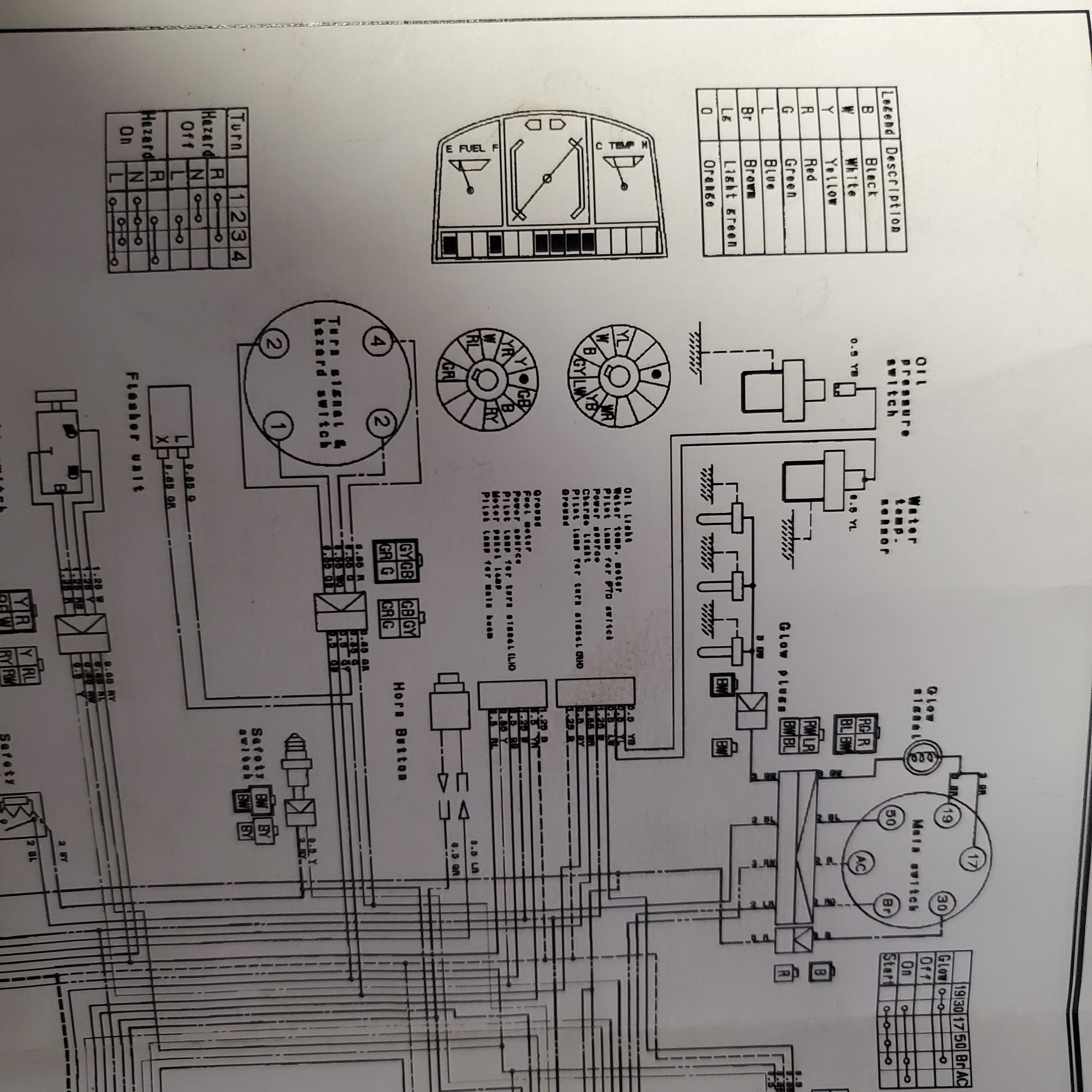

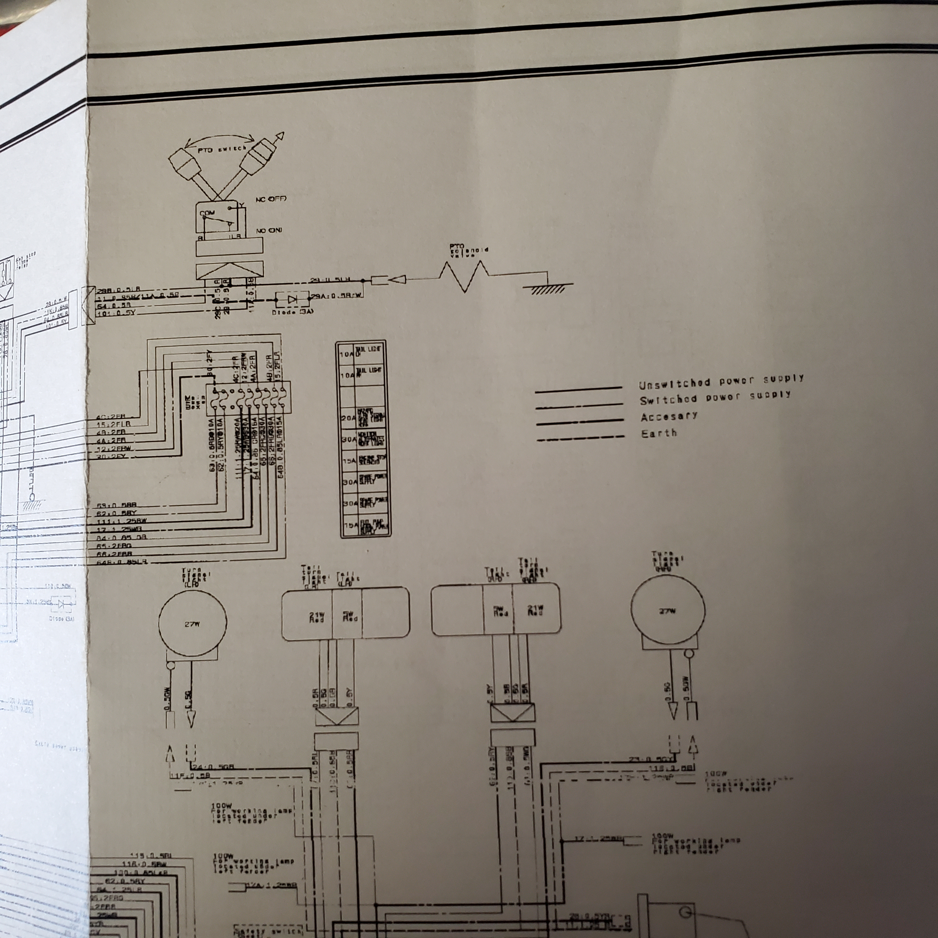

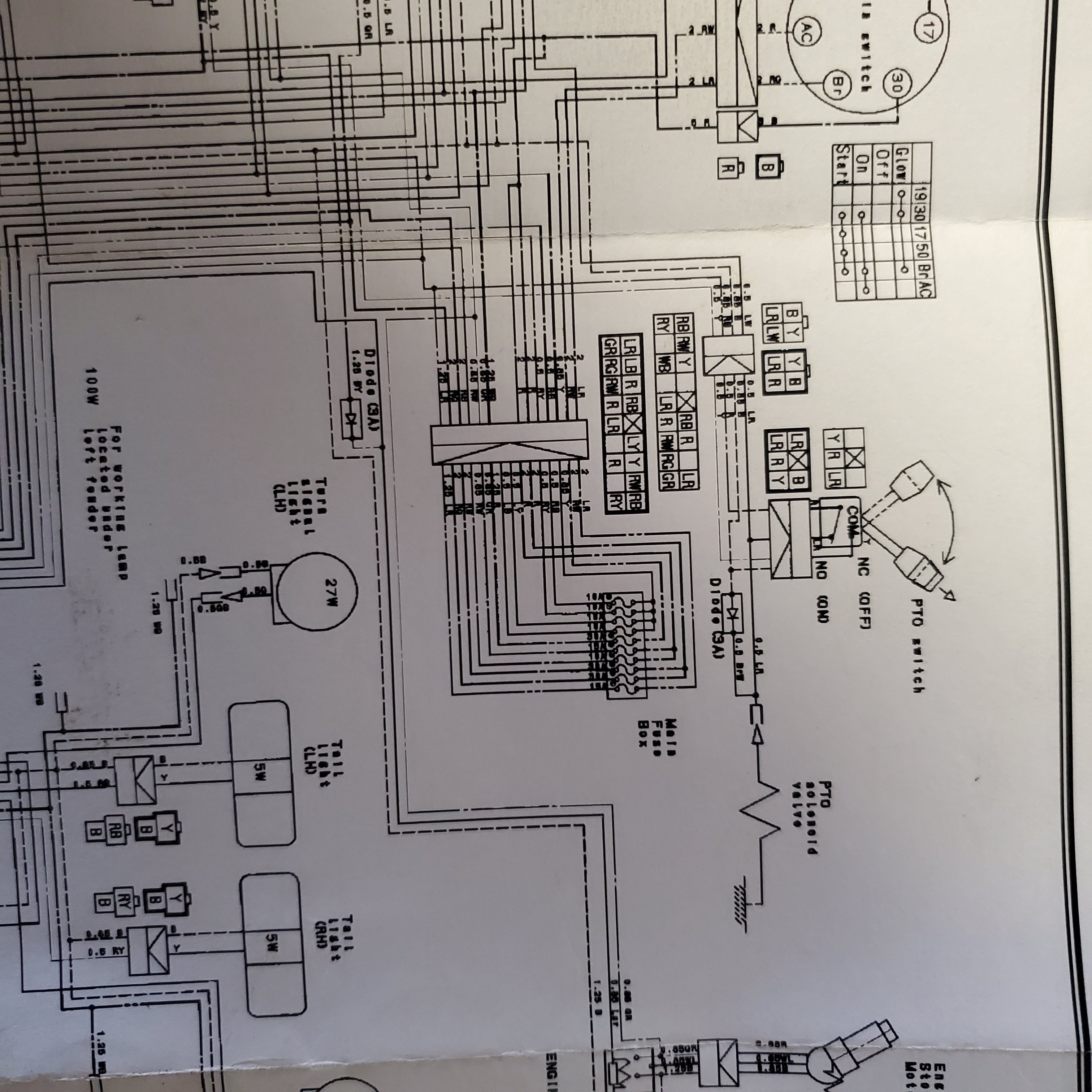

Purchased my MF 1240 4 WD with manual transmission back in 1997, new. Great compact tractor and had no major problems until recently. Engine would not turn over! Checked battery and determined that starter might be the problem, replaced starter and ignition switch and problem continues. Not much of a mechanic but can follow wiring diagrams. Unfortunately, don't have a good WD and am specifically looking at locations and wiring for safety switches. Suspect that or safety relay.
Question 1: Where is the safety relay located on this tractor?
Question 2: Is there an easy way to bypass all the safety (interlock) switches? Appreciate any help.....thanks

My belt was loose, enough that it would not charge the battery, or start. New battery , new starter, new ignition switch. Belt was just loose enough.
   / MF 1240 Safety switches and relay #4

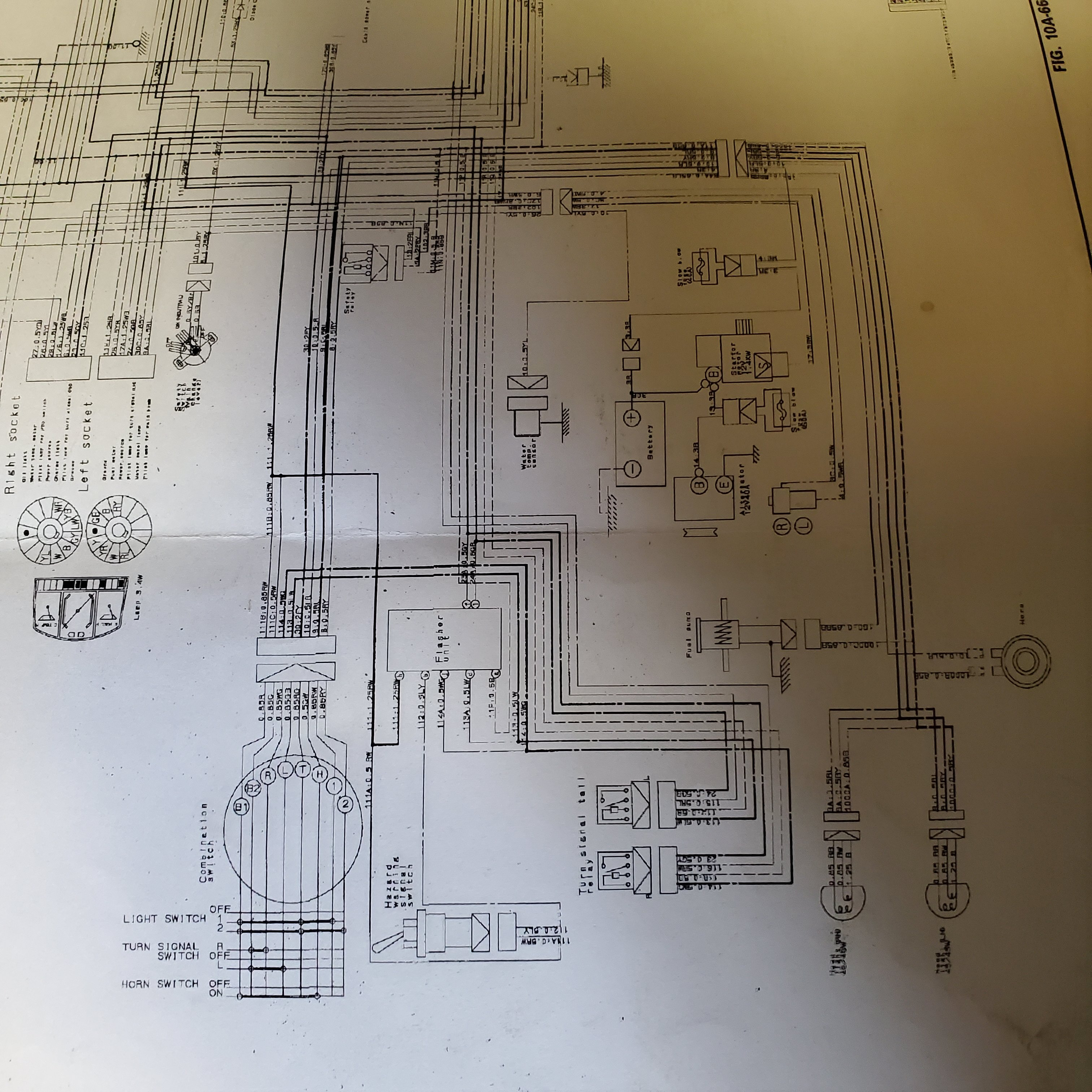

WD

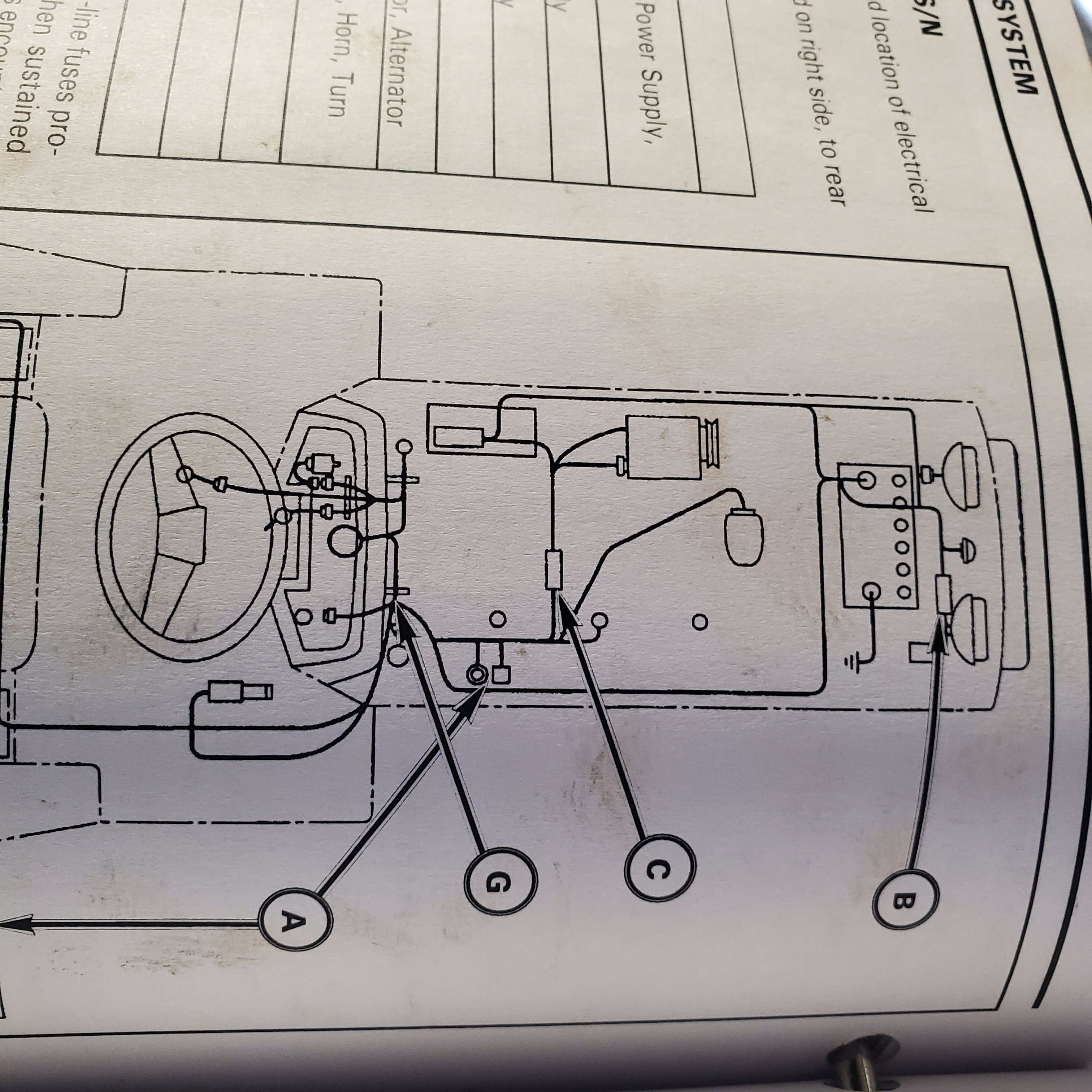

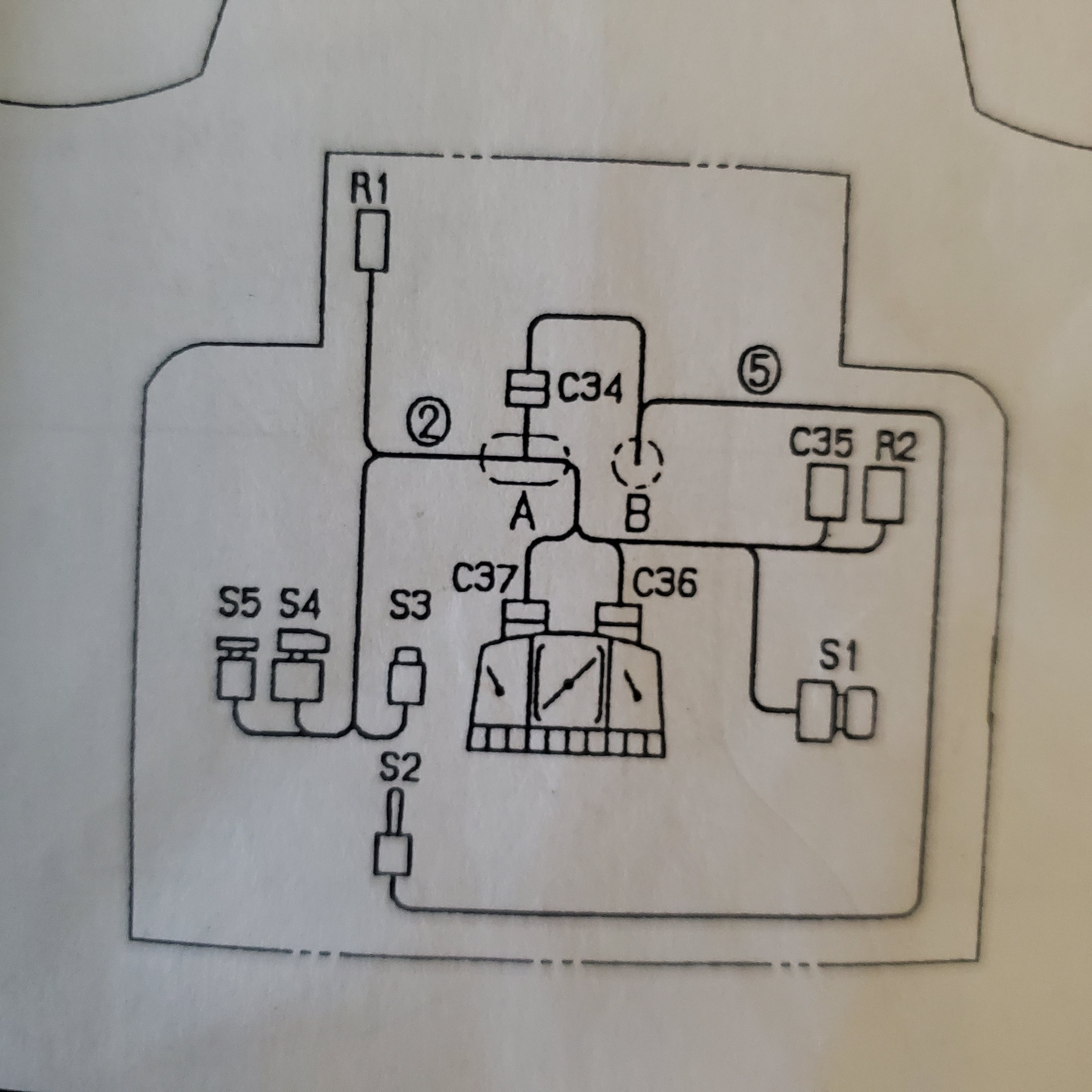

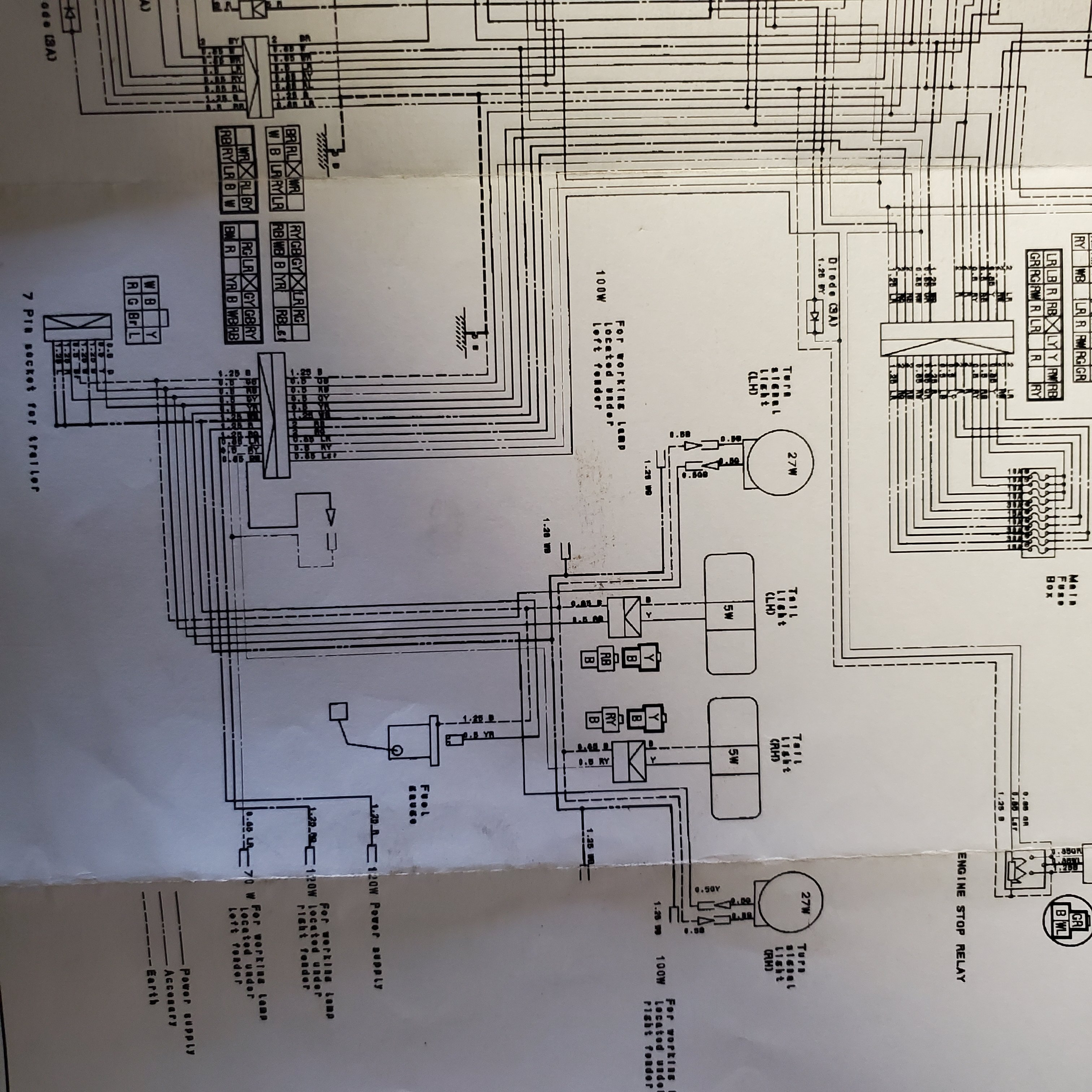

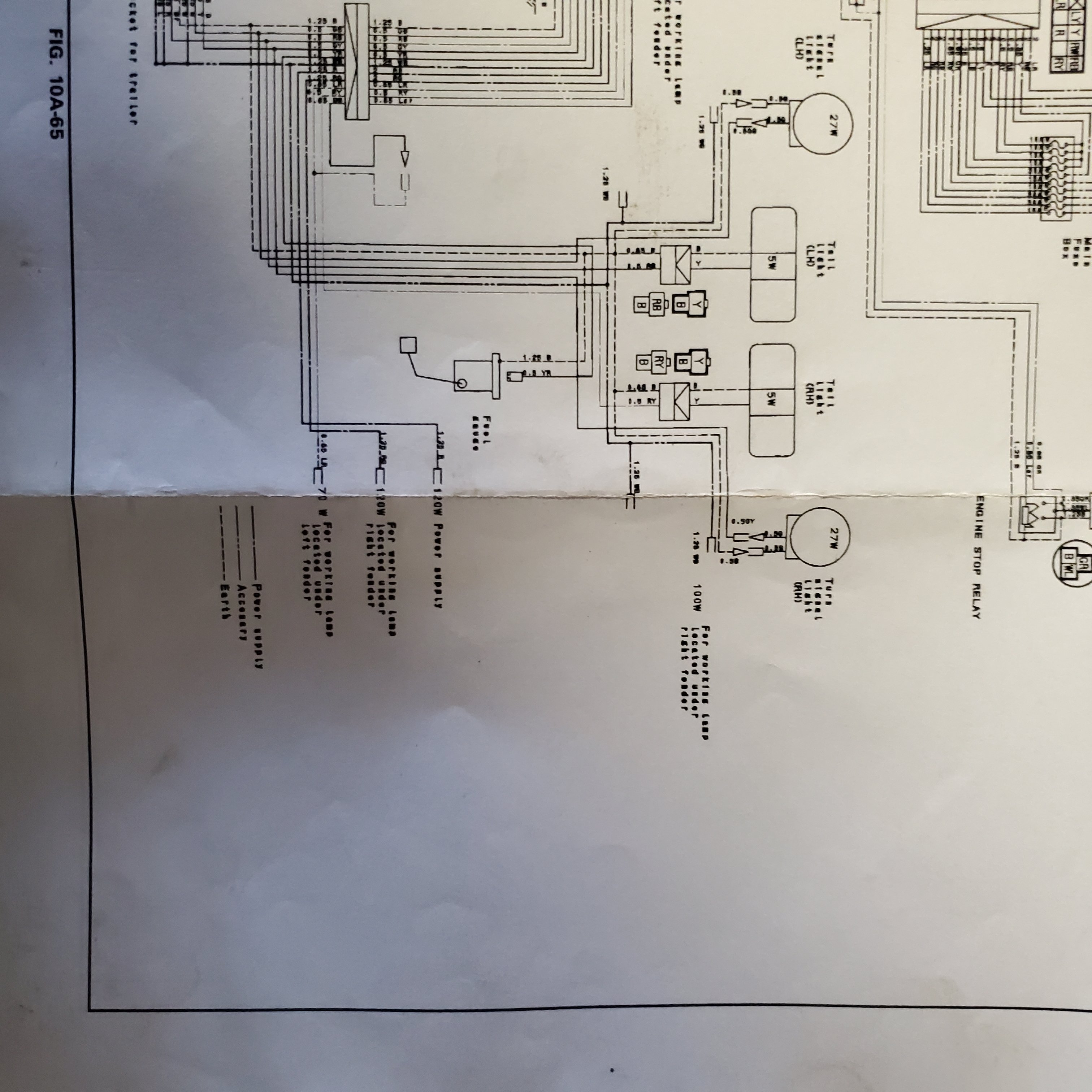

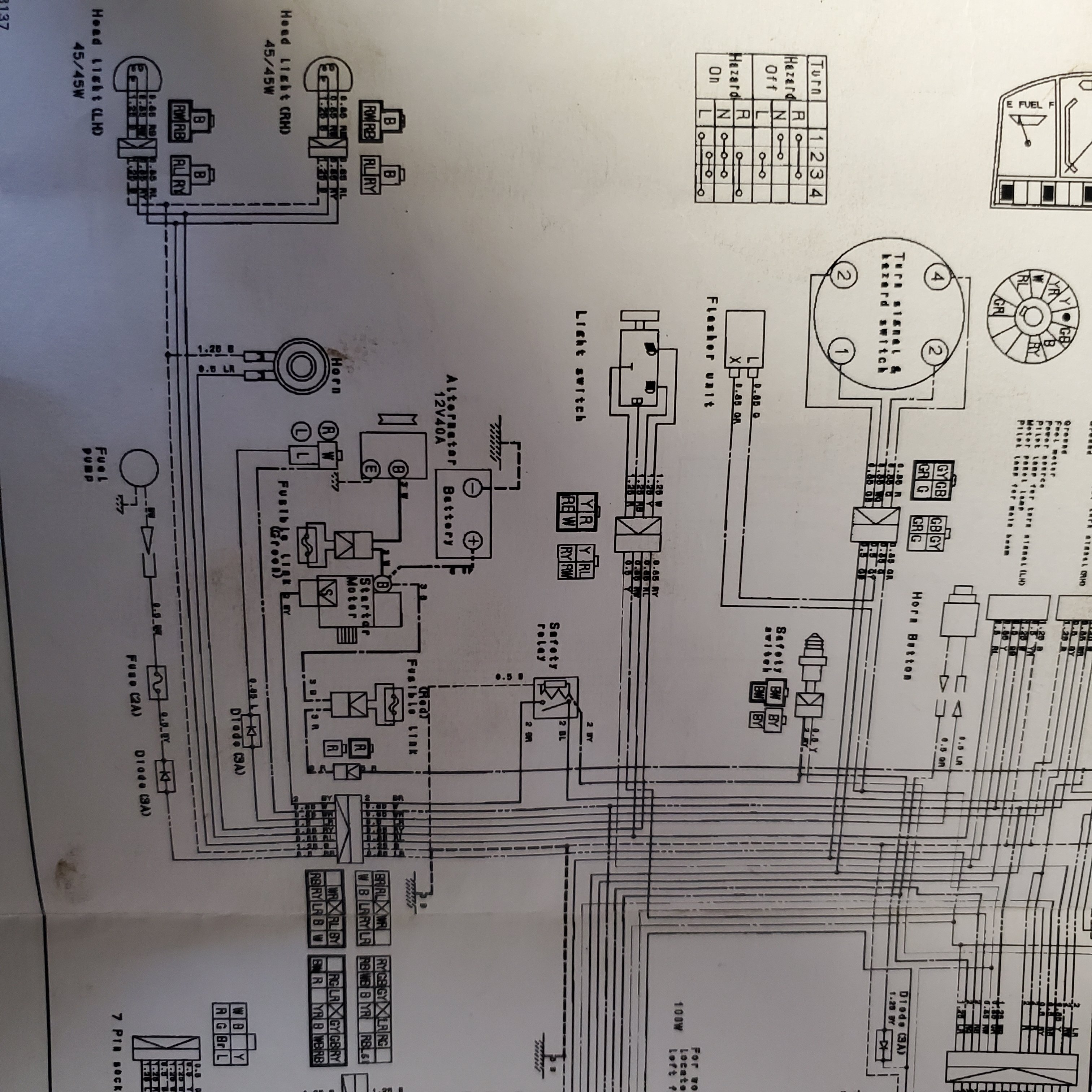

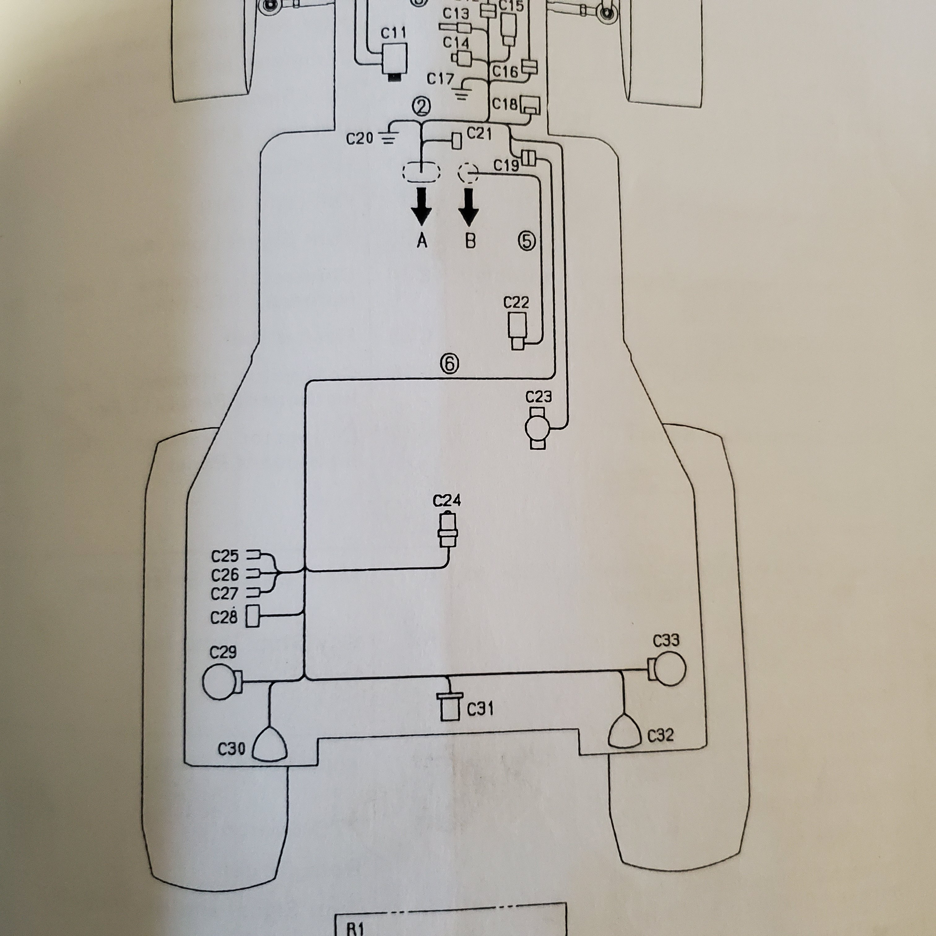

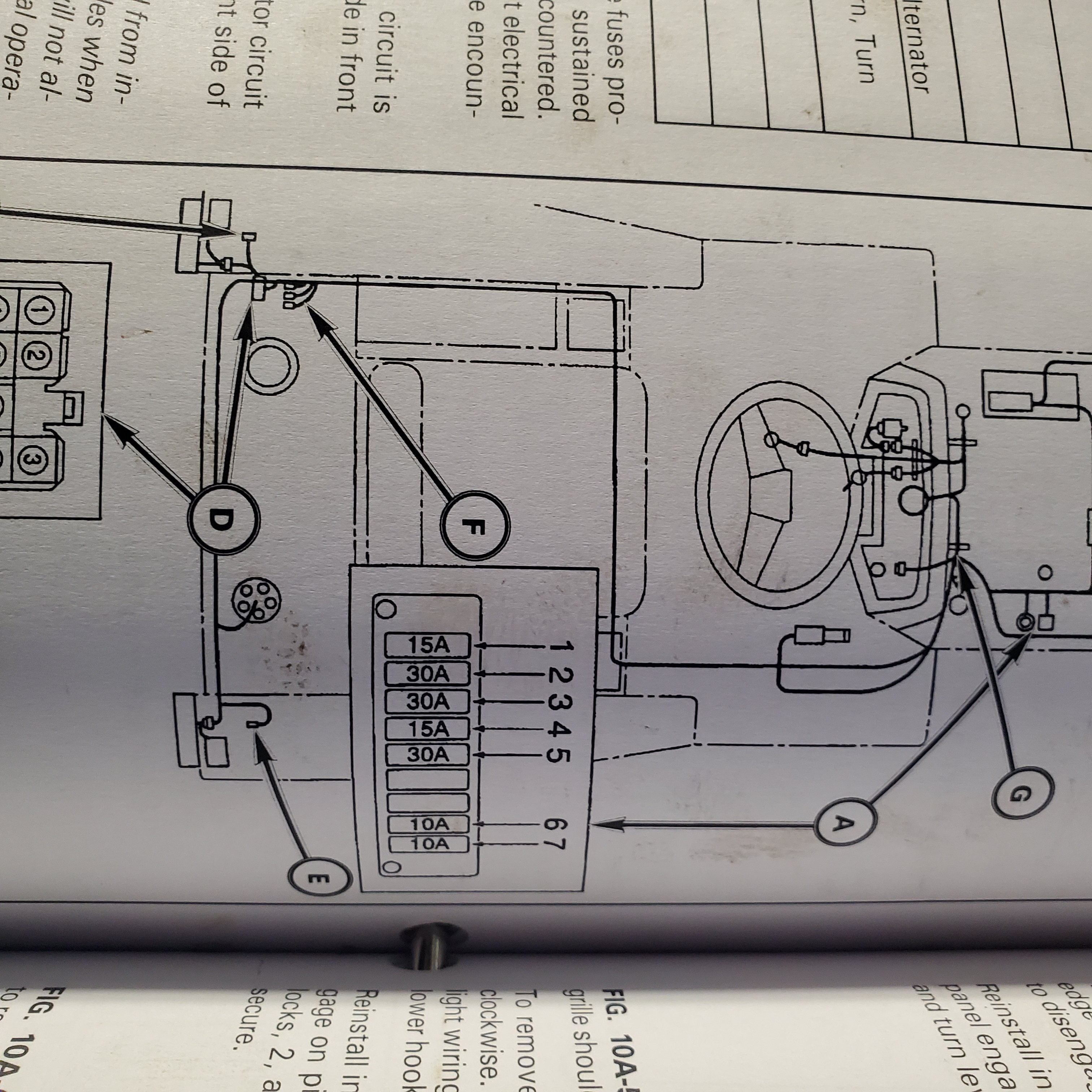

More wd + pics.
First 6 of attch of 1st reply are wd for prior to j s/n, and last 4 are std.
