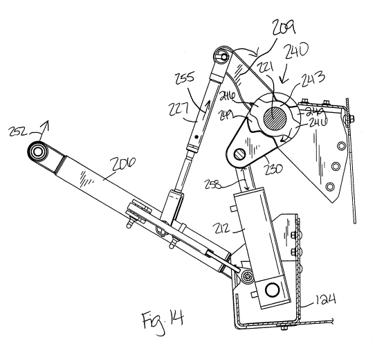

Ok. I read the information on the image and then tried to work it out mentally, (some say thats a challenge for me).
The lifting arms are a fixed length. The link to the arm being lifted is a fixed length. So, with the actual arm doing the lifting at maximum height (rotation upwards) and the link from that arm a fixed length, moving the link position (i.e. the point where the connection arm is attached to the arm that it attached to the device/equipment) inward toward the tractor would seem to force the arm lower. This seems to be because the angle is now less between the hydraulic lifting arm and the actual arm being lifted.
Conversely, if I move the connection point outward on the arm connected to the device/equipment, the angel opens up and the arm connected to the device has to be moved upward to make the new connection.
Taken to the extreme, it would seem if the connecting link (the link between the actual hydraulic lift and the arm being lifted was placed at a horizontal angle, the the arm connected to the equipment would be almost vertical to make the new connection.
Could it be possible that the drawing is in error? Or maybe the drawing is implying just a change in lifting force and not discussing the change in lifting height?
I do understand that moving the connection out might gain more lifting force also (although the rational for that also escapes me). The picture also seems to imply that both arms connecting the hydraulics to the arms being lifted are adjustable. On my tractor only the right hand connect is adjustable. If both were adjustable it might give me the ability to lift the one device high enough but not the sub soiler.
Sometimes I struggle to understand geometrical situations. That's what this is. It's all about triangles.
I'll attempt to clear the confusion. Use your self closing storm door on your house if you have one? If not, use any self closing door, maybe the bathroom door at the tractor supply store.
Push the door open by using the handle. Notice how far you have to move your hand? Notice how much effort is required to open the door?
Now push the door open by placing your hand in the middle of the door. Notice how far you have to move your hand? Notice how much effort is required to open the door?
Now push the door open by placing your hand next to the hinge on the door. Notice how far you have to move your hand? Notice how much effort is required to open the door?
Is it apparent that the method that requires the most amount of hand movement also requires the least effort.
Same thing happens when you move the lift link on the 3pt arm. Go figure..... :)

An excellent description of the issue with weight, force, ect. Just like Archimedes said, "give me a lever long enough and a fulcrum on which to place it and I shall move the world".
What I failed to consider the the fact that not only was the arm a lever but it was an arm. The tractor's hydraulic system rotates the lift arm through a set range or motion, so 20 degrees. Since that range of motion is fixed, no matter where on the lift arm you attach the link, the range of motion is the same. What should change is the point at which the lift starts.

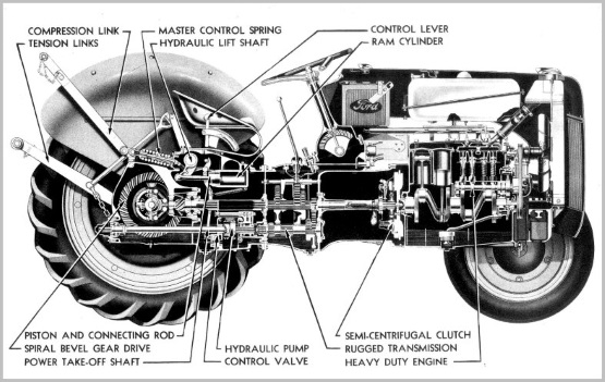

   / MF 1250 - lower lift arms are 27" eye to eye, need to gain about 5" #25
Some side views to help with comprehension.
