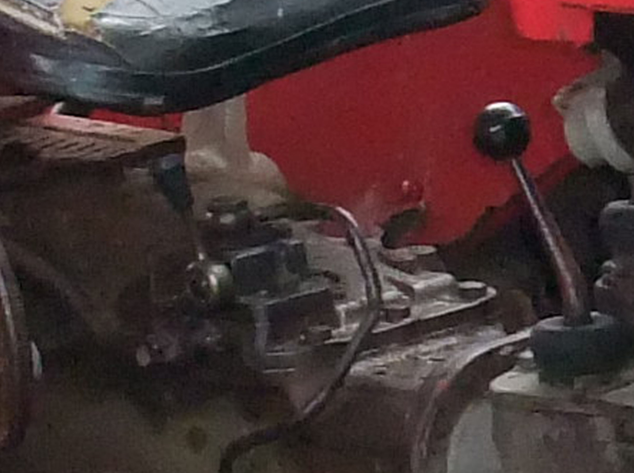

I'm afraid it's right. On my MF35 I had changed the plate under the seat where the hydraulic oil arrives from the pump for a 3 way valve. With the handle forward I could use the FEL, with the handle up I used the 3 pt hitch and with the handle towards the rear I operated the trailer. These were all single effect cylinders, up under pressure and down under their own weight. There was no way I could use the 3 pt and the FEL at the same time for instance.

thanks gents for the guidance, if i added the diverter valve as mentioned by soulasphil and i lifted the bucket by the 3 point hitch then switched to the hydraulic ram and tilted that would the 3 point hitch lower in the process under its natural weight/gravity , ie will the bucket remain in the last position i left it in if i switched the divertor to another point?
Massey Ferguson Hydraulic Diverter Valve
this i think is the diverter i need?
/ MF-135 auxiliary hydraulic? #13
That is not the exact model I had, but the diverter valve on the picture seems perfect for the 135. And yes, when you switch to another position, everything remains in the same position till you switch it back on.

This enlargement is poor quality but it may give a better idea of what my valve was like. The lever is up and the oil flows down the external metal pipe to the loader.
