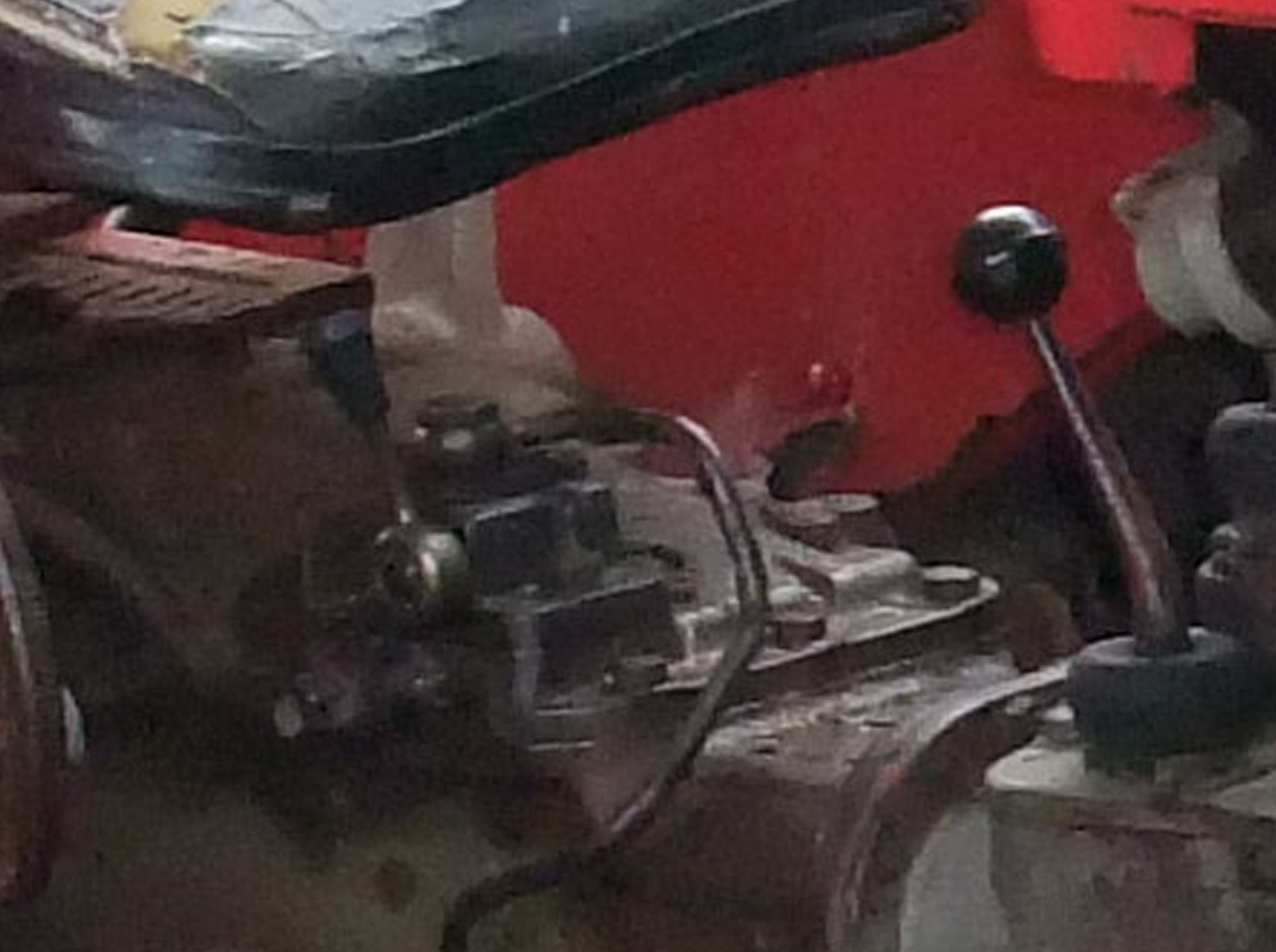

   / MF-135 auxiliary hydraulic? #16
This enlargement is poor quality but it may give a better idea of what my valve was like. The lever is up and the oil flows down the external metal pipe to the loader.

   / MF-135 auxiliary hydraulic? #18
So does the position control lever have to be in the constant pumping position for the diverter to work?
   / MF-135 auxiliary hydraulic? #19
Yes thats correct, you will get some pumping if its just this side of constant pumping but for the full pump put the control in constant, also make sure you move the control back away from this point and a bit more before you change the diverter back to the lift arms position to avoid overloading the internal mechanics o rings etc... you know when you havnt moved it enough as you get a nasty clanking/iratic pumping sound.
