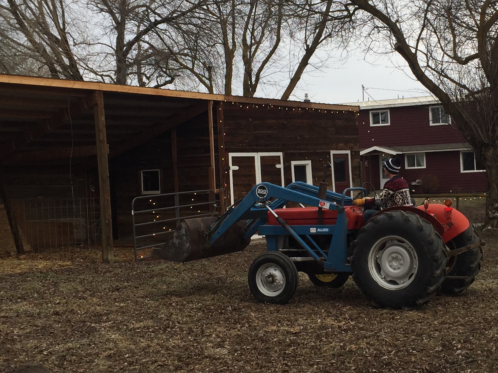

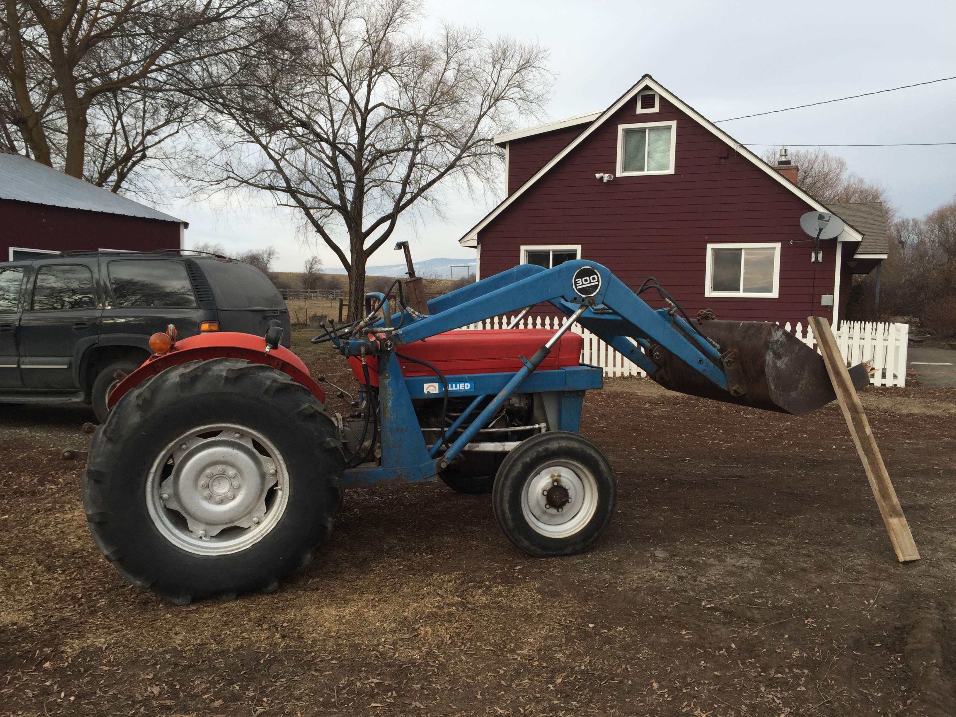

The blue loader hides a lot of the tractor.
   / MF 135 battery not charging, what to do? #14
Looks like an alternator
