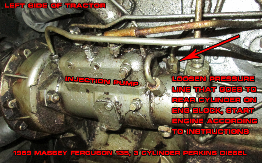

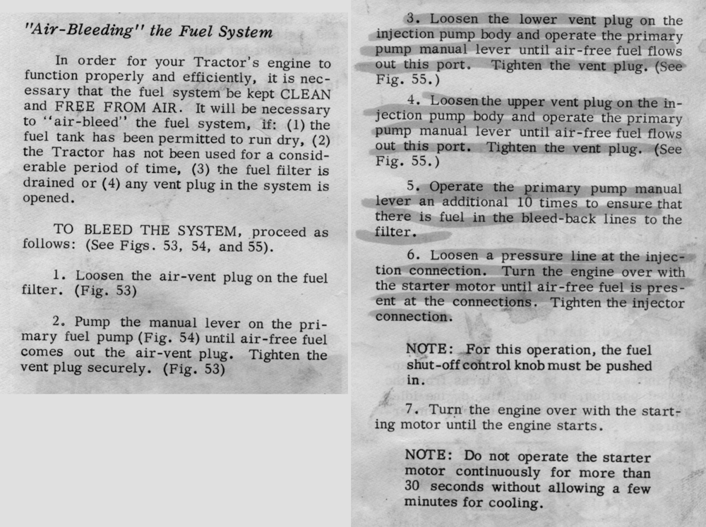

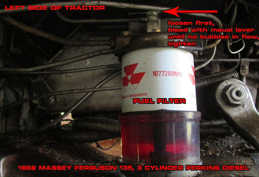

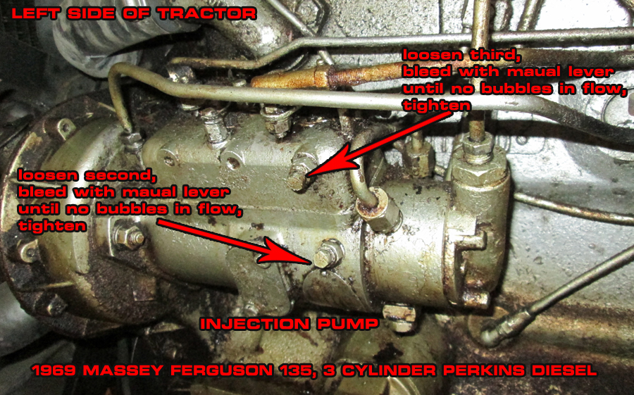

I realize this is an old thread but it really bailed me out. I have a 69 Massey 135, 3 cylinder Perkins diesel.
I am a beginner when working on tractors. I was not replacing filters. I had let the fuel tank run dry.
Thought I'd supply some pics because the ones in the manual were not clear to me especially
loosening a pressure line on the injection pump. As one poster mentioned I only had to do the one that ran to the rear cylinder.
If I had to do the others it would have been difficult to get a wrench on.
I hope the pics are not incorrect or misleading. Thanks for this thread!
