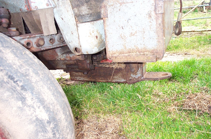

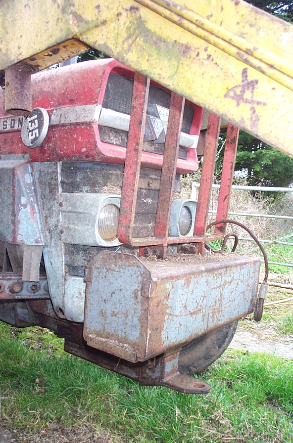

Anyone have a photo showing how the frame that comes with this kit attaches to the tractor?
   / MF-135 front weight kit #2
Heres a couple of pics showing a homemade one, "courtesy of David jp. South Wales from YT". Factory ones mount in a similar manner to the four mounting holes under front end. JJ.
