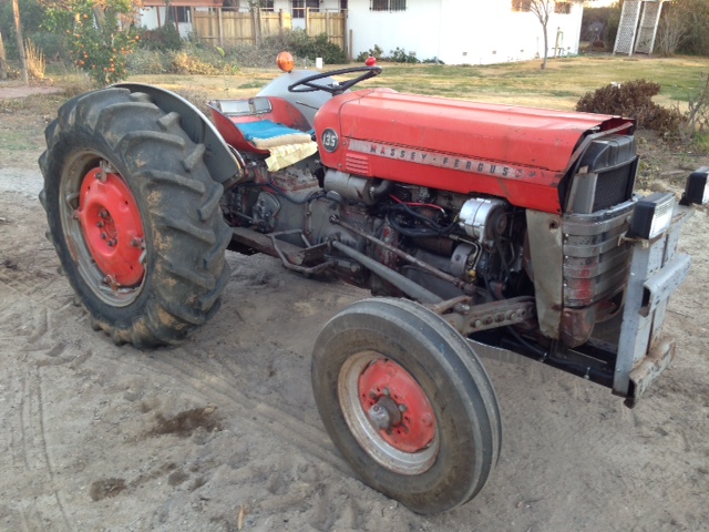

Hi Everyone,
New member here. Bought an old MF 135 along with some used farm implements as a package deal from an older gentleman who is getting a bit too old to use it. I thought I got a decent deal, but after getting home and spending some time with it it's in a bit sadder shape than I had hoped. The oil pressure is pegged at high and once it is warm there is smoke and oil coming out of the crankcase breather tube and the dipstick (and if you unplug the oil filler hole smoke will come out of that too). Oil and filter are fresh and it doesn't seem to be "making" any oil (volume of oil does not rise) leading me to believe at least there is no diesel or water getting into the crankcase. The tractor is not hard to start, even from cold (mid 40's ambient).
I'm not an experienced mechanic, tractor or otherwise, but from what I've been reading here a rebuild might be in order?
I don't have any way to hoist the engine so I'm hoping to avoid having to dis-assemble the front end and removing the engine to do the rebuild. I've seen some "In Frame" rebuild kits for sale, but cannot understand how I can possibly remove the pistons and cylinder liners without taking the engine off. Both the bottom half of the crank case and the cylinder block seem to be stressed members that connect the back end of the tractor with the front. Has anyone used an in frame kit and can you share how it is done?
I have the Agco shop manual, but it isn't exactly a "tractor repair for dummies" level book with detailed instructions, and haven't found step by steps online to give me the confidence to dive in. Any advice would be much appreciated.

Alex that is the only way I ever rebuilt a tractor. Now if you are going to drop the crank you will have to break it apart. Pull the head was how we would pull pistons and sleeves.
Keep in mind a diesel that will start well hot or cold is NOT worn out compression wise in most cases. Many will blow oil out of the slobber tube by design. You might try Rotella 5W-40 T6 Synthetic and change it and filter about every 25 hours for a few times and see if that helps. We did that with our 1976 265 MF with the Perkins engine but it was a good engine after all of those years on dino motor oil.

Thanks Gale for the tips. I'm having a bit of trouble visualizing it, but how do you get at the pistons and sleeves with just the head off? Wouldn't they still be inside the cylinder block? The cylinder block in turn seems to be bolted in the back to the transmission plate, that's the part I can't figure out how to take off without breaking the tractor apart. Right now the tractor spits so much oil from the dipstick once it warms up I have to use a catch pan below to keep leaving oil trails around the field.

The oil pan (could be heavy cast) and head will be removed so you can drive up from the bottom side. Delo 400 is very good oil I understand.
If it was my tractor doing that I would change the oil and filter and add the Archoil 9100 additive or just go with new oil and the cleaner AR2300 see if your rings may be stuck. I am not big on tearing down own tractors that start and run OK. A $1500 rebuild will add little to the resell value but will make it sell faster. We got a lot of life out of just going with new rod bearings, rings and valve job but that was gas engines.
The AR 9100 might unstick your oil pump pressure relief valve IF that is the cause of your high oil pressure. Read about how Archoil is used in huge engines that may hold 100 gallons of motor oil in the crankcase. I just got some AR6200 but it will be warmer weather before I used the diesel tractors to know how much it helps gas/diesel engines. Nano technology sounds interesting to me. :)
Since you are planning a tear down I sure would look at how to get the old engine clean on the inside first just in case it would help with your issues or at least have a clean engine to rebuild. :)

I haven't worked on the diesel version, but I suspect working on the gas version is similar. You can work on the engine, top and bottom, by supporting the tractor at three points; the two rear tires, and a block under the bellhousing or transmission. Then, you remove the front axle and wheels ,steering rods, and front sheet metal. You're left with the engine sticking out the front , with nothing in your way. You can then remove the cast iron oil pan ( structurally, the oil pan is not needed to support the engine at this point) , cylinder head, and if you like, you can then remove the engine (if you need to remove the crankshaft.)

If it has a Perkins AD3-125 diesel in it then the rebuild kits are pretty inexpensive. If you are up to an engine rebuild then it might not break the piggy bank. You will need to figure out what type of rear seal it has to determine the correct kit.
   / MF 135 In Frame Rebuild Advice #9
William TO-35 is correct on this procedure. You can scotch the tires or block up the axles either one. You will need the transmission in neutral as you will be turning the motor over several times, so that is why you scotch or block.
Once you get ready to separate the front end you are looking at 4 bolts going into the oil pan and then two nuts (one on each side) that lock onto studs coming from the frontend section that you are going to roll out of the way. You can attach a standard engine hoist (cherry picker) to the front section to balance it and roll the front away away several feet. I like to give myself enough room to walk between the two as you will be bouncing from side to side. Oil pan will have 4 bolts going into the bell housing that will have to come out. The rest are facing up into the engine block. If that pan has never been off the motor before and it still has the original sealant from the factory you may have to take a BIG punch or bar to break the seal.
I have seen motors do this many times before. Somewhere along the way, rain water got into the pipe and seized or glazed the rings. Put a fresh set of rings in it and some rod bearings and put it back together. You will need to find yourself a hone but not the ones with the long rectangle stones on it as it will be to agressive. I recommend getting one with the small balls on the end of the wires and just giving it a slight clean up of any rust and gunk that you are going to find. A good 1/2" power drill will be good enough to do this. If you cant see any of the hone marked left over, you might and mean cautiously might hit it with a set of stones for a brief second just to put some of the cross hatching hone marks back in it for the rings to make good compression.
If you bought implements to go with this, I figure you plan on using it. Therefore, do the right thing and freshen this tractor up and get many many more good years out of it.
