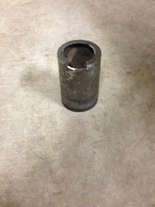

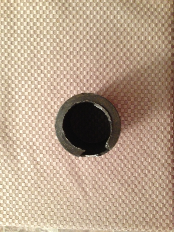

Do you think the shaft cover in the pic is the correct cover? I think my cover is made from aluminum.
I have been finding strange "add ons" to the tractor recently and I am a bit leery of this piece. I have heard (from the local tractor parts dealer) the cover is very hard to find. I have a relative who is a machinist and said this would be easy to make.... But I hate to ask him to make the cover if it is not the correct length, etc.
   / MF 135 original wheel centers #19
Mine narrows at the top so as to hold back a spring that goes over the shelf. I'm assuming the spring helps keep the cover in place and from rattling. Your 135 being a very early version some carryover from the 35 may be used in yours. Your cover doesn't exactly like mine. Mine is aluminum however. Basically it's an appearance and dirt cover. -kid
#20
Funny you mention the spring.... The spring came up in conversation when I was ordering another part for the steering column.... I do not have a spring, but I ordered one from the local parts dealer.
Once the steering column is put back together, I will put the spring and cover on and take a closer look at the fit. THANK YOU!!
Thank you for the information on the correct name of the shaft cover. When I asked the name of the part at the local tractor parts dealer, they did not know either. The only thing they said was it was extremely hard to find, if I could find one.
