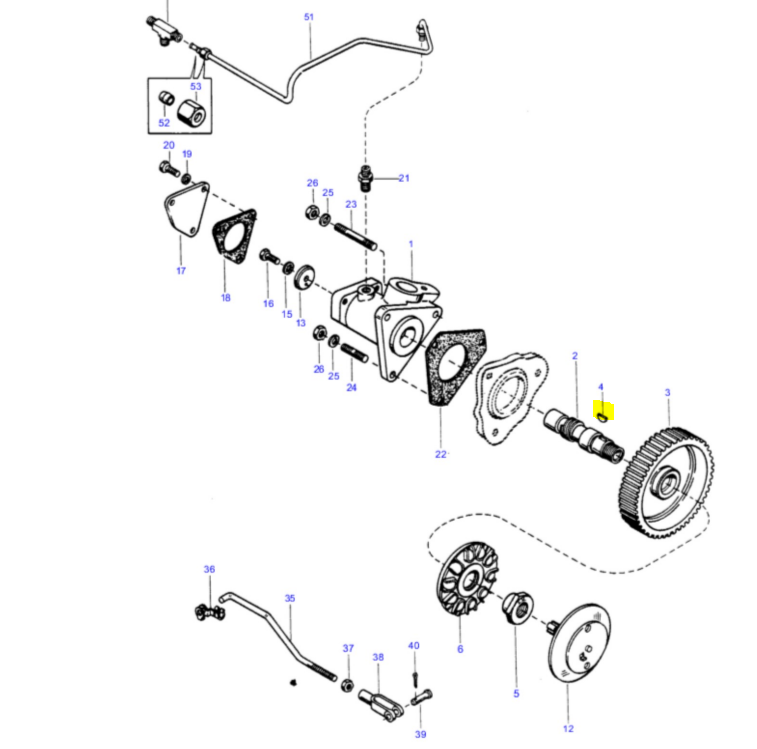

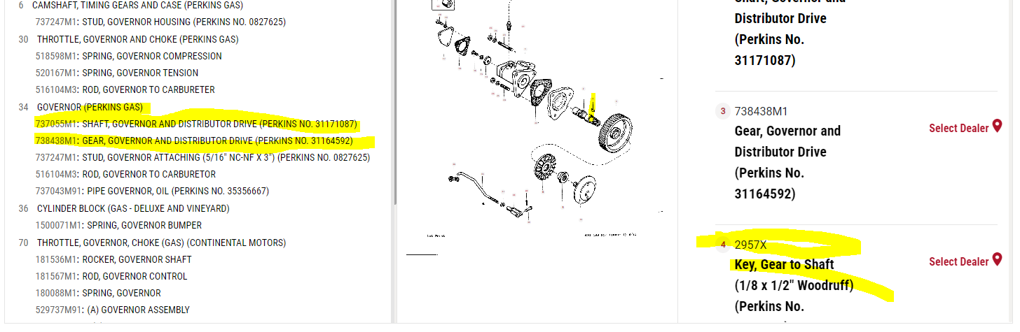

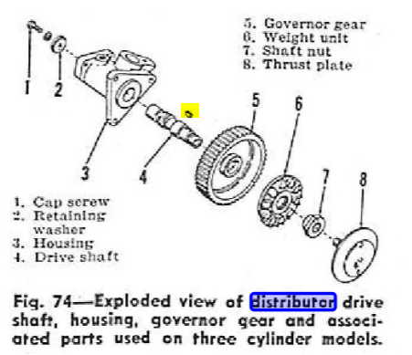

I went out and put my hands on stuff and I am starting to get it. I looked through my parts and I believe I am missing one part and working on getting the shaft, I don't think I ever have it and it could be why this whole issues happened in the first place.
In the picture below I am missing the highlighted part.
The AGCO Website shows the part and part number under Perkins (Gas) and there are two pictures, both with the same picture

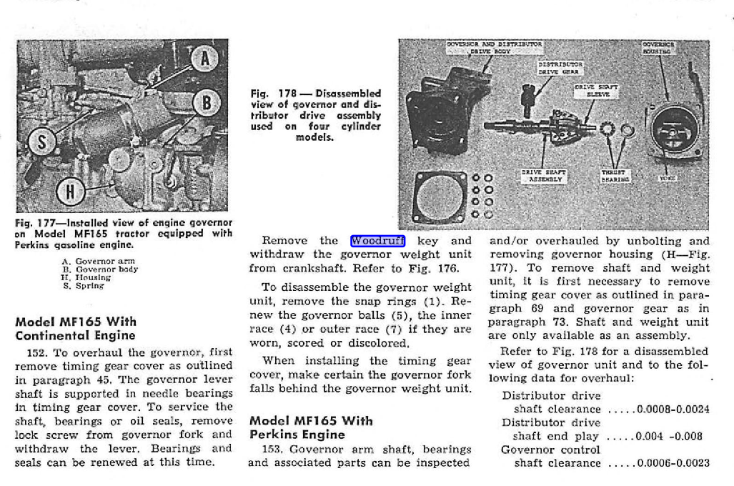

Looking at the shop manual the only place I find an entry for the Woodruff Key is for the Continental Gas 165
Do I order it then? If I do, how to I use it?
Thank You!
Stuart

Well, if you are missing a woodruff key then you are in luck. They are a standard item available at any good hardware store. In case you are not familiar with them they are basically a half moon shape. Because they were standardized decades ago there should be no problem getting the one that fits your shaft. Also, because the sizes were standardized you can bring your shaft to the hardware store or good auto parts store and easily find the proper sized one. It will fit snugly in the slot if the slot is not worn. It will protrude above the shaft about the same as the thickness of the key. It should fill the slot and not slide back and forth. It will rock in the slot because it is circular in shape.

According to the AGO parts book the woodruff key part number and size is 2957X (1/8 x 1/2" Woodruff) (Perkins No. 0500003) Local dealer shows the price of $4.29.
Personally, don't know that I'd get one from a dealer, but neither would I get one from a local hardware. The tensile strength varies so much on these I'd much rather spend a couple bucks for one through NAPA then to have the same problem again. An 1/8" key isn't very thick so I'd opt for one from NAPA etc.
I'd look for, or if you know the person behind the counter has a little knowledge/experience, that's the one I'd go to, and tell him/them what it's for. If they have different grades of them, they should be able to get you the correct one. JMO, take it for what it's worth.

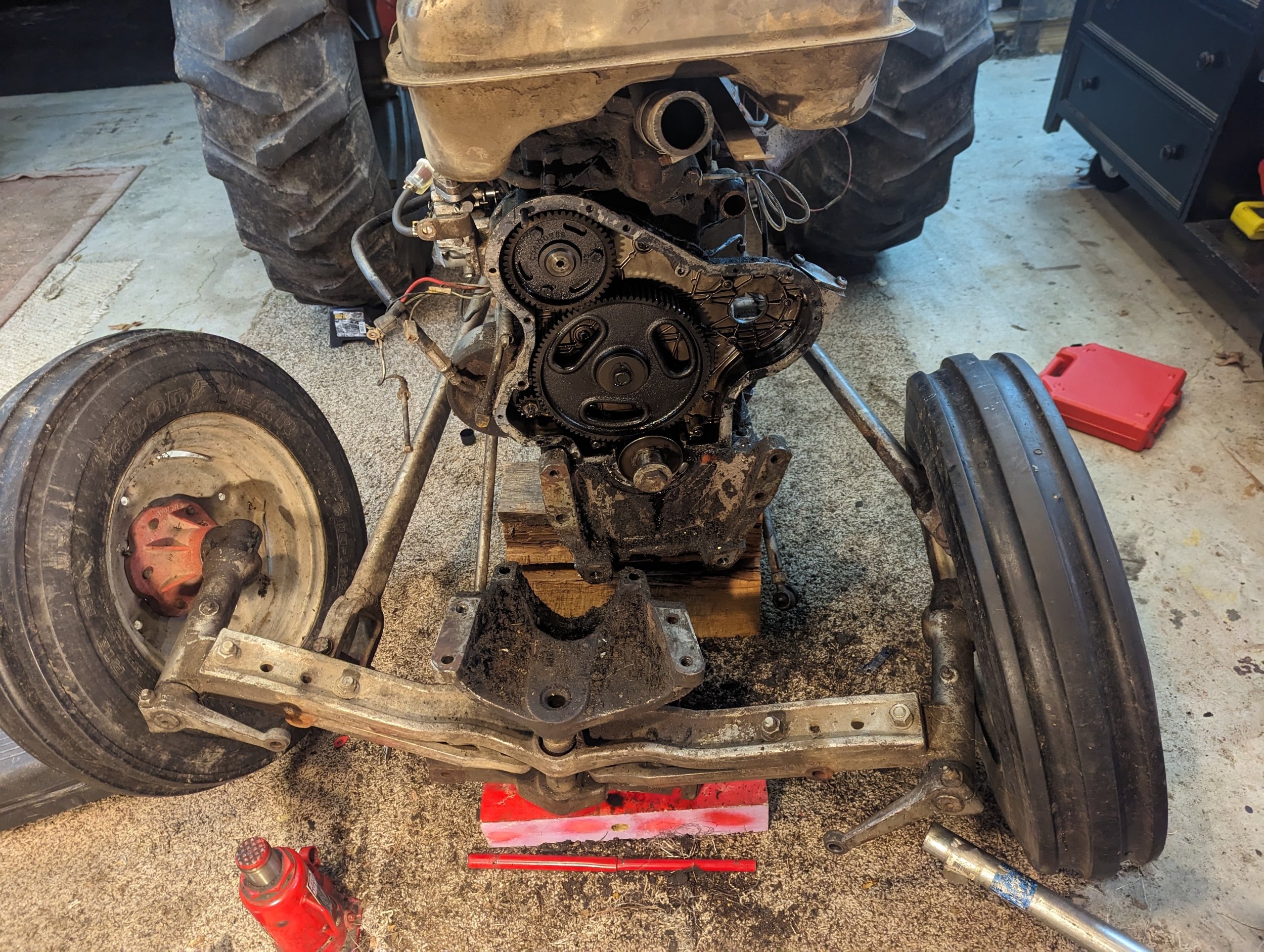

If you look at your video on page 6 where you finally got the shaft out, it looks like the key is still in the shaft. It should fit into a slot in the timing gear. Take another look at your old shaft and see if it's in there still.
If the new shaft doesn't have a key when you get it, you can get one at any number of places as already mentioned.
RE: finding top dead center, remember the piston is at the top for both a compression stroke and an exhaust stroke. It's possible to be 180 degrees off, so take your time and double check.
Glad it looks like you can start to turn a corner!
But the exhaust stroke won't push your finger out of the spark plug hole. See post #70.
   / MF 135 Perkins Gas 3 Cylinder Backfiring no Power #78
Very good point! I was more thinking if he was just using the screwdriver to watch the motion of the piston, it would be possible to get out of phase.

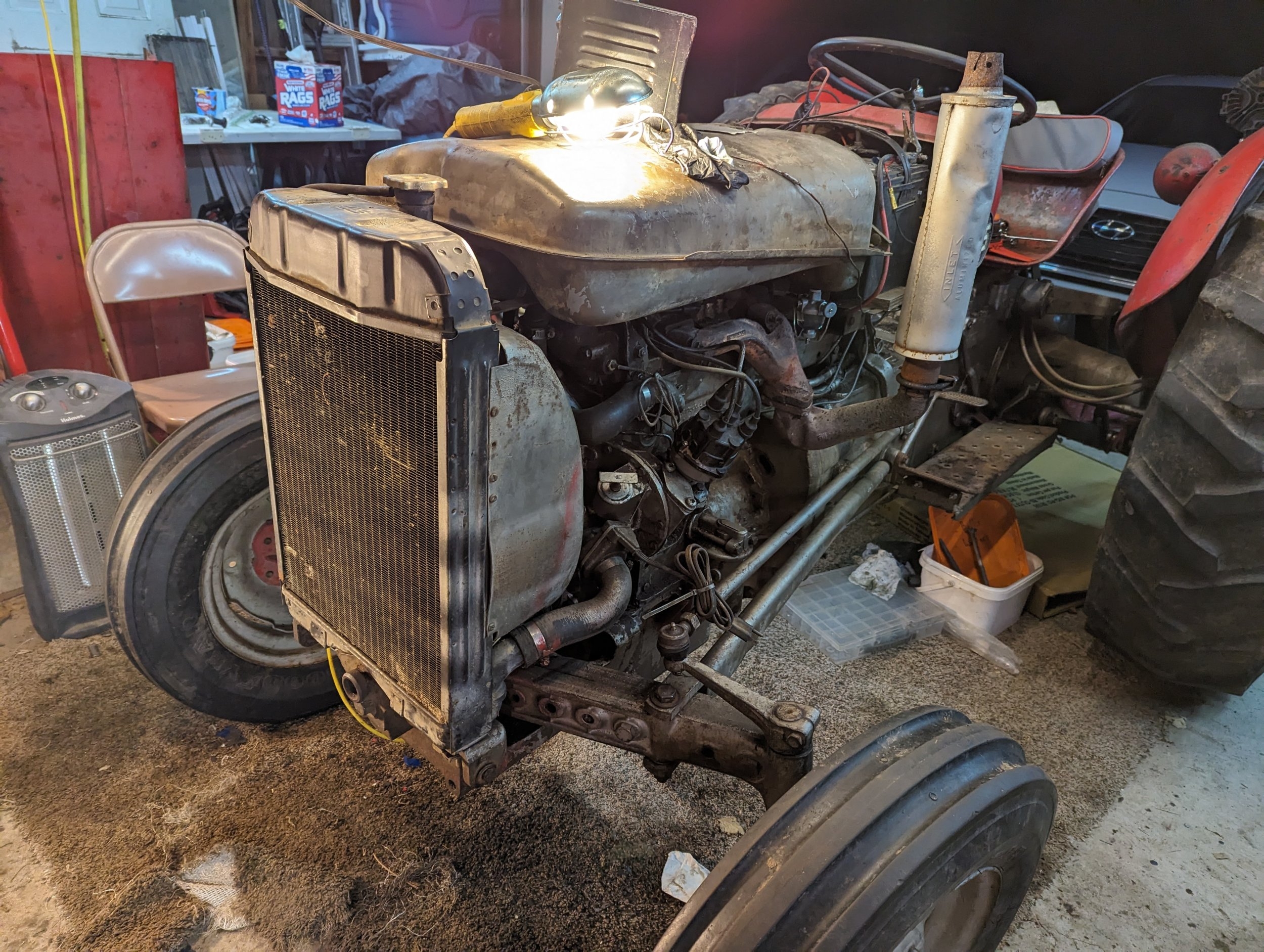

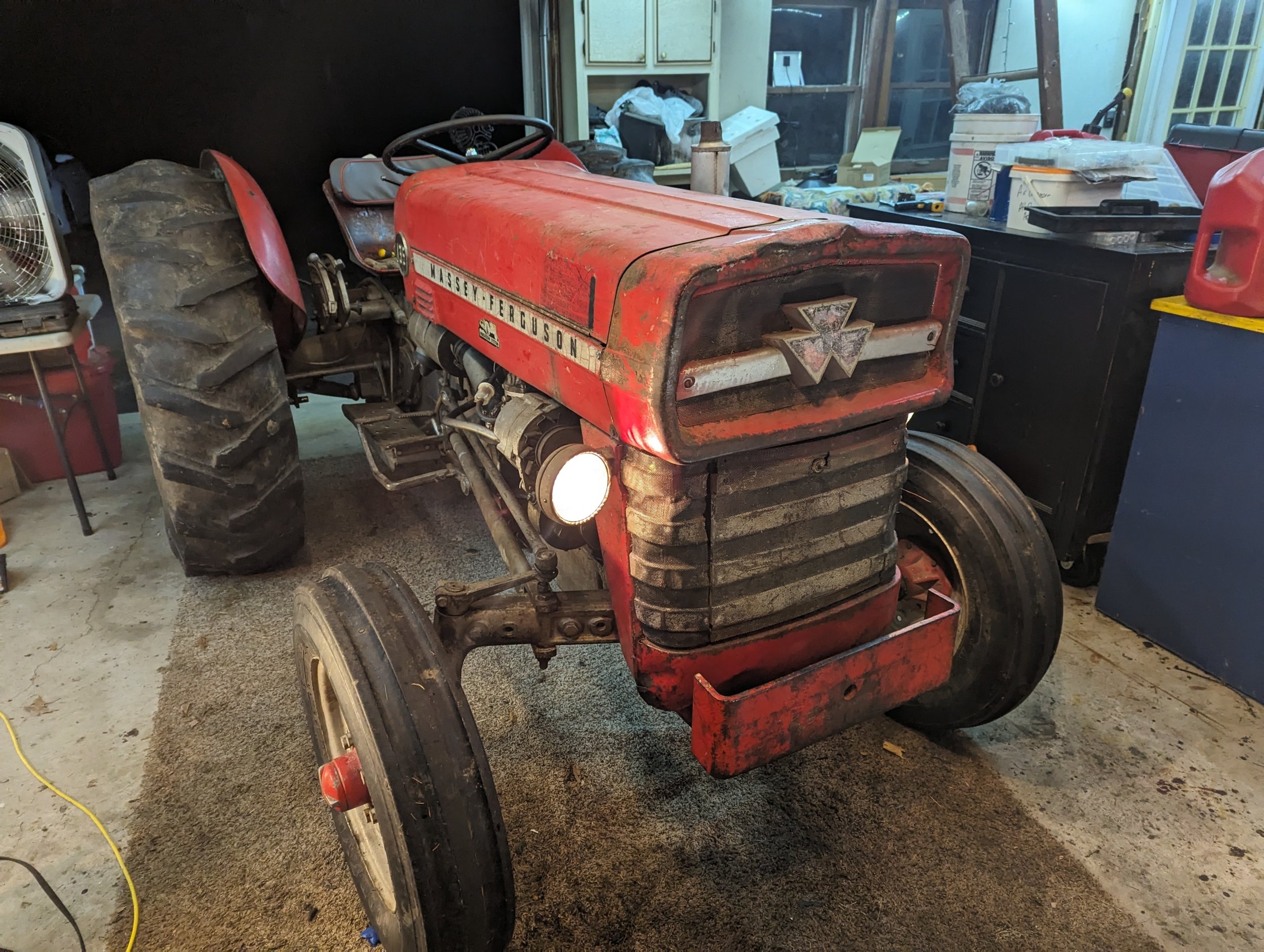

Well, it took about 22 hours of work and I might have put things on and taken them off more than three times, but she is all back together and working. Pushed some snow on Saturday even! Thanks to all of you for all the help! I couldn't have done it with you all.
Stuart
