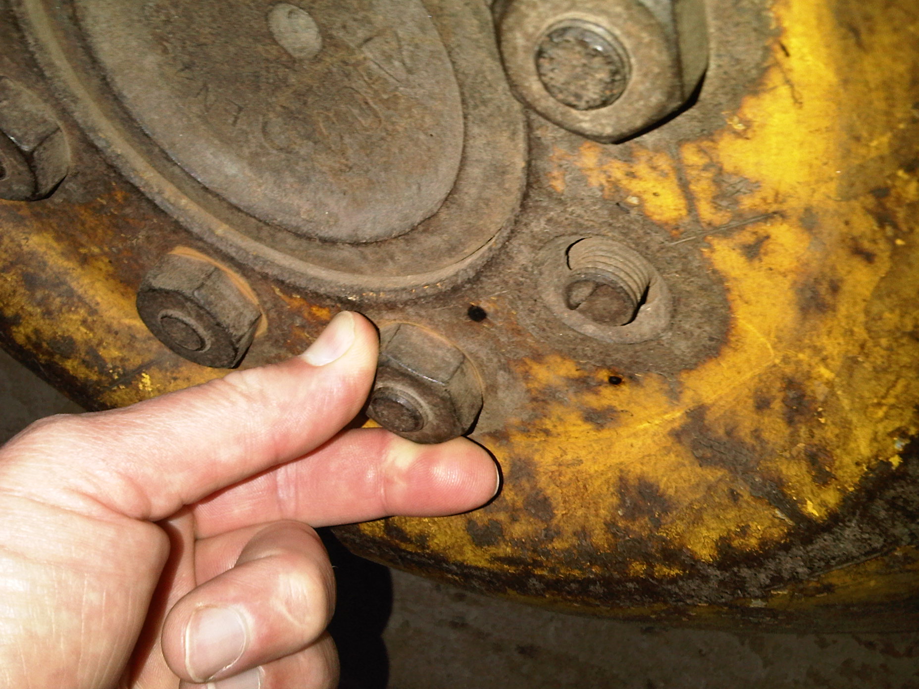

Sorry to disagree but the cutter/grinder will work, if you cut as in the picture, without gouging the Rim. You then use a chisel and hammer to break whatever part of the nut you cannot reach with the cutting disk. And there is another way as well, just thought of it, you could drill into the nut and then use a chisel and hammer to break it open. Recently used just a chisel and hammer to cut all the way through a 15/16 inch nut holding a gearbox to a bushhog, did not take very long, just trying to ease the work load with the cutting or drilling technique.
Good luck Mikescilly you can do it.
Billy
ps sorry that I did not give better instructions in the first post, let us know how it turns out. K?

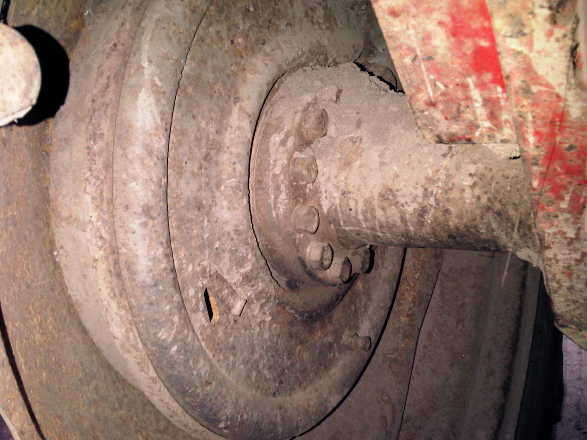

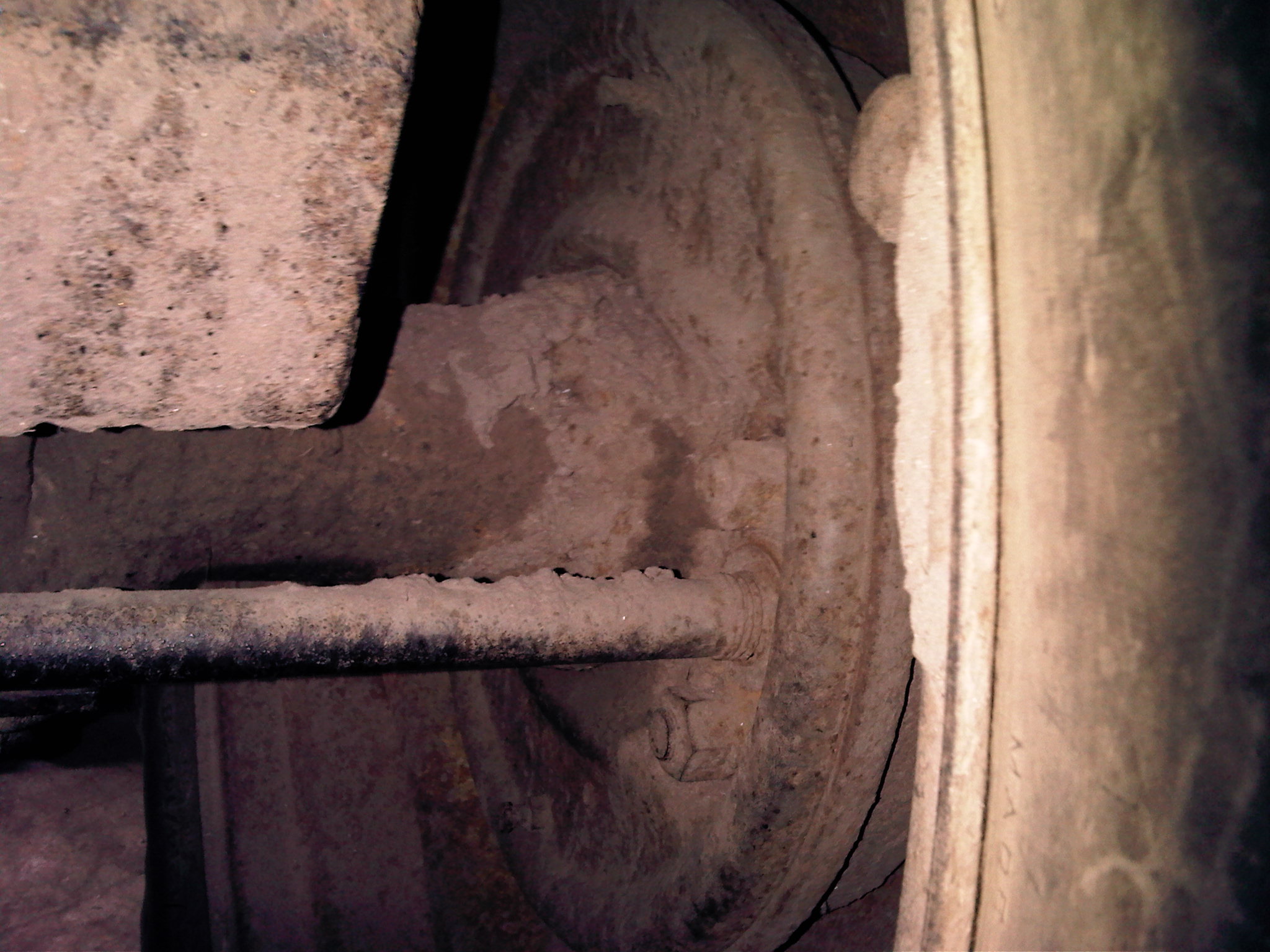

Thanks for the ideas guys.
Here's some pictures which should give a better idea, you can see that it looks as if it can't be done from inside.

Just to elaborate on what MUR 386 was saying about using a drill.This sounds like the best solution for you.Use a drill bit just a bit bigger then the stud eg.If the wheel stud is 1/2" then use a 9/16" drill bit to drill through the center of the stud all the way into and through the nut.The nut will basically fall right off once you've drilled through it.This way you won't be damaging the rim's tapered hole at all.Us a good sharp drill bit and it won't take long.If the stud & nut want to turn while your drilling just use a set of vise grips to hole the nut,this way both your hands are free for handling the drill.I've removed nuts this way before.Larry
   / MF 135 rear wheel studs #15
Thanks for the pictures , it is totally different to my neighbours tractor .
The nuts could in fact be drilled on either side and split with a chisel as said , or they could be heated cherry red and quenched with cold water and undone with a 1/2" rattle gun . After quenching they would undo easily , or if you just want to keep it going a bit longer you probably could also re-tighten them with this method .
   / MF 135 rear wheel studs #16
As the stud is spining, heating and cooling wont help. Drilling or grinding a slot and then using a cold chisel should crack the nut off. That is one rusty 135. Has it been sitting outside? Mines plowed snow in Canada for 40 years and I had no issues removing the drums when I got if a couple of years ago.

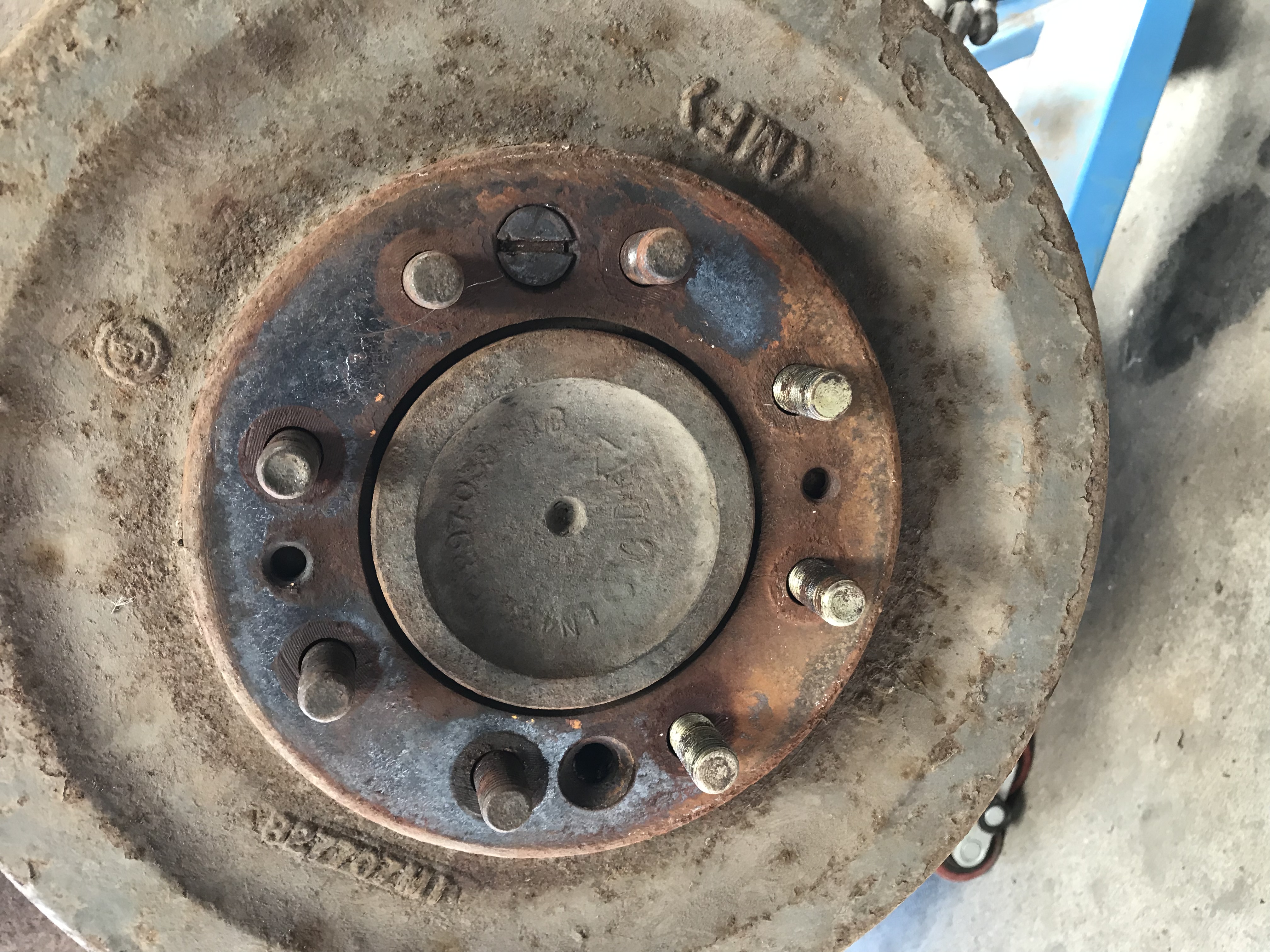

Well it took nearly nine years but I finally did the job today, drilled out an inch into studs, cut into the nuts and a couple of whacks with a hammer smashed of the nuts.F9997F0C-A049-4AFF-A262-D355048AF835.jpeg0A20AC8E-0183-4162-9791-2CC46ED25721.jpeg1162AFBB-B831-4566-980E-78E294882B8E.jpeg305FB1DD-49DE-4D65-9ACE-67058F504A20.jpeg
   / MF 135 rear wheel studs #18
Hi Mike, good to see your tractor is a "twin-sister" to ours! I'm glad you got them off. That's the way I'd have done it too!
Before you reassemble it all, as my late father instructed me in 1981, regarding what was then his tractor, do this:
Lightly grease the threads of the studs, but not the ribbed portion.
Pull the studs into their holes as previously described.
Then coat all the remaining exposed surface of the studs with grease.
Also, lightly coat the axle flange - the brake drum mating surface.
Refit the drum, remember to grease the screw's thread too, then grease the wheel-mating surface of the brake drum.
Fit the wheel but try to keep the tapered holes clean and dry - this helps keep the nuts tight.
Check them a few times, tighten them all a little further if any have come loose, but don't over-tighten them.

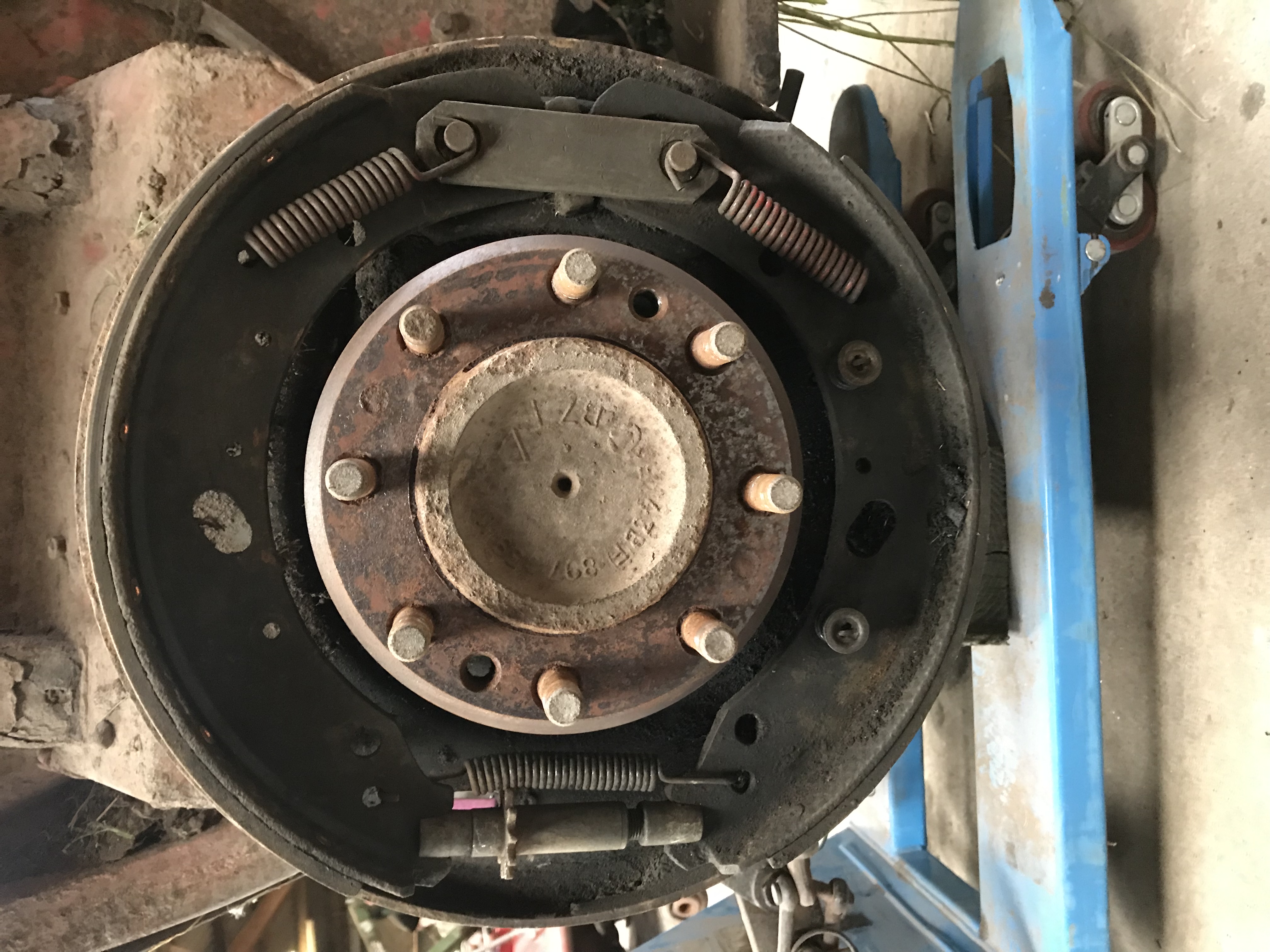

You can imagine my appreciation of that advice after I needed to remove one rear wheel a couple years ago ... and found they all has stayed tight - but unscrewed quite willingly - after around 35 years! THAT is how we look after these wonderful old machines who are all still working happily!
#19
Hi Patrick,
Many thanks for your advice.
I've taken the opportunity to clean up the drums & shoe surfaces and all around there, some of the shoe retainers were missing, they have arrived and will be fitted.
