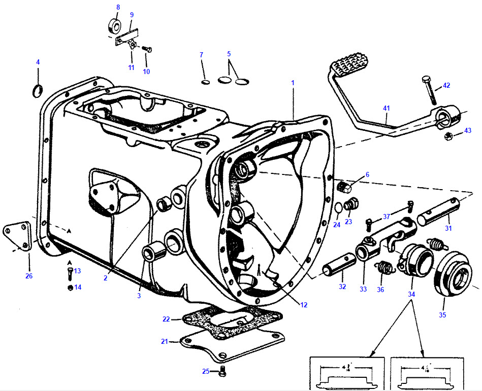

Without knowing the specifics of your tractor (transmission type) it's hard to say what's going on, especially since I'm unfamiliar with the 135 although it shares many details with the 35 it seems. Here is a picture from agco parts book online. (type agco parts into google and it should be your first link). Check everything that spins on that clutch pedal cross shaft. You can also see #21, which is the four-bolt bottom plate I mentioned earlier. Maybe this will give you a jumpstart. Good luck!

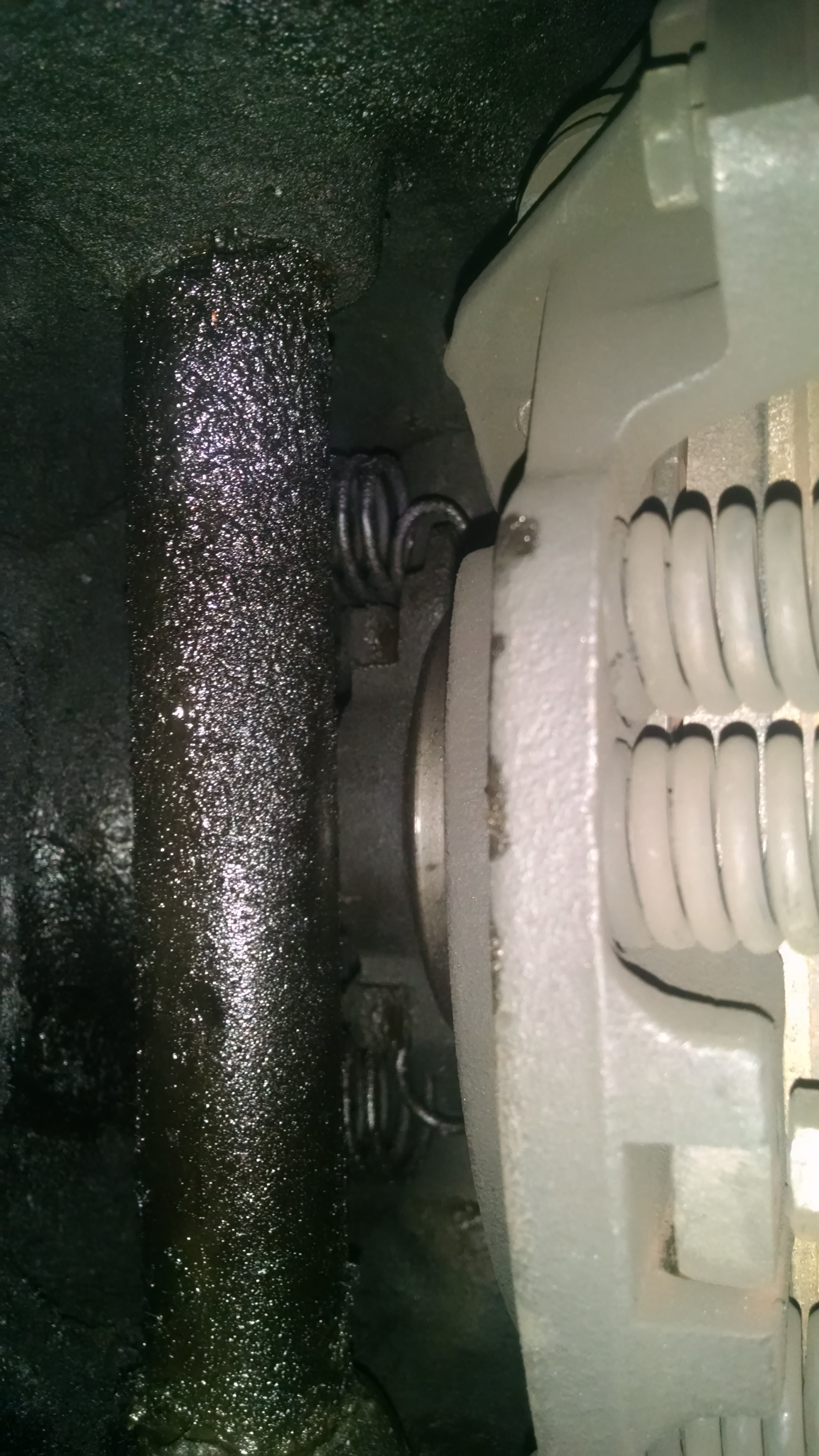

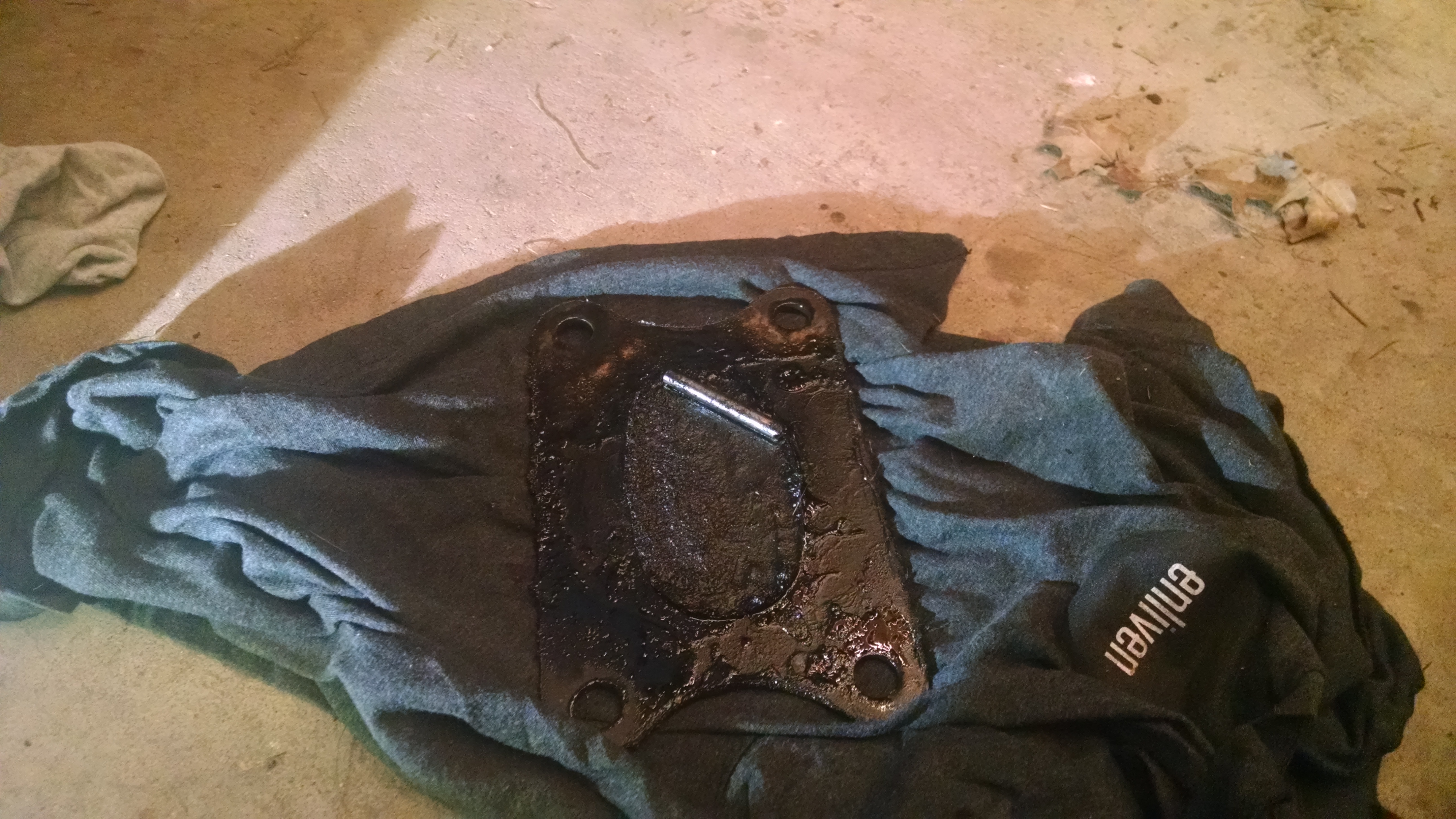

I took off the access panel last night and what I found was some sort of shaft broken laying on the panel. I had my wife step on the clutch and the plate is moving when the clutch is pressed but doesn't seem to travel near far enough into it. It certainly never compresses. I need to look at diagrams with the name on it so I can better describe what is going on. I don't know what the shaft is or where it belongs but I suspect it is my issue. I am attaching issues of the shaft along with a picture looking into the opening when I removed the pressure plate. Thoughts?

That looks like a pin from one of the clutch levers. I think your going to have to split the tractor and check it out.
Also looks like you have an oil leak, there shouldn't be nearly that much oil and grime in there.
Get hold of a good manual, its not that hard to split the tractor, aligning the clutch plates when you put it back can be a pain though.

Been a while since I fooled with one, but the pto clutch has to be adjusted at the pressure plate. Not sure what is going on with trans. clutch,possibly the pin in your pic. came from the pressure plate and locked up a release lever. splitting tractor is your next step.

Yep. Once you start finding parts at the bottom of the clutch housing, then you have a tractor splitting job in your future.
