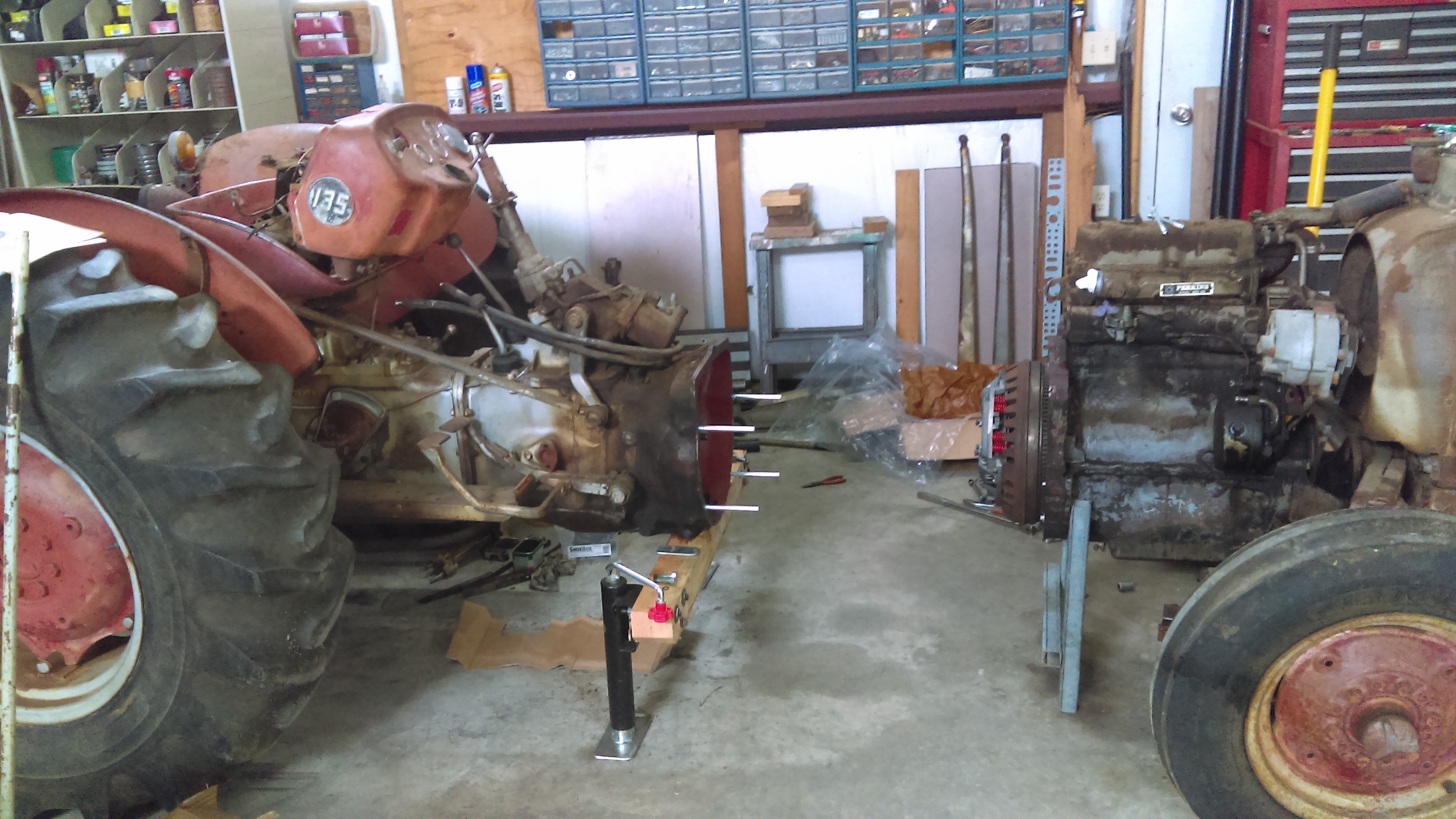

I appreciate everyone's thought. My plan is to split it and see what I have inside going on. Then at the point order new parts, seals, etc. The more I read about the split the less I am concerned about it. I have a 2.5 ton jack, is that enough to roll the back end half away from the front safely?

G'day your jack should be plenty big enough but why not roll the front away I have always found it so much easier to move the front than the back end.

The video I watched showed rolling the back away, but either direction is fine with me.

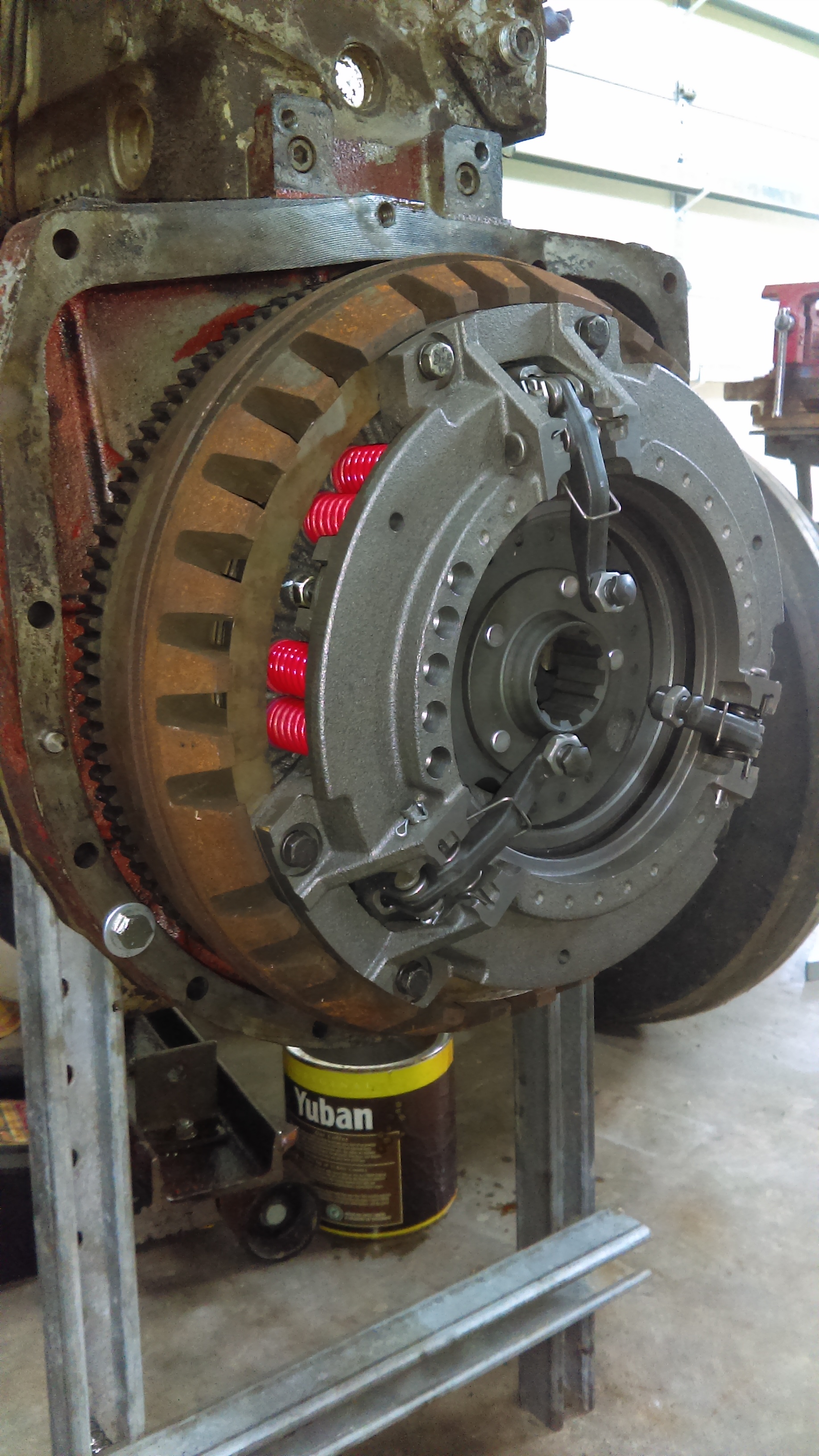

I'm in the final staging of getting my 1968 MF135 back together after splitting it for a clutch replacement. Some tips: get it as clean as possible before starting the split; take pics as you remove stuff to help remember where things go; plug all the fuel lines as soon as disconnecting (heater hose with bolts fitted inside works); check the settings on the new clutch - mine needed adjustment of both the release finger screws and the PTO clutch release screws. I used engine cleaner to remove a heavy layer of gunk inside the bell housing - quite messy but the results look good. I hope the new seals take care of the leaks. I was about to connect the fuel lines to the injection pump last night, but I think there are pieces of the rubber sleeve down in the inlet, so I will try to vacuum them out first.

Good tips. I am surprise to see you took it so far apart. It seems like I could just remove the bolts around the clutch and that would do it, but yours in pieces is that necessary?
   / MF 135 - Two Stage Clutch... More like a NO STAGE CLUTCH #18
I needed room to get right up to the clutch assembly to handle it - quite heavy. Also needed to remove the trans PTO input shaft to replace the seals and clean everything up. It was a lot easier to work by getting between the 2 halves instead of from the sides.
