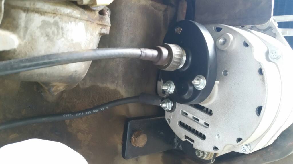

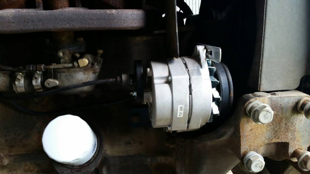

Holy old thread batman......so the generator crapped out again. It made me mad enough that I searched harder this time and found my unicorn.......An alternator with tach that works for a massey ferguson 150. I googled for alternator conversions and started sending emails. All but one responded with a NOPE, sorry, good luck. I won't say the name since I don't think they're an advertiser on the site. The technical support gentleman was extremely helpful and was actually a former Massey tech in the 1980's and was familiar with the MF150. He was working on this alternator as a "side" project and asked me to count the gears on the generator tach drive to ensure compatibility. I counted gears and sent him pics. He responded with this particular alternator that the gears matched perfectly. He recommended I put the pulley from the generator onto the alternator to keep the same ratios, which I did.
I had a local welder make the bottom bracket and I made the top strap using a drill and grinder. Years ago Dad had the TO35 converted to 12 volt but didn't keep the tach. I removed that bracket and used it as a pattern (slightly adjusted the holes to clear both the frame and heat shield). I Used a 6 gauge wire since the store was out of 8 and 10. I crimped the ends, put some solder in the ends, and covered with heat shrink tubing. I had to take the tach cable and reroute it around the throttle linkage to get an extra inch out of it. AND IT WORKS PERFECTLY! Gauges, tach and all. I spent $144 on the alternator (delivered), $10 on the welded bracket, $5 for the top strap, $1 for a thin grinder wheel, $6 for the wire, $3 for a pack of electrical ends, $8 for heat shrink tubing, and $.3 for bolts/nuts/washers, and $18 for a new belt. But most importantly....no more !@#$%^%^&*(@#$@!#$%^&() generator and that's worth a fortune.
I did not run an "exciter" wire. Usually when I operate a tractor it's running at close to PTO speed and long enough to recharge the battery. I didn't see the point in doing it. It works fine for me and for how I'll be using the tractor.
