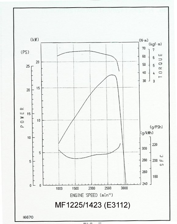

Here is the torque curve for the MF1225/1423.

Thanks Jerry ! /forums/images/graemlins/laugh.gif
