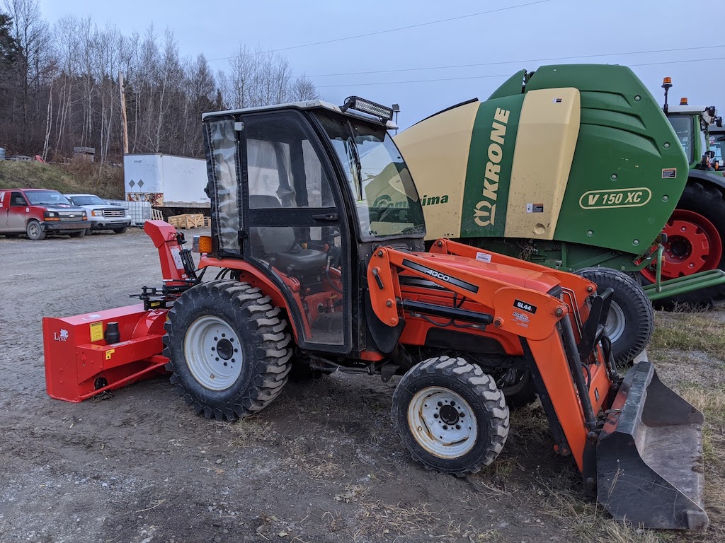

Hey MF folks! I'm looking to buy a Agco ST28A (same as MF 1528), a 2007 with 1400 hours. This is going to be for personal usage on the week-end at the cottage: snow removal, firewood duties, gravel road maintenance, etc. I've searched on this forum and I don't see much complains about the tractor (except that guy who trashed his front diff).
Are they good tractors? Reliable? What should I look for (other than the obvious checkpoints)? Any personal experience on owning and operating this tractor after 1000 hours?
The one I'm looking at seems in really good shape, I'll go check it out in a few days.
Thanks! This is a great community!

Thank you for your input. I've pulled the trigger on the ST28A, should get it next week. Can't wait to test it out on our land! The tractor was in great shape, beside few items that the dealer will take care of: leaking front axle seal, 2 worn bushings, and few minor issues. Otherwise it drove great and strong.
