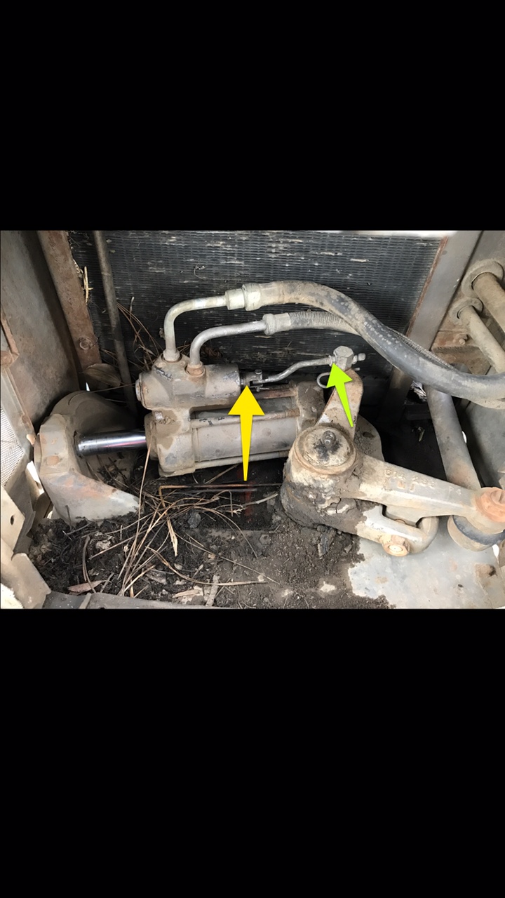

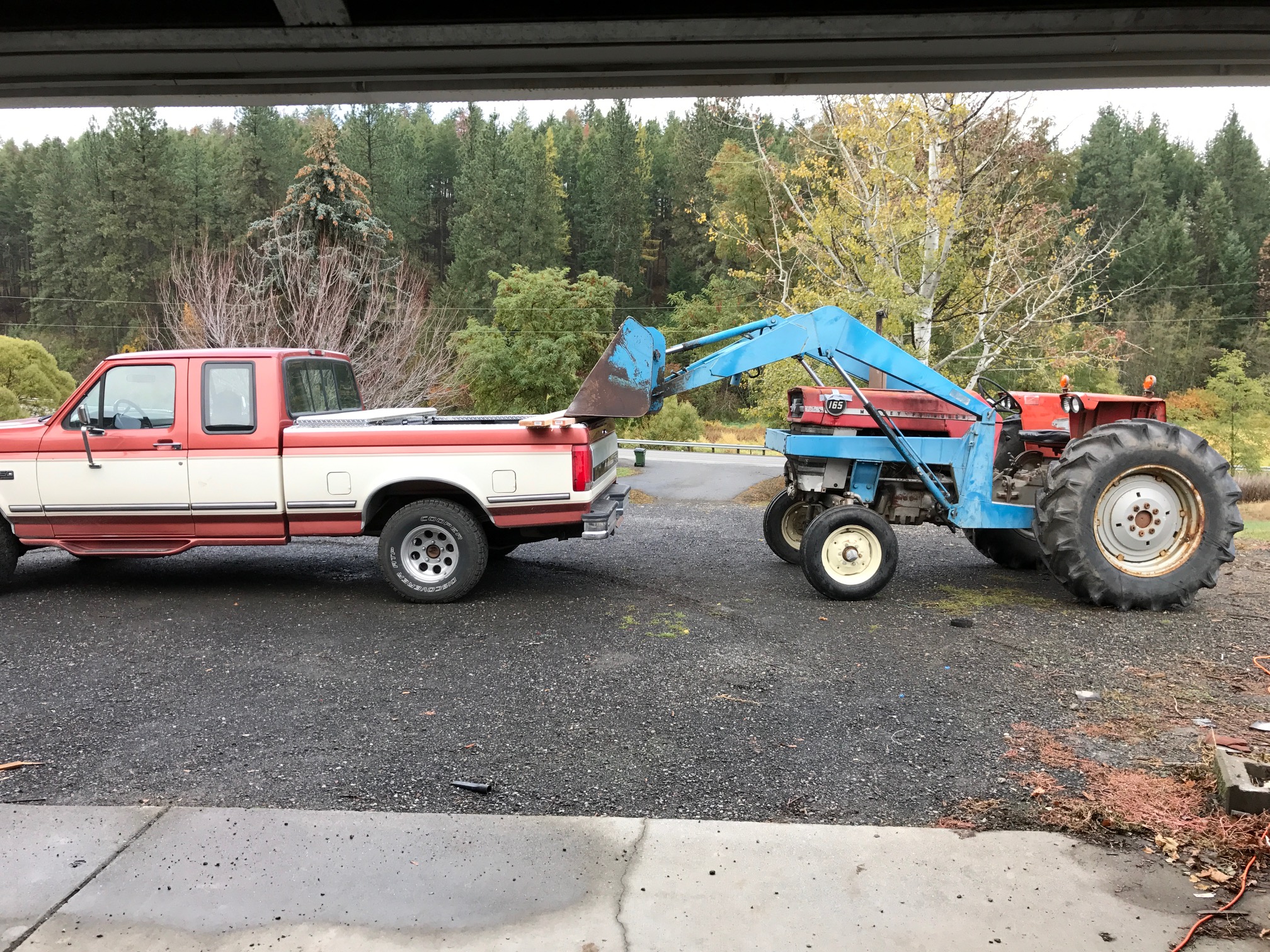

Had a little set back today, the power steering was working great. Was pushing some garbage down in the back of my truck with the loader and the power steering quit. I fussed with the adjustment a bit and got it to work a little,mostly left. Let it cool off and it works great. The fluid is dark brown to black so I am thinking I will change it out. Probably power steering fluid?
   / MF 165 brakes and power steering
#12
I pumped out as much fluid as I could through the fill hole and refilled with ATF. I drove it around a bit and then pulled the reservoir housing, cleaned it out, sprayed off the screen and reassembled with more fresh ATF. Much better now, will probably drain and fill one more time to help get all the old fluid out.
   / MF 165 brakes and power steering #13
Sounds more like your going to have to pull the cylinder assy off and take the control apart clean it out and replace the O- rings inside the control valve. Just by spraying it down at the begining was just a short term solution.

G'day from Australia! :) Looks like you've scored a nice well-kept tractor - just a couple small issues to sort out, not bad for a machine of its age. I especially like how you have quad work-lights built into the fenders - that's given me a great idea! :laughing:
The only help I can give you on the power steering is that there may be a filter, or a screen in the oil reservoir, which becomes blocked after the tractor is used for some time, stopping oil supply to the pump - might be worth investigating. ATF is indeed the correct oil for it.

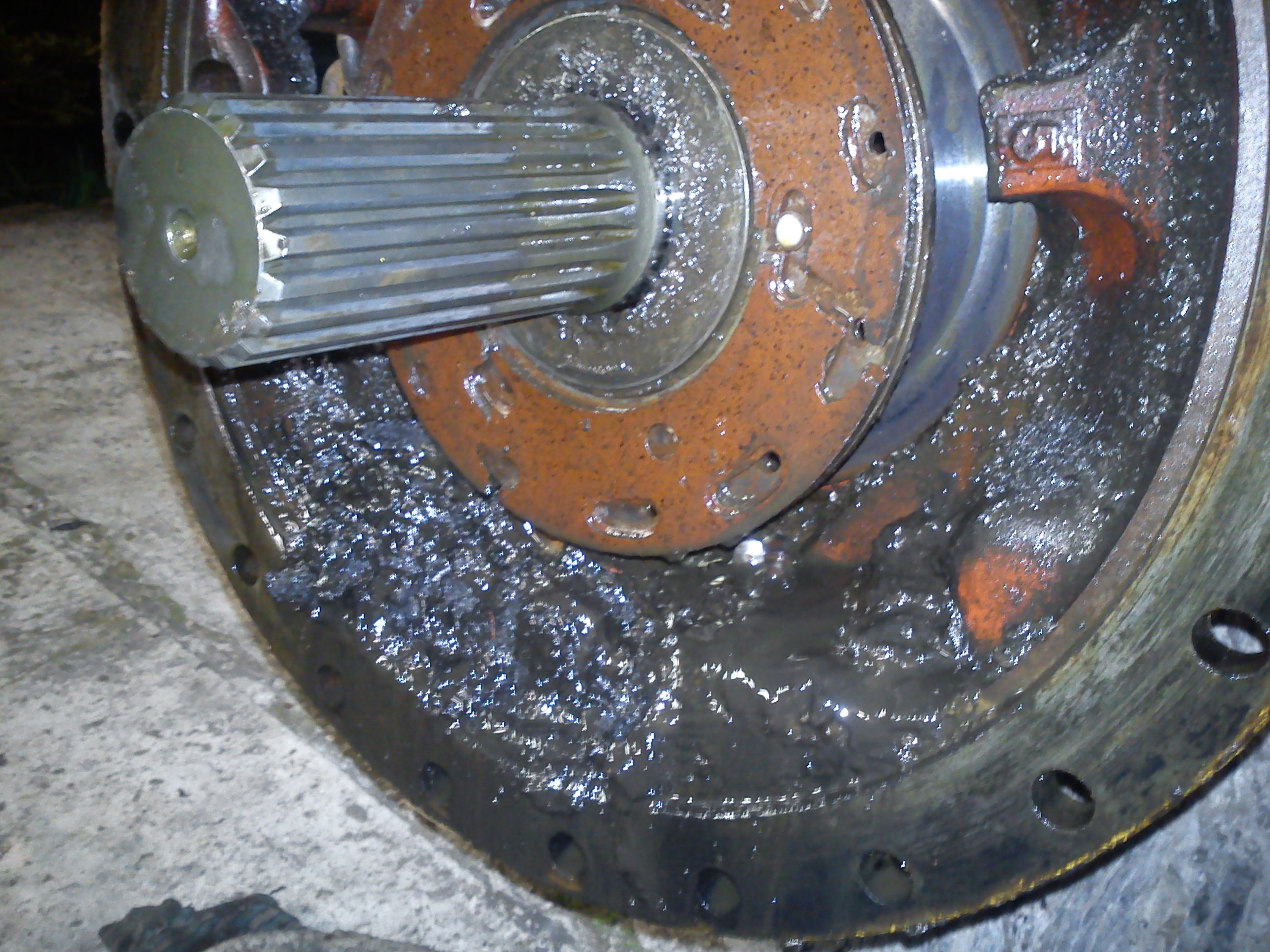

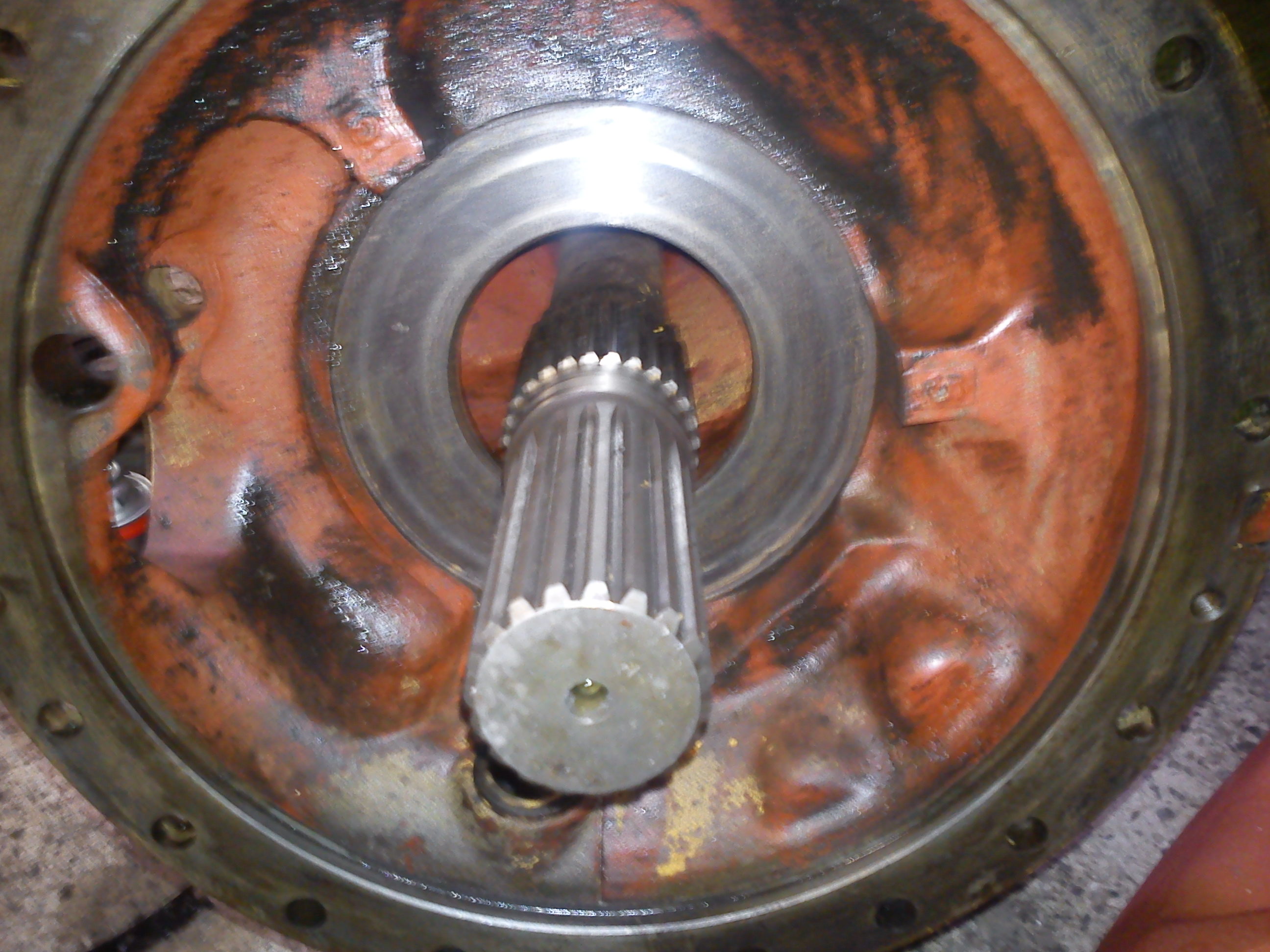

Regarding brakes - I think yours has the same brakes as my MF40 - dry disc inboard brakes; also has hub reduction drive boxes. The correct way to adjust these brakes is to wind up the self-locking nut on the front of each axle housing until you get a good pedal, but not to the point of the brake dragging. Remember, you will need to slacken off the pull-rods to allow the internal mechanism to return to its rest position. They are mechanically-applied self-energising twin-disc brakes - very good when they're working, but they must be dry and rely on three seals to not be leaking oil into their chamber. I had to dismantle one side of my 40 and renew brake discs and the three seals - until then I had a good pedal height but no friction! :laughing: The hubs have their own oil - check them and refill if required - don't run them dry.

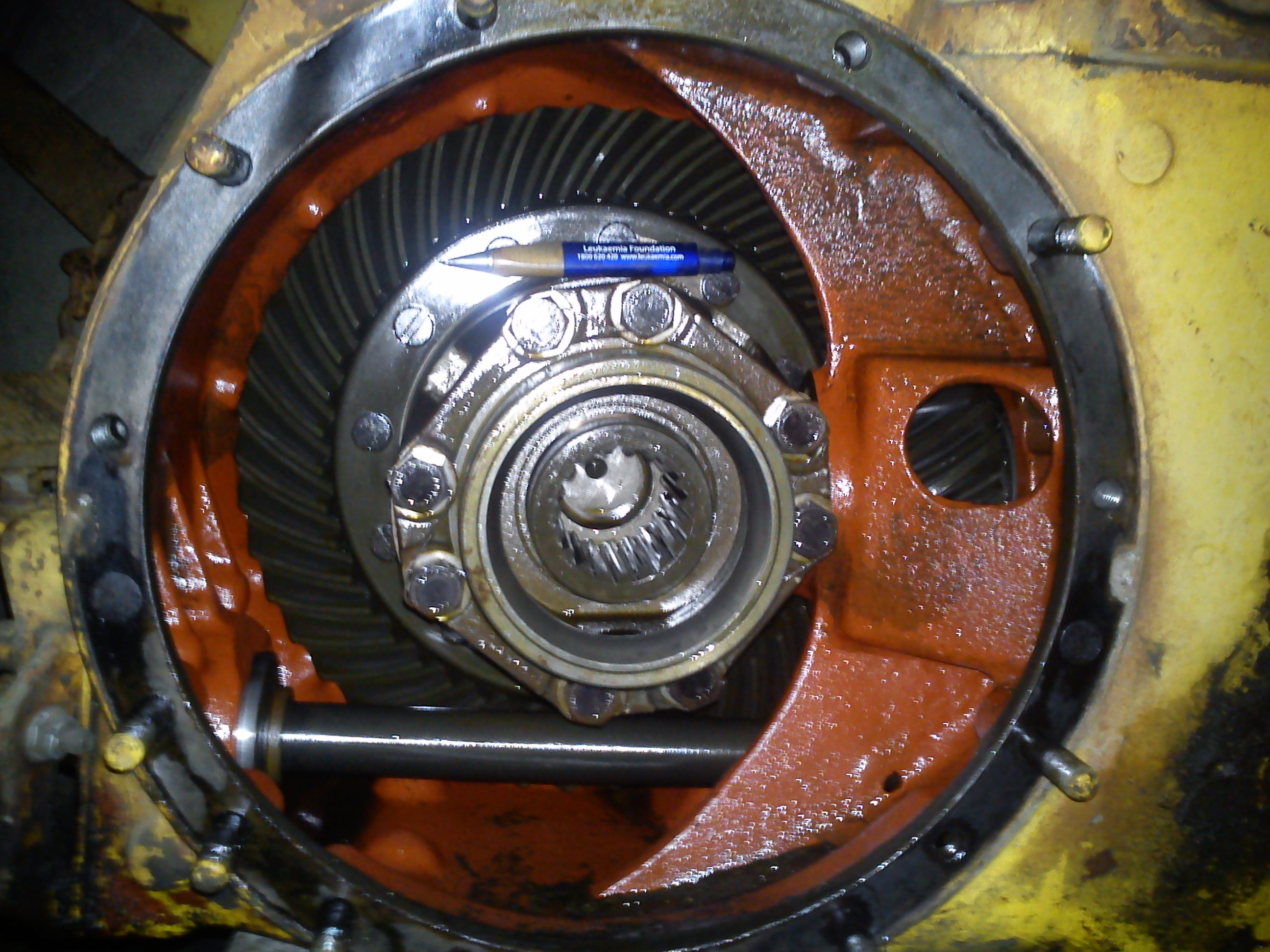

Doesn't seem to want me to edit my previous post, but here's a few pics I found of the brake I referred to - before, during & after:
The last is a pic of the huge rear gears and PTO drive shaft - utterly bullet-proof. You can only wear them out after around 50 years! :D
