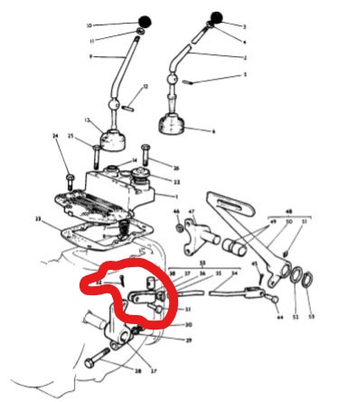

Hello everyone, a few days ago I bought a mf 188 (1979 not multi power) when i m trying to engage the PTO (tractor stopped)
A) whith PTO shaft , it is difficult to engage the PTO (hard noise)
B) without the pto shaft it is engage very easy,
C) if i select pto on rear axels it is engage very easy, but i want it to take power from the engine .
D) With the engine off it is ok, engage and work (it seems that the cluch does not stops the pto)
1st time MF owner my other tractor is FIAT 880-5
Thanks in advance for the answers

Hi and Welcome. You have a very capable tractor - the type I wanted when I was a boy .... and these 100-series models were new!
A couple things to check :
Are you sure the clutch is pressed all the way to the footrest, so the second stage is released? This is what allows PTO engagement.
Otherwise the clutch linkage - quite easy - or the second stage release - quite an involved job - needs adjustment.
Good luck!

Thanks for kind answer but from many tries only once i ve made to engage without any noise. the strange is that when there is nothing on 3points attached and its free then the PTO engages very easy and nice . then whith the pto shaft on and a sprayer cant lock it. I ve already change the bold nr 30 (on foto) and the clutch came very high but nothing happens . maybe i was very nervus , i ll try tomorrow again .Sorry for my ENG and Inkedclu_LI.jpg Thanks for your reply!!

Do you have the right free play on the pedal?

The free play is how many cm the pedal goes down with no recistance.
