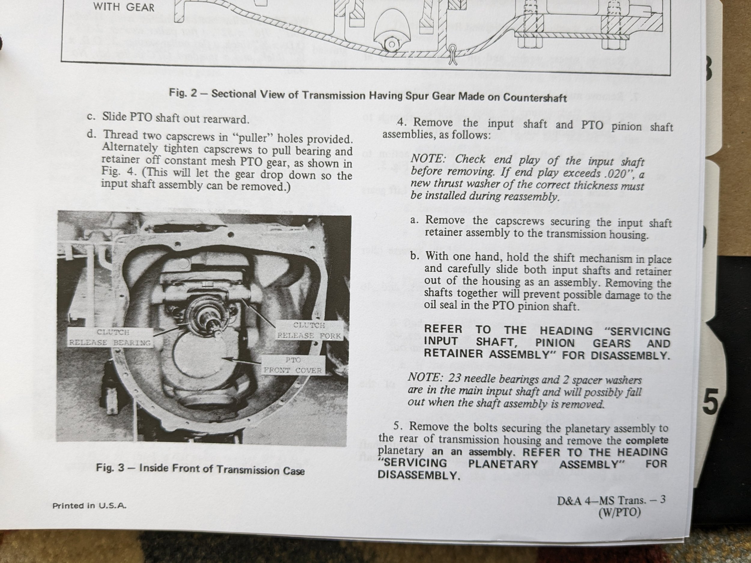

I checked my shop manual, and I have to pull the side cover to remove the roller before the top can come off. Im still a little ways away from that (shop has no heat, dont use the tractor much in the winter), so will probably spend some time doing my homework this winter and tackle it when it starts getting a little less chilly....
